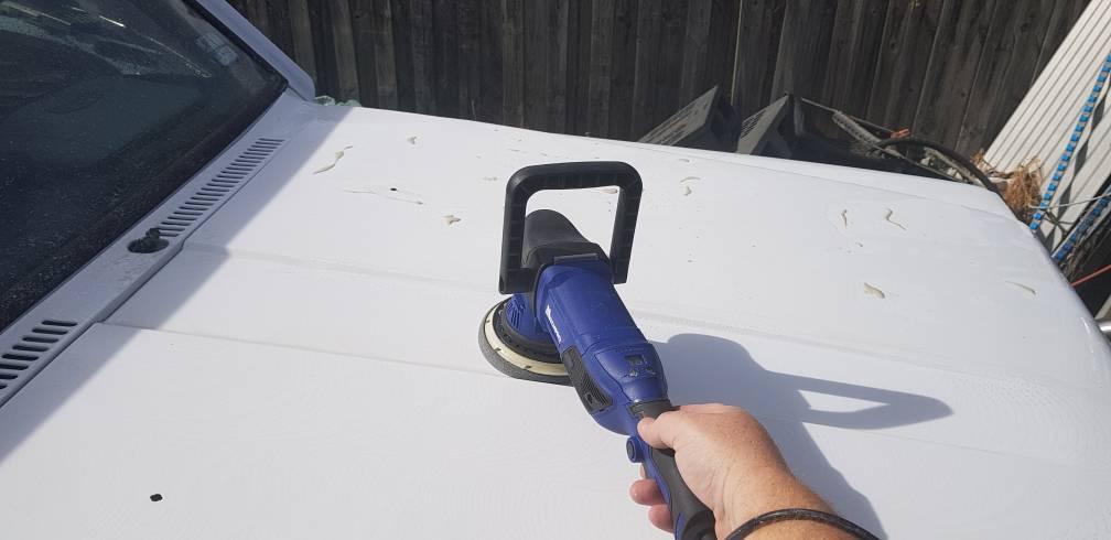

Gluten for punishment. I thought bugger it. Now is the time. Hit the car with the random orbital with some 500grit paper and flattened off some of the peel.
Got the electric buffer out to give it some love ans the bloody thing was dead! Damn it. Headed into Repco and lucky for me they had the new model random orbital polisher at 50% off!! Yeah me.

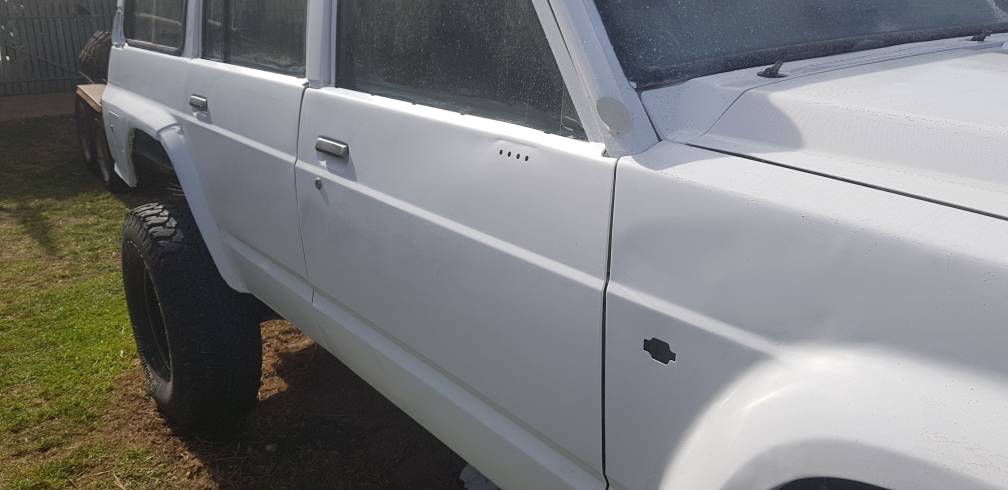

Spent half of yesterday and best part of today cutting. Cutting. Cutting. Hard cut x 2. Medium cut then fine cut then swirl cut the polish.
Looks pretty good. Didnt get high gloss, more a satin finish as i would have needed to hit it with 2000 grit on the sander first and i couldnt be shagged. Should of but didnt.

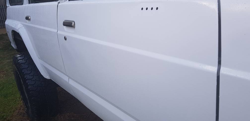

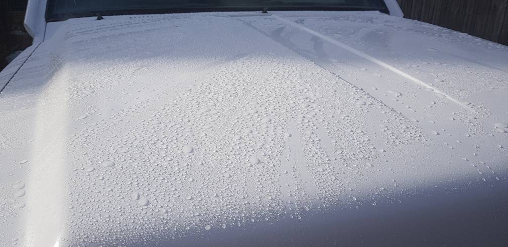

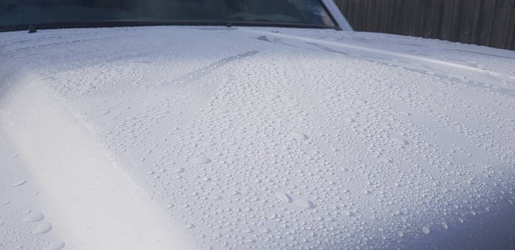

Pretty stoked with the final result.
