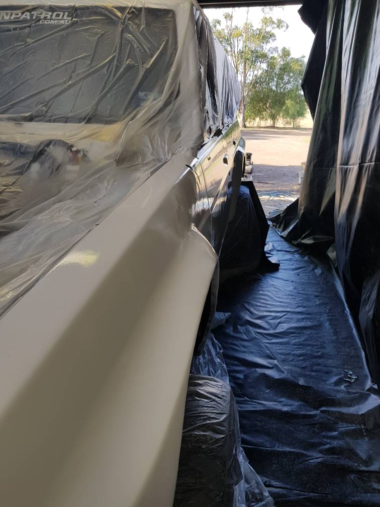

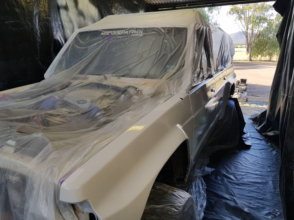

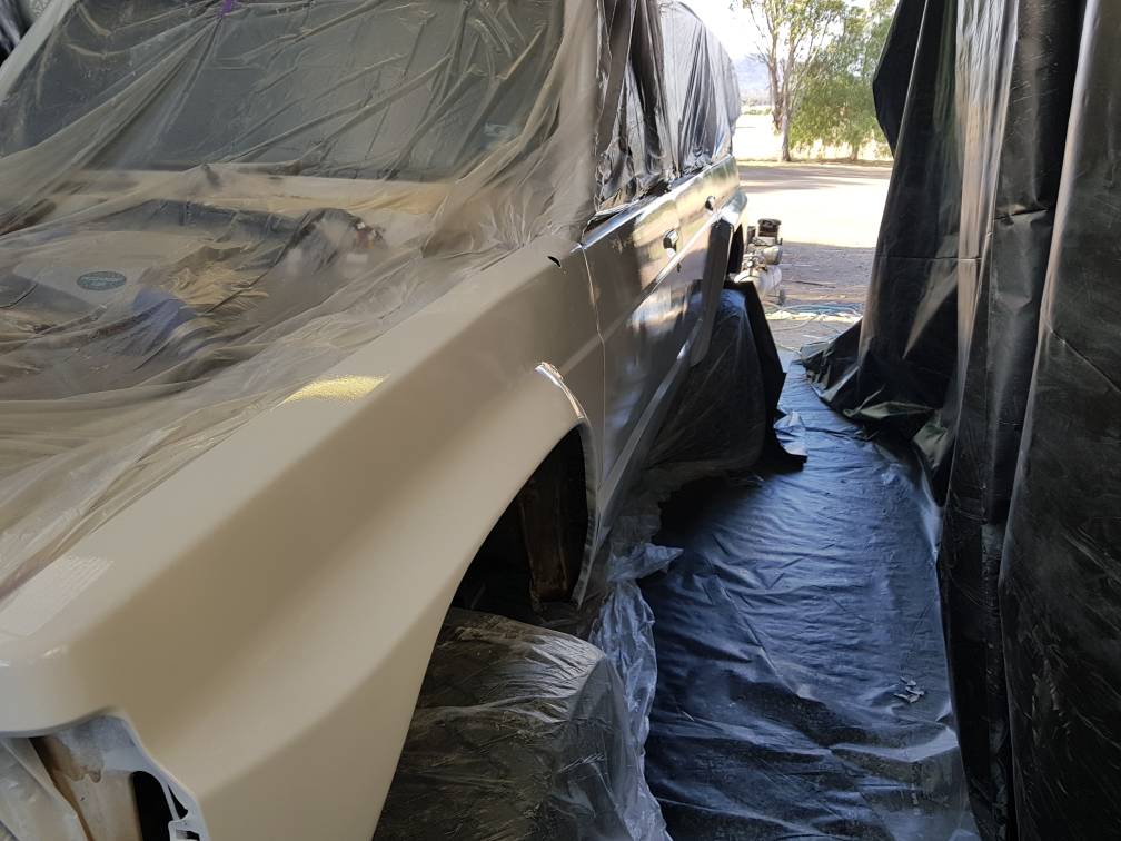

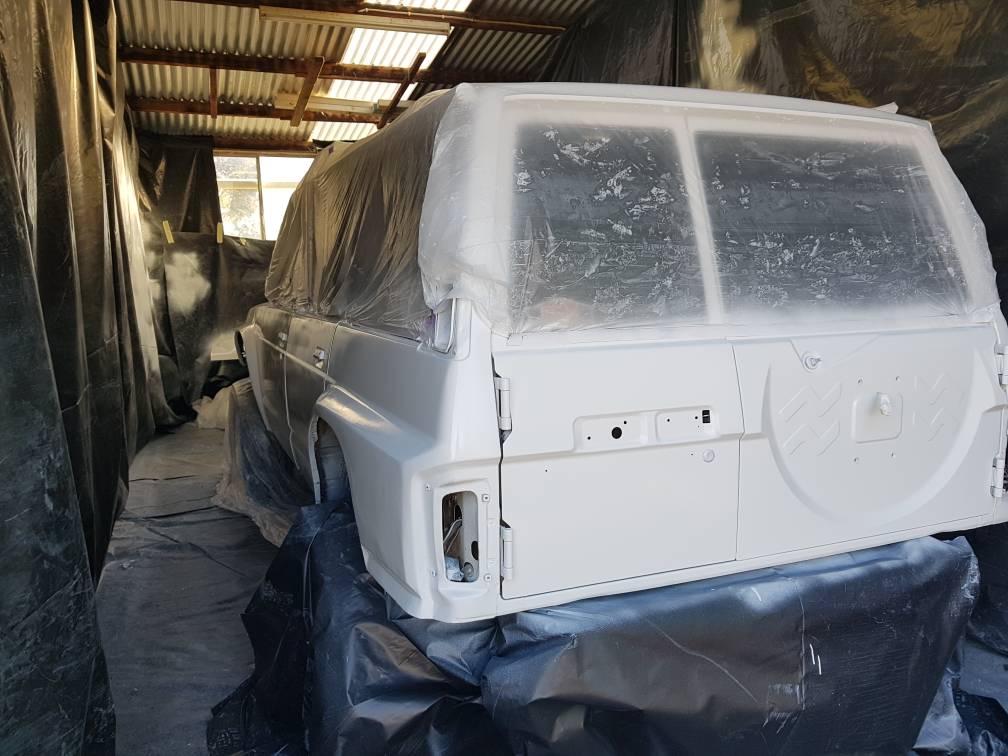

So i thought bugger it. I draped 2 drop sheets over the roof and down the windows and taped along the bottom of the windows. Happy with the pillars. Didnt take long to sort that out.
http://www.nissanpatrol.com.au/forum...018/04/188.jpg

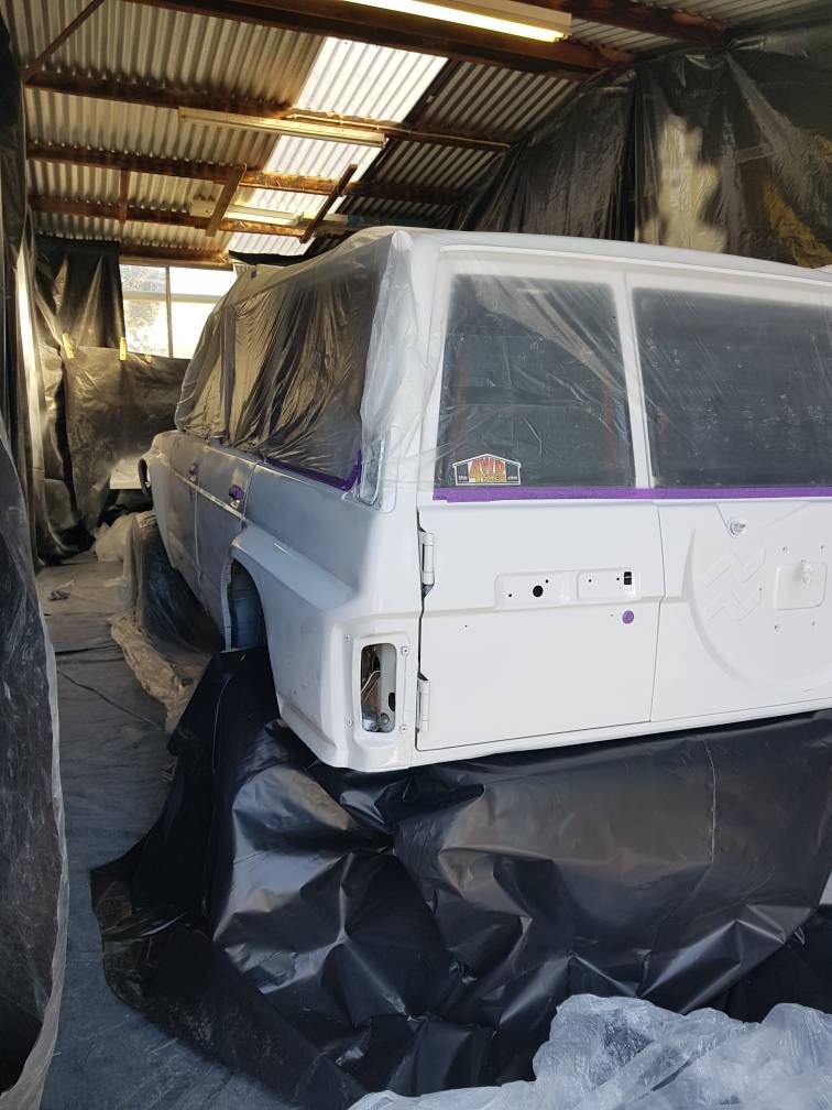

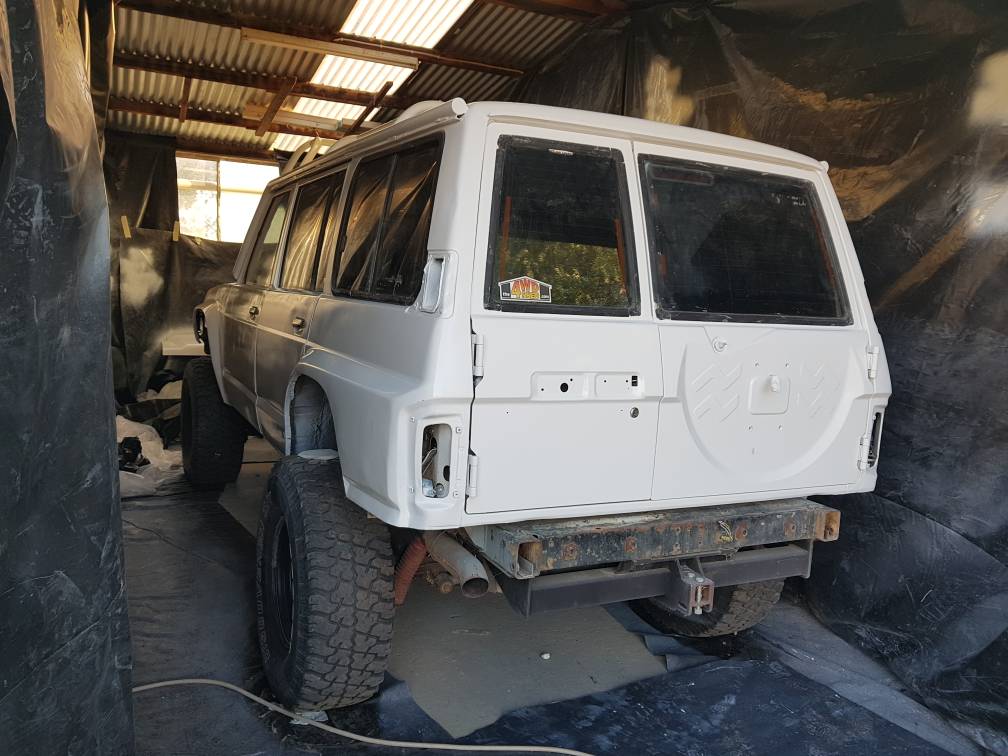

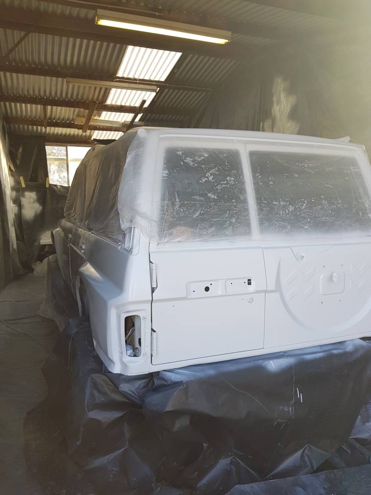

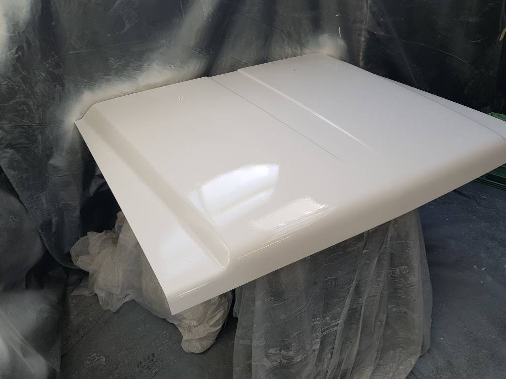

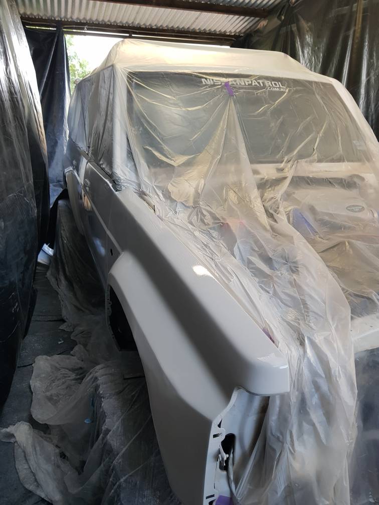

I hit the panels with the random orbital and 320 grit and flattened off the paint which also didnt take to long then started again.

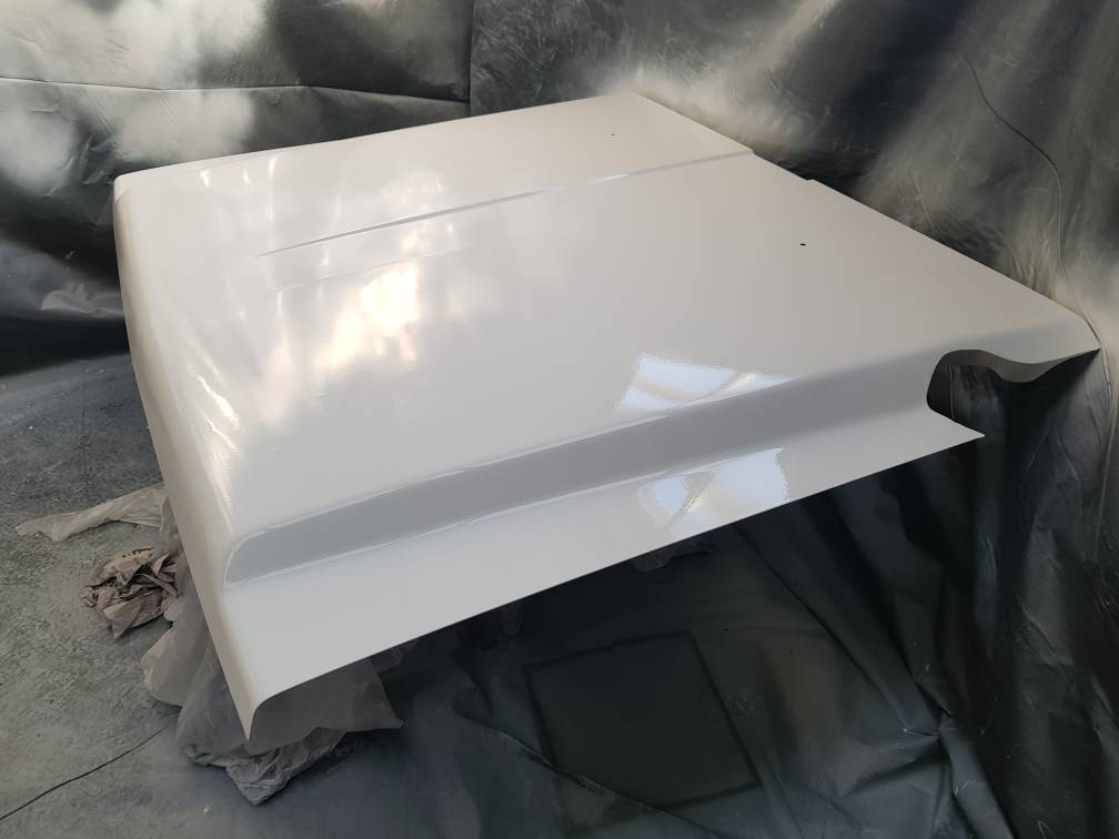

I used a bit more thinner and tuned the gun a little better. I flash coat and 2 heavy coats. Weather was perfect to paint.

Still a bit of peel but i cam live with it. Might rub and cut if it shits me too much when its got all the bar work on.
