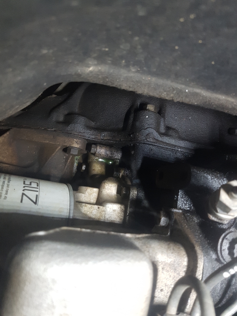

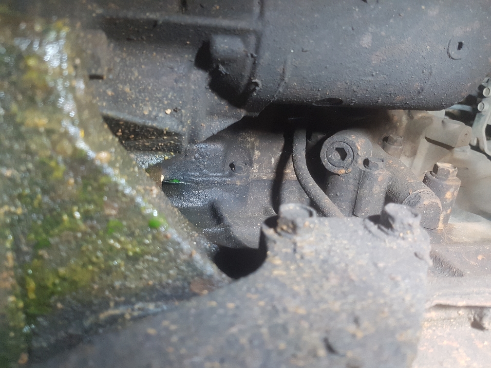

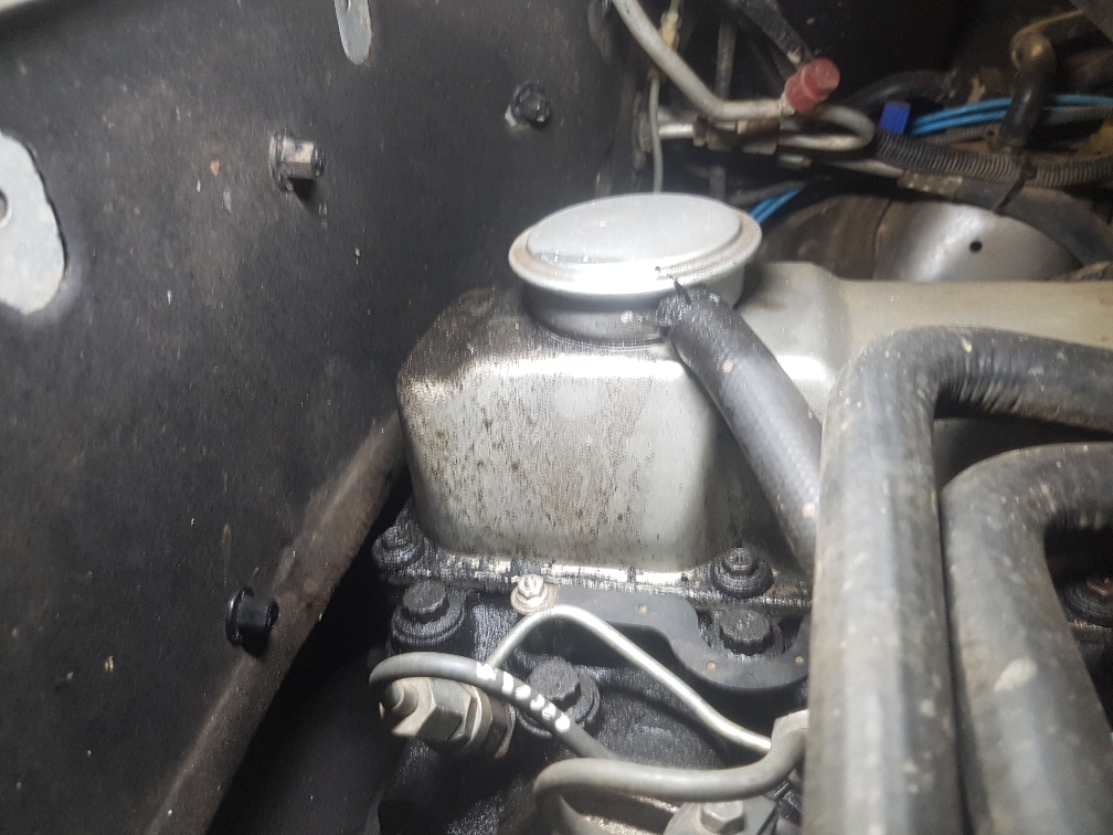

Rolling around under the GQ sussing out the exhaust with potential to reroute and hug the chassis with plans of a custom stainless water tank on LHS of shaft. . . Anyways spotted a coolant leak coming from oil filter / oil cooler area. . Will need to get onto this, is this most likely simply gasket or something more complex / sinister. Not sure whether to tackle myself or take into shop pretty busy ATM as always lol. . Also need to get into oil leak from breather that is making a mess everywhere. .

Get onto a shop and beg ASAP if too busy yourself Rossco Mate!
Incredible how long lead times appear to be over the last few months since lockdown release on all things mechanical & off-road etc...
Can we find some quick time this weekend to hills pressure test the coolant system for starters squirts maybe?
The oil cooler is pretty easy to do, I did mine when it was out of the car but it's just a couple of o rings and a few gaskets inside it.
Would be much trickier in the car though. That one leaking would just be the large external gasket.
https://patrolapart.com.au/product/g...ler-gasket-set
@MissusWinnie, can Chrisso come and please help Rossco this weekend, your blokes got skills & experience [emoji120][emoji23]
EDIT: Just confirming, the hills are an alcohol free vegan environment rest assured [emoji106][emoji106]

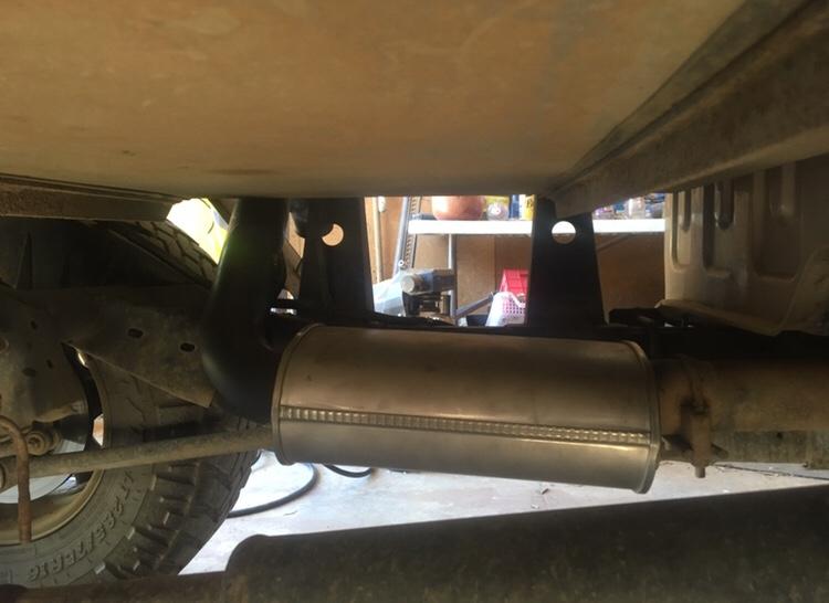

Cheers gents, sweet at least nothing to nasty by the looks of it, might do a Patrolapart trip soon, already have a bit of a list lol. . She's booked into Lilydale mufflers & towbars on Friday see how we go with the exhaust its currently finishing at the diff which isn't ideal so will be good to get that sorted and hopefully leave a good spot for water tank [emoji106]
Top choice Rossco, he’s our valley favourite for all things muffler/towbar big & small too [emoji106][emoji106]
GQ Gramps scored a quick cheap new muffler and redirection only 2 weeks ago from old mate as well before suspension/arms work forthcoming.
