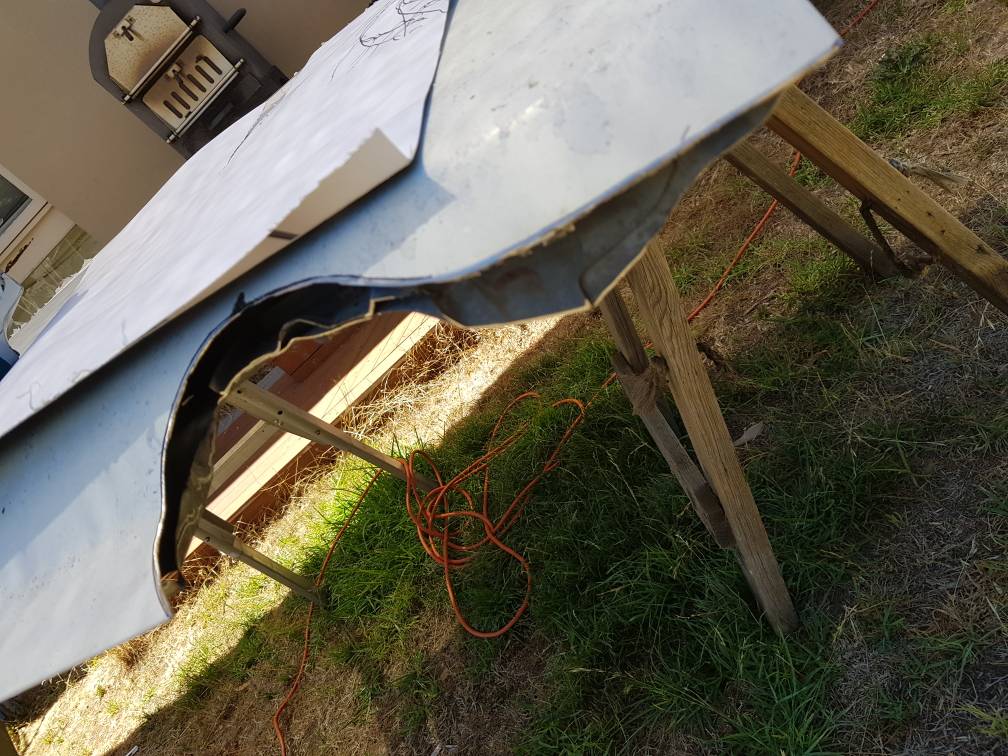

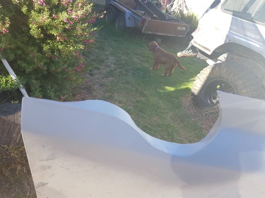

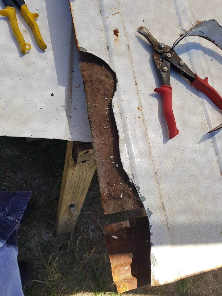

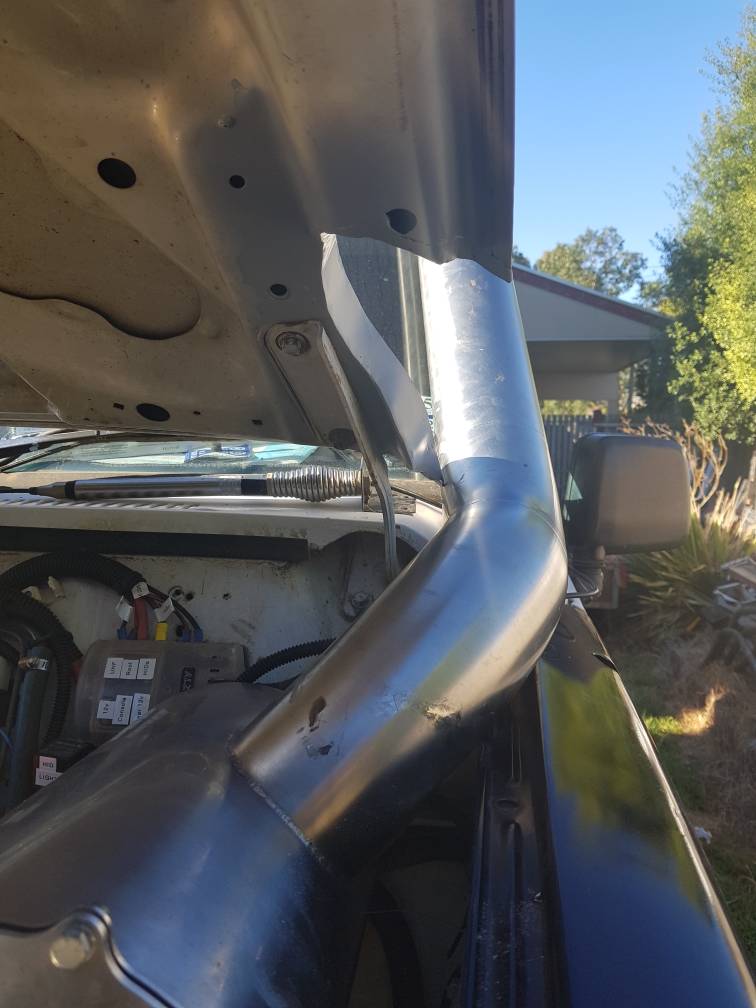

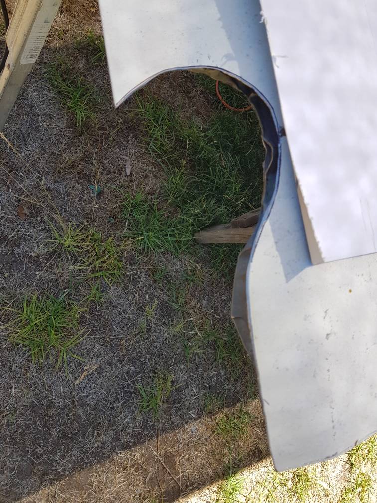

I scored another Bonnet with the snorkel which was already cut for the through bonnet snork but as is often the case the guy have just hacked out the hole with his teeth and left it exposed with rough edges. It was never going on my car like That!!!!
So off with the bonnet today and I cleaned it up

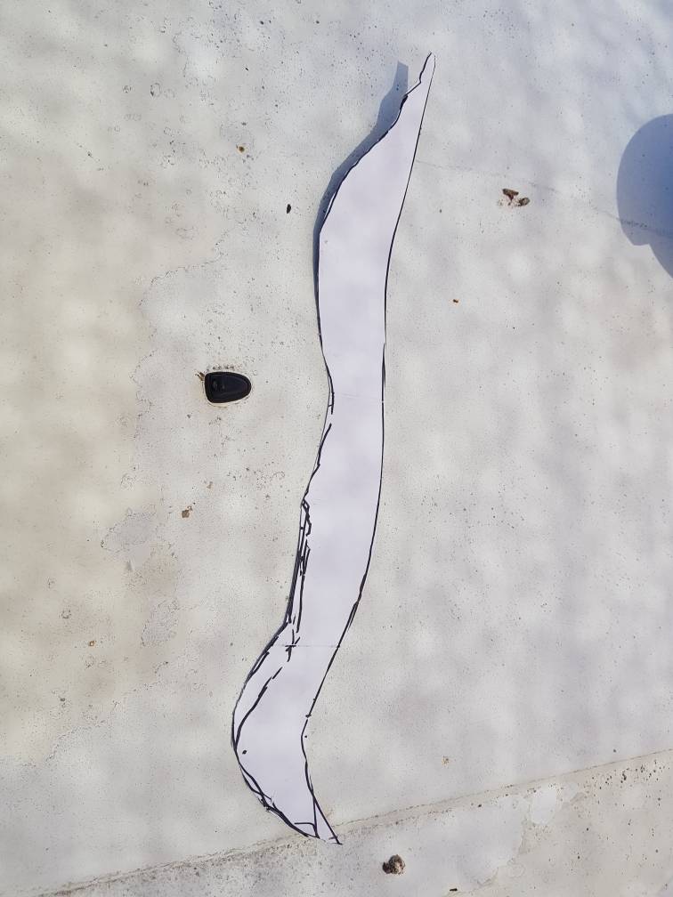

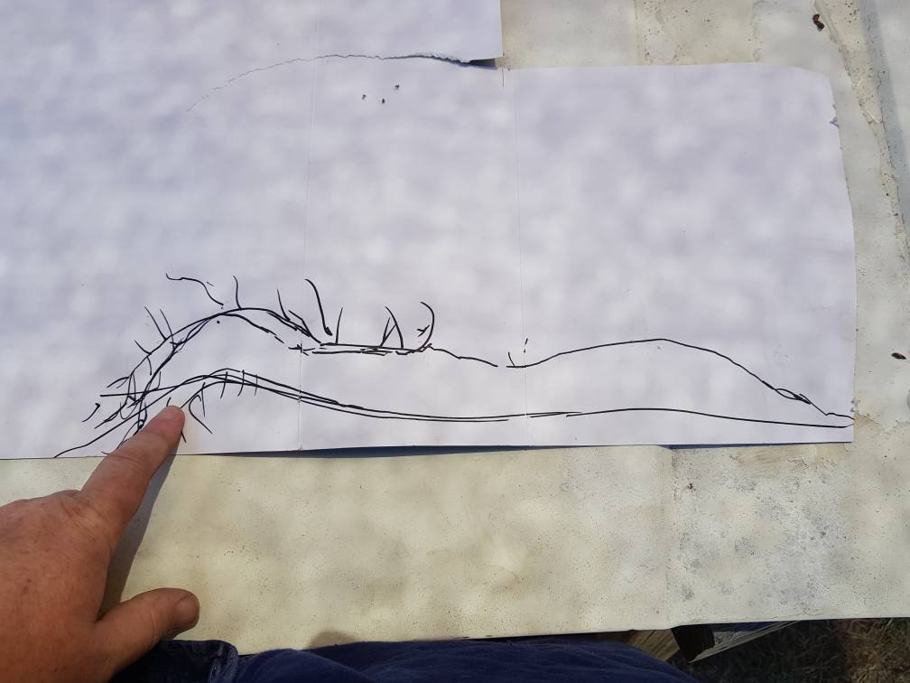

Used some cardboard and shaped it into the cut and marked put a template.

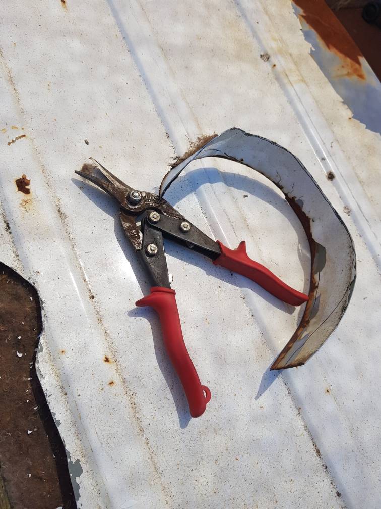

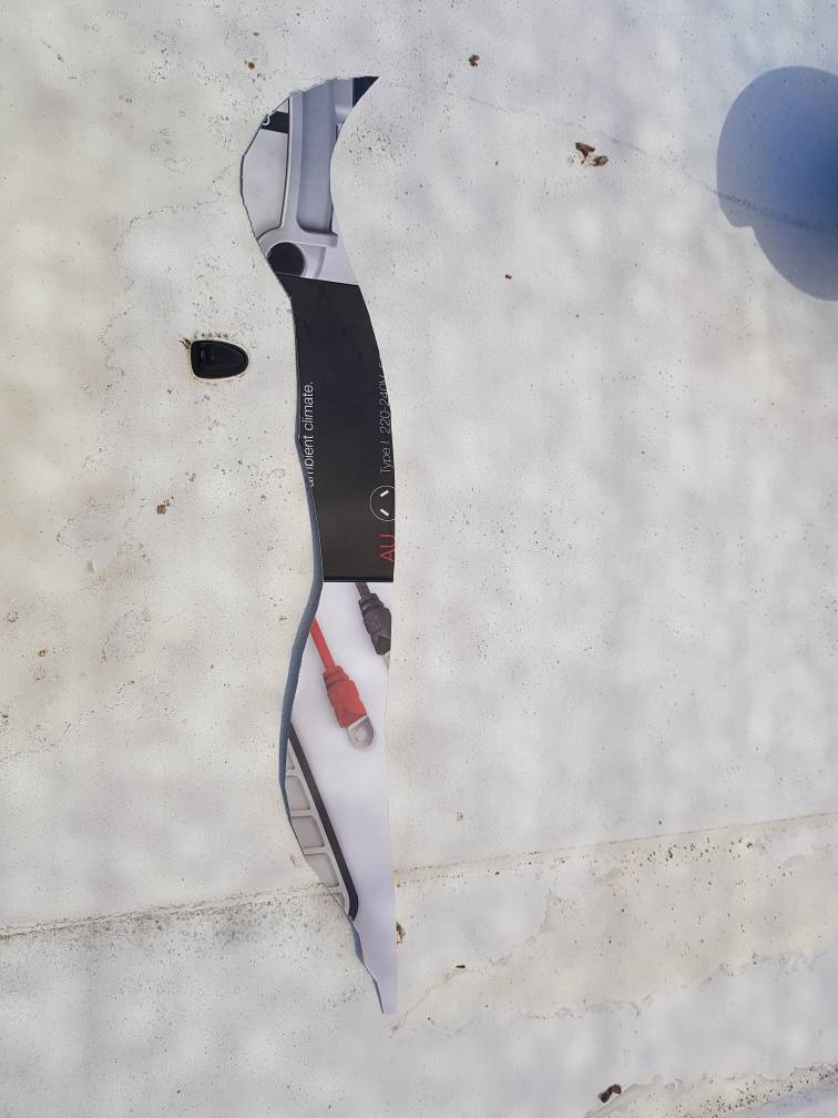

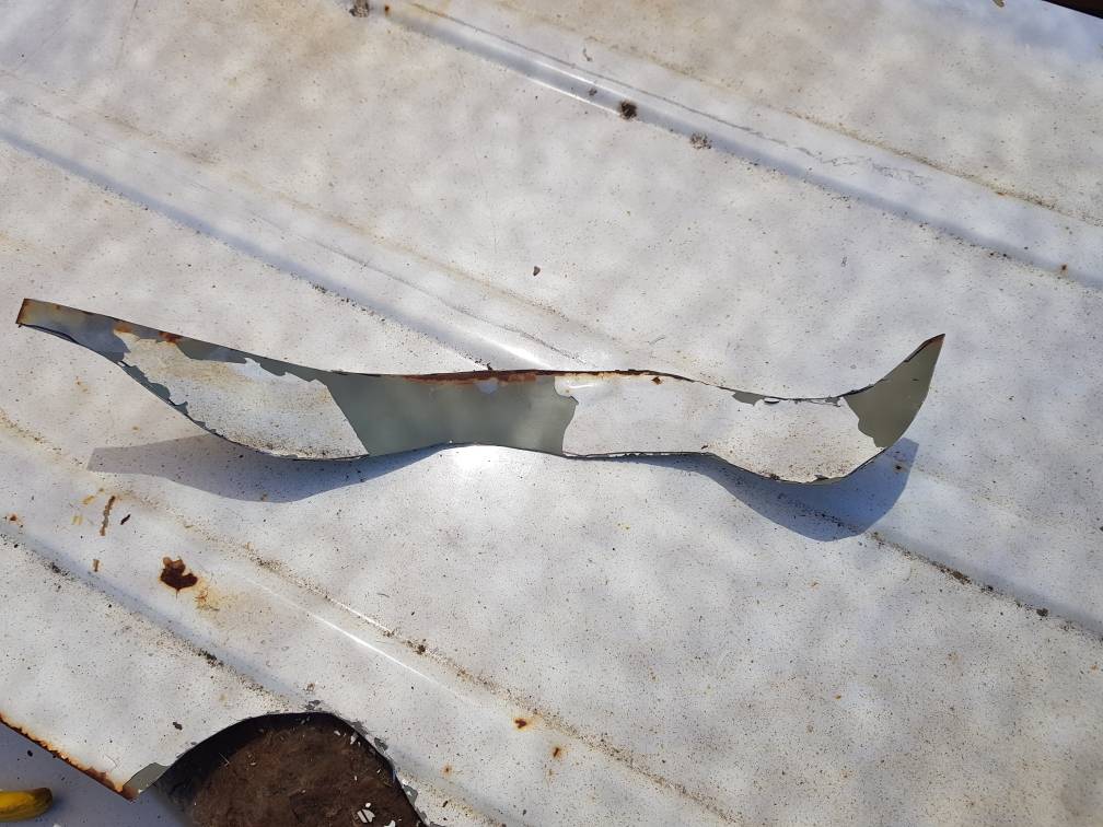

Used that to trace out on an old piece of roof cut I have here and poached some panel out of it.

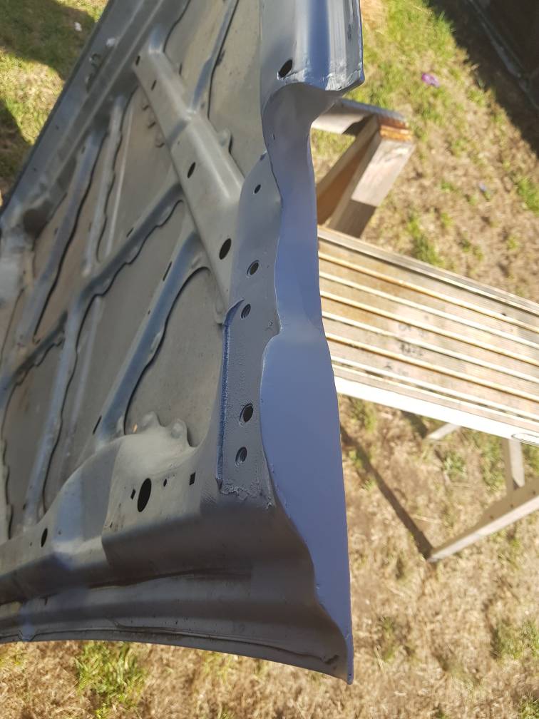

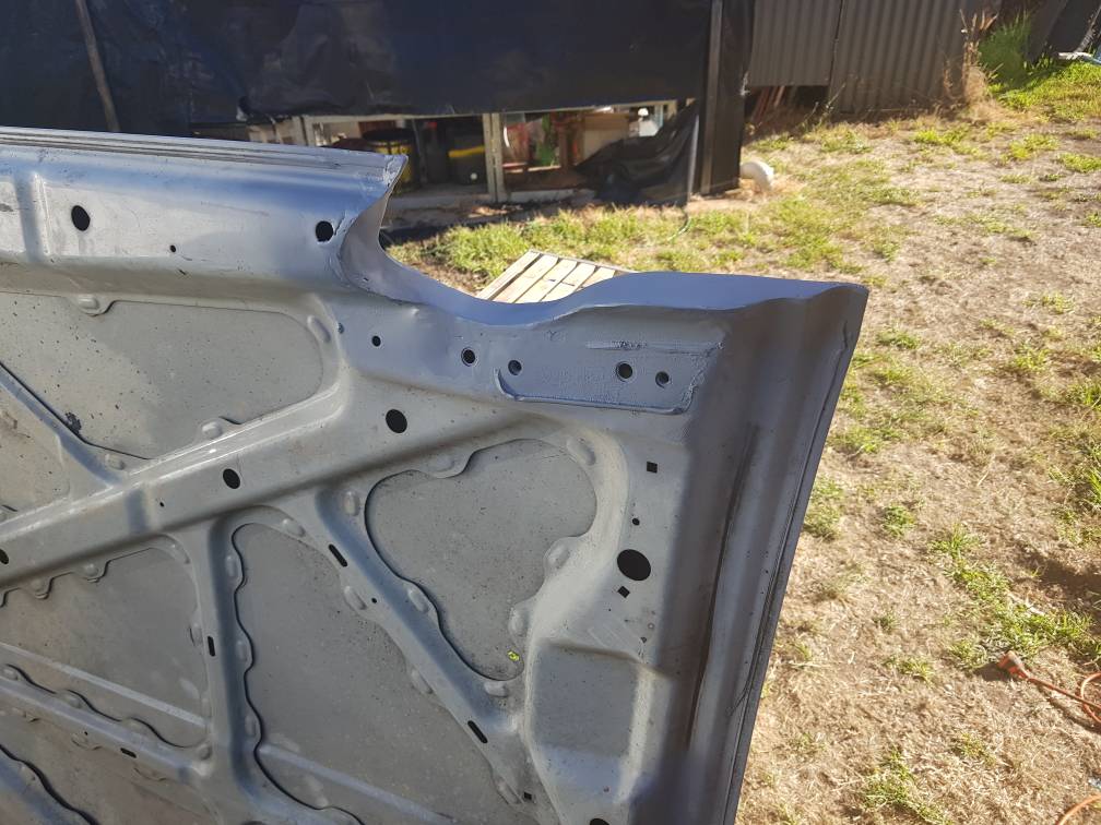

I got the mig out and tack welded. Played around with the welding settings alot which was great to tune it in for Panel steel. NO I took no pics of welds [emoji14]

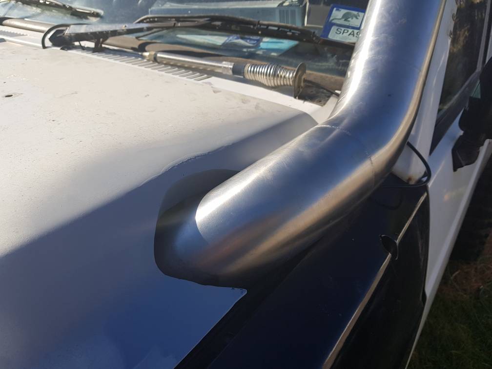

Looks pretty good. I ground it nice and neat. I sprayed it with a primer and can see I need t9 touch up a couple of sections of weld that I ground out. There ain't much steel there!!
Looks heaps better

have you got one of them new arials that pick up the radio(wireless) through the windscreen....and ya fenders dirty..make it white again
Darren, you are very clever dude, hats off to ya! Well beyond my skillset and certainly beyond my fear of F***UP threshold. Need to get a 240V mig tho as even with my super arc welder, this thin stuff is beyond me.
Nah I have one of those short rubber aerials from Super Cheap. I would not run anything else. It takes a beating in the bush. Yeah I scored another passenger front quarter off a guy without the snorkel hole. I am going to repaint the car in the next few weeks as all quarter panels are damaged and have been repaired. Need a paint.

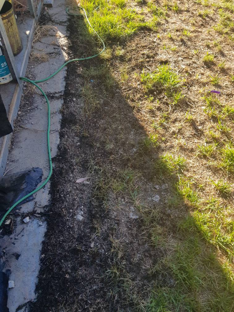

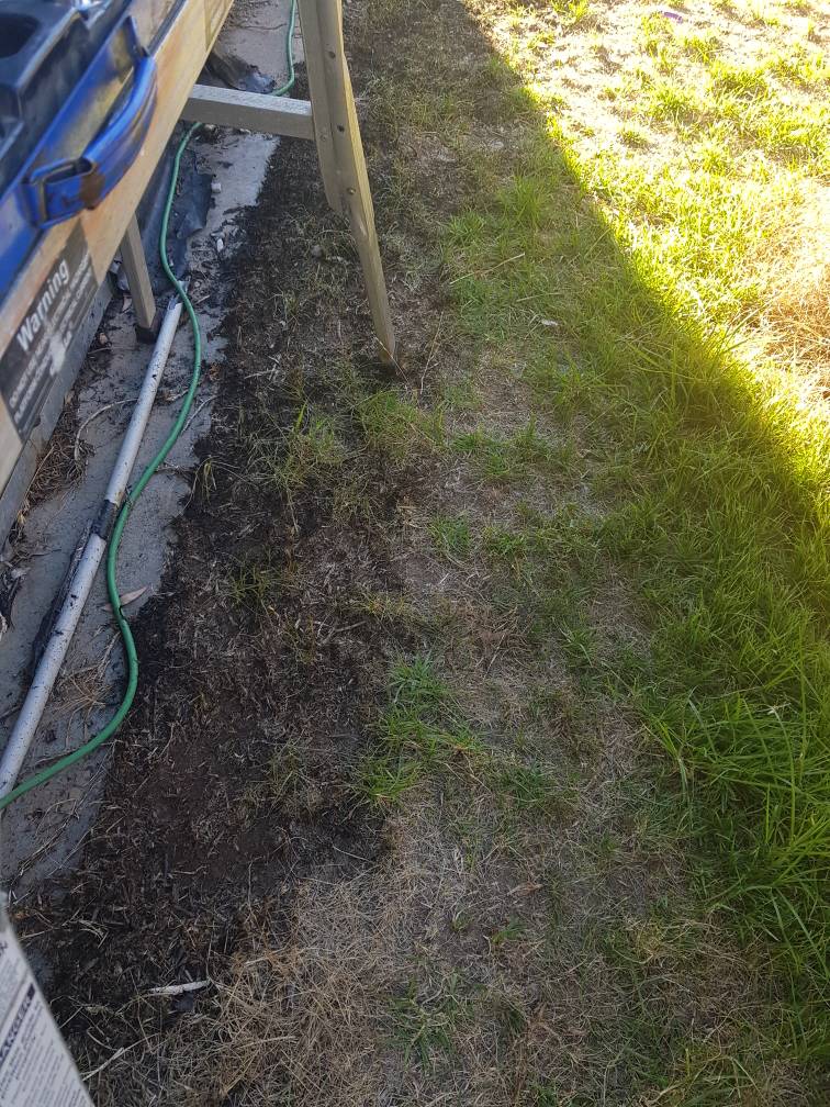

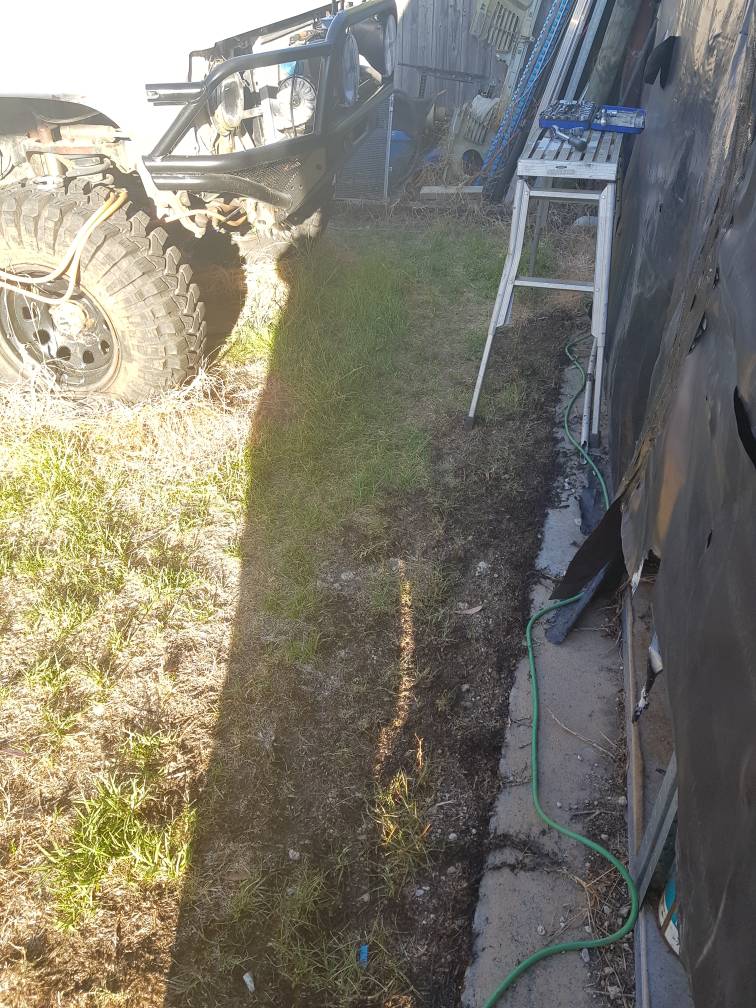

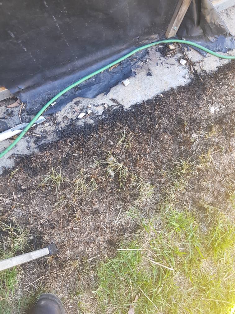

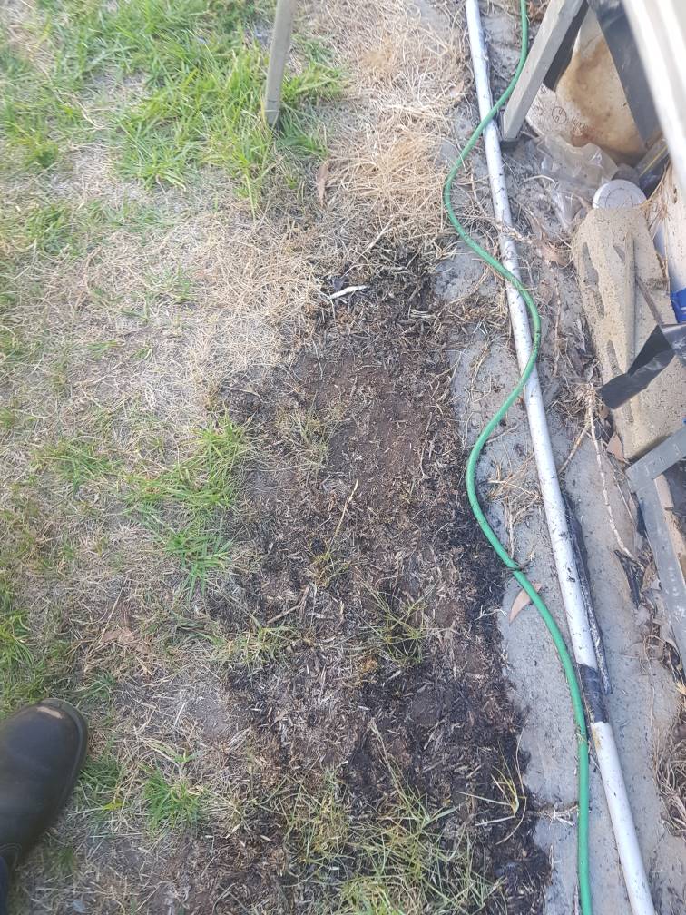

So while I'm.busy head down PPE on with safety glasses and ear plugs and hat grinding away at my bonnet today I heard a noise and looked around to see.my mad wife running at me with the garden hose she had been using to full the fish tank. I stopped grinding and said what are you bloody doing?? She just pointed as she ran passed me!!!!.
So as it goes, I'd been grinding away. Thought I smelt someone light up a tobacco pipe which was weird!!
Nup!! I lit the bloody backyard behind me!! Fortunately the grass is short and sparse.
Damn!! It had travelled across the front of the shed and was burning low between the shed and the GQ!!!
WTF!!

Crazy stuff. It was not that hot today. I certainly kept an eye on things for the rest of the day!!
that calls for a stop work meeting and a few beers i reckon
Bonnet looks smicko Daz when's it getting painted and what else to go ? ?
Nice bushfire could have done some backburning around the front tyres [emoji6]
Working in rain hail n fire to build the ultimate rig...sounds like a good story...on the bright side...wont have to edge the lawn for a bit...lol
