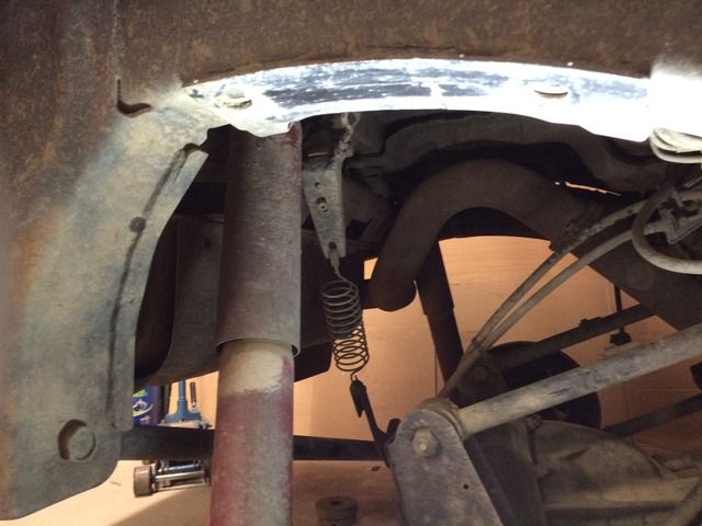

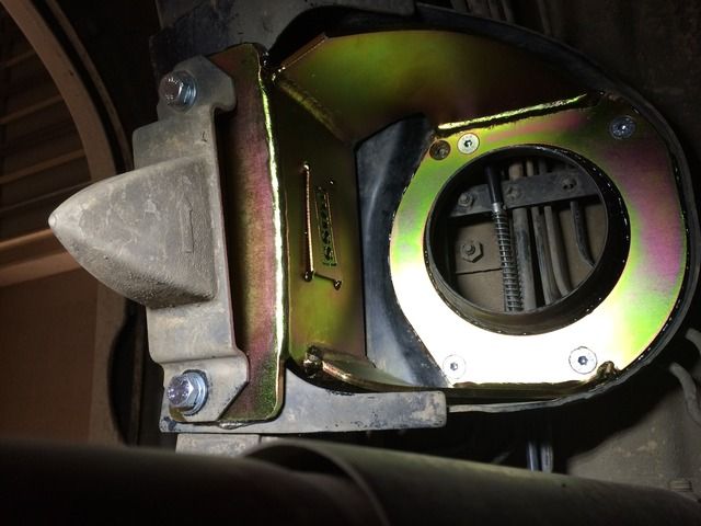

Few updates for the Rocket wagon. Starts off with some BOSS Chassis bracing
http://i1083.photobucket.com/albums/...pspewia34r.jpg
Means rear springs out
http://i1083.photobucket.com/albums/...psw4fcapcn.jpg
http://i1083.photobucket.com/albums/...pshfekba4i.jpg

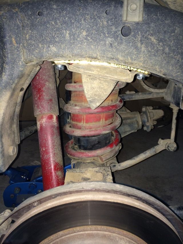

Also took the opportunity to fix up the airline going to the top of my airbags as it was all twisted and kinked.

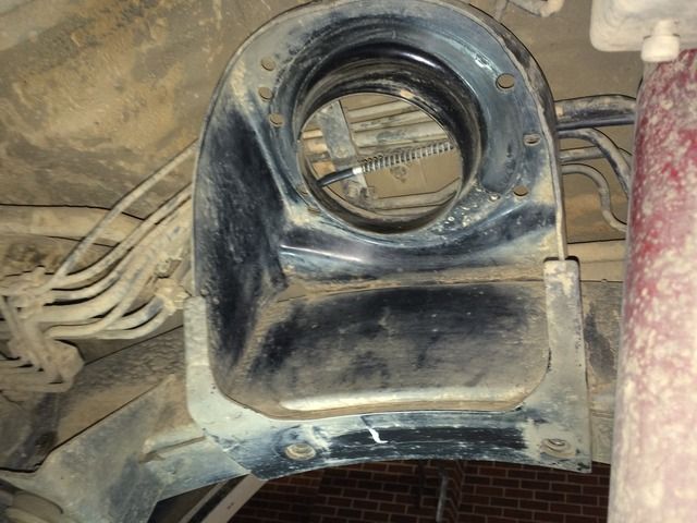

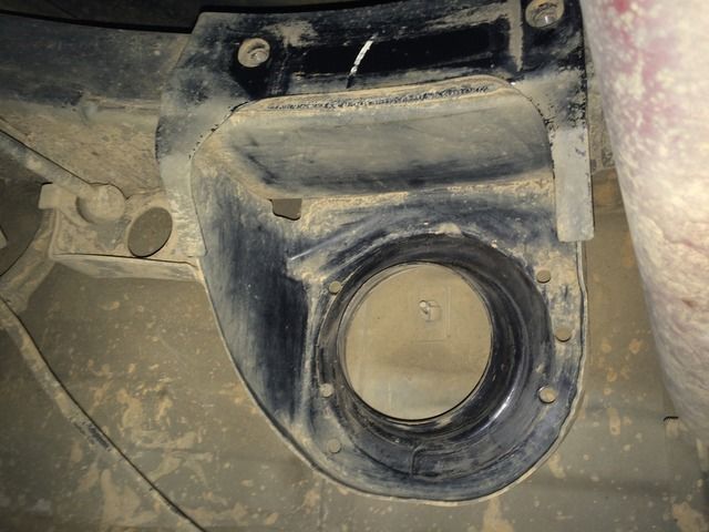

Removed the bump stops and cleaned up the spring hat. I was glad to see that it was all in good nick with no cracks or bends in it.
http://i1083.photobucket.com/albums/...pscgkuh9gv.jpg
http://i1083.photobucket.com/albums/...psak03j1sl.jpg

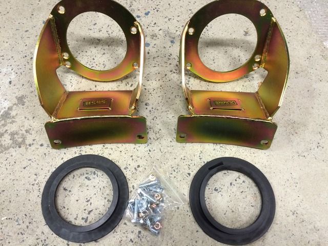

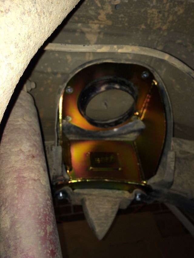

Cleaned them up, through some silastic in there to stop water and mud sitting between the chassis and the brace (as per the instructions) and bolted the braces in.
http://i1083.photobucket.com/albums/...psjl6djise.jpg
http://i1083.photobucket.com/albums/...psitgu30hk.jpg
The passenger side was a piece of cake. The drivers side was a pita with all the brake lines on top of the spring hat. At the same time I put some 2" blocks inside the spring under the airbag to allow for my suspension lift. Threw it all back together and you'd never know they were in there. :D
http://i1083.photobucket.com/albums/...pseyccowyw.jpg
Now I feel more confident everything will be OK when I hang my caravan off the back.

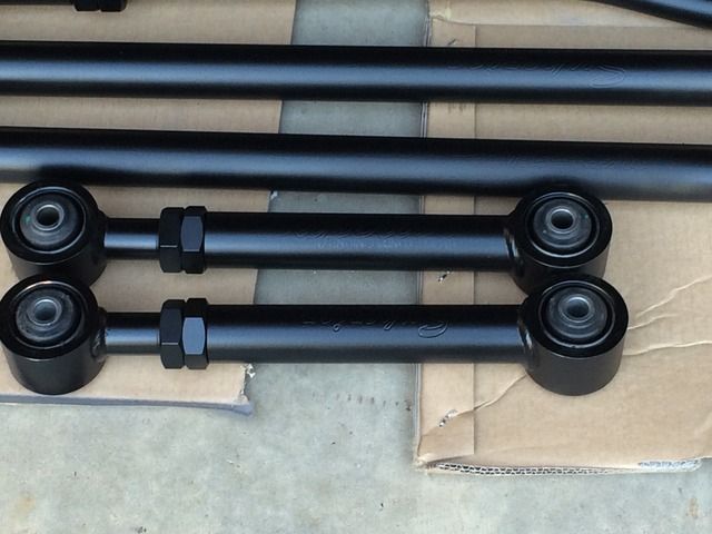

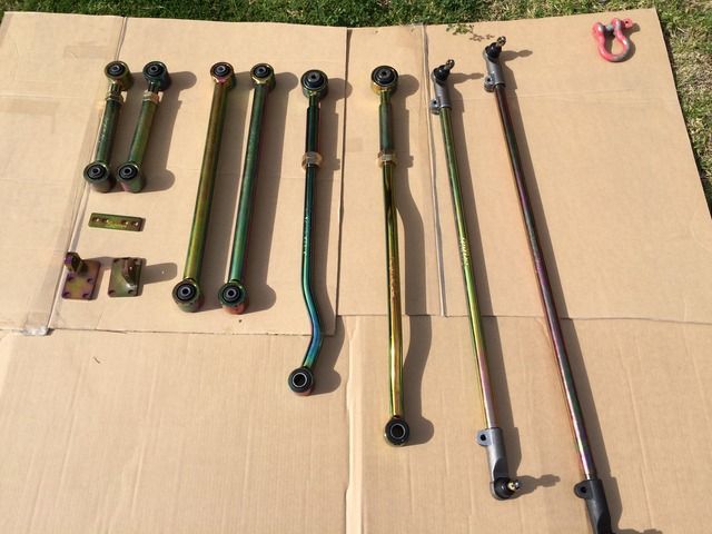

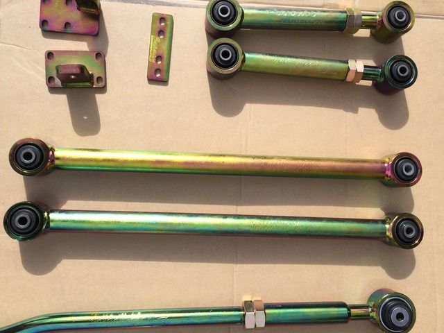

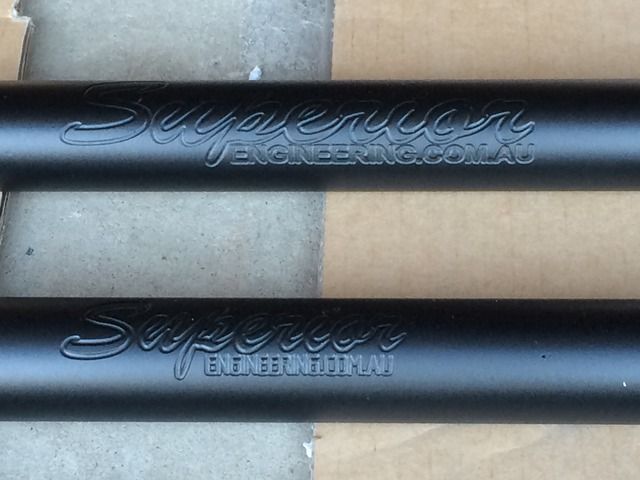

Some other bits and pieces turned up during the week also, pretty excited with these.
http://i1083.photobucket.com/albums/...psktlqgmvp.jpg
http://i1083.photobucket.com/albums/...psshnqdzxb.jpg

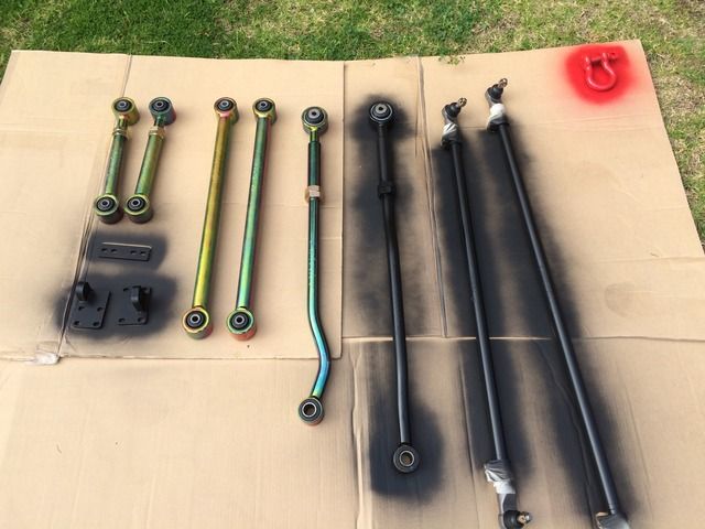

They are soo much bigger and stronger than the OEM stuff. Set about painting them to avoid any unnecessary attention.
http://i1083.photobucket.com/albums/...ps4bgvxwsi.jpg
Used the cap of the spray can as a guard to avoid painting the rubber bush, figured it couldn't be good for it.
Came up pretty good in the end.
http://i1083.photobucket.com/albums/...psqzgebply.jpg
http://i1083.photobucket.com/albums/...psv5qxjklk.jpg
http://i1083.photobucket.com/albums/...ps6ksetx5j.jpg
I'll probably start putting them in next weekend. Hopefully the paint will mostly stay there :? I used Rust Guard satin black. Time will tell I guess.

No, these are new mods. The chassis bracing is for towing the van. Once I put the rear bar on and got the spare off the rear door and stopped it rattling I could hear a heap of clunking and bang underneath, so it was time for some new bushes anyway, may as well get the arms to go with it. I'm also chasing a vibration in the drive line, so I'm hoping the adjustable uppers will fix that.
