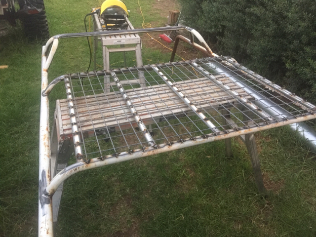

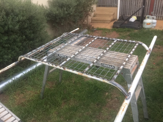

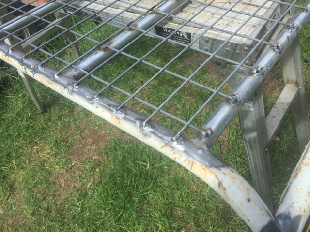

Well dragged out the mesh today past the wasp nest. Cleaned up the Gasless welds and cut and welded the mesh.

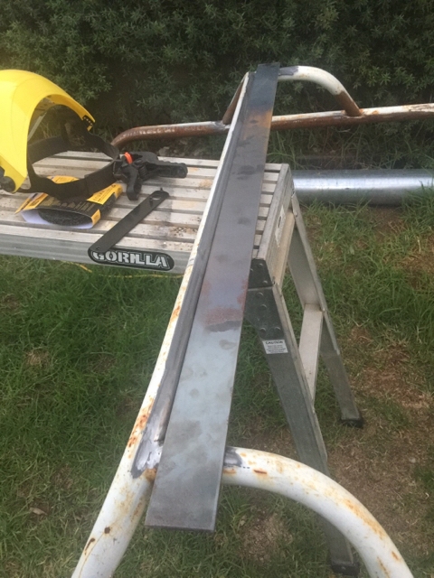

Bought some plate steel to weld on to mount and protect the light bar. Will weld it on tomorrow.

The new wire and Gas has transformed the welder! Stoked.

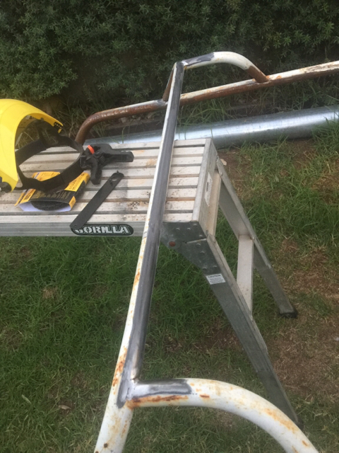

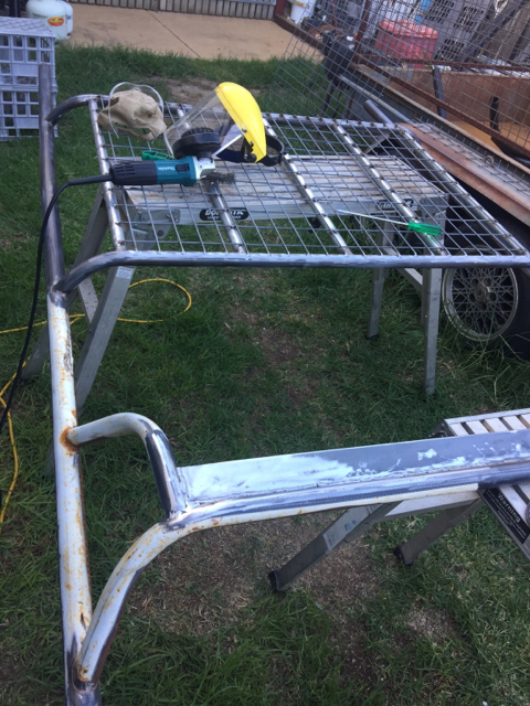

Bloody Hell!! Big day! Knackered. Most of the day with a 5" grinder in my hand. Many years ago I had my own business as a Cabinet Maker and had a Sander or Grinder in my hand all day, between that and riding a Sports Bike my forearms and wrists are rooted. Today was a hard slog!!
Tried a few different options to strip the paint (all expensive) the Wire wheel worked a treat. Lethal but effective!
PPE was ear plugs, safety Glasses, full face shield over glasses and hat. Nasty bit of kit is the wire wheel! Spits all day.

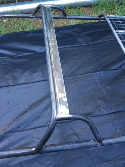

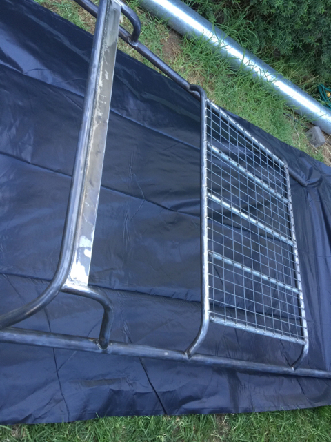

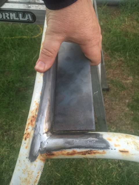

Welded to plate on for the light bar to mount to.

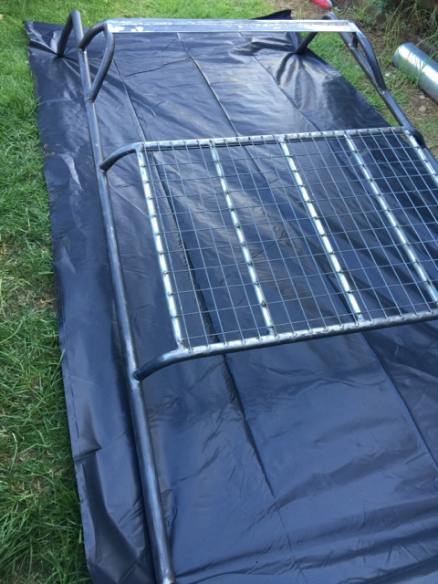

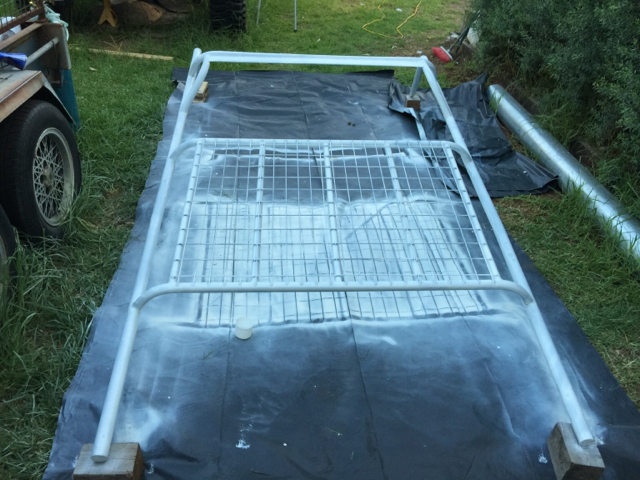

All stripped, welded, cleaned, wiped down with Wax & Grease remover. Ready for some primer.
http://www.nissanpatrol.com.au/forum...2016/04/30.jpg

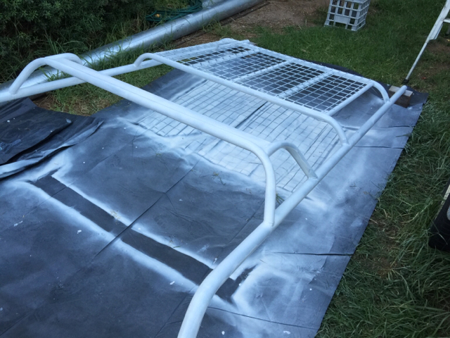

Just want to get a coat of sealer on so I don't have to clean off rust next week.
http://www.nissanpatrol.com.au/forum...2016/04/31.jpg
http://www.nissanpatrol.com.au/forum...2016/04/32.jpg
Lookin good Daz, will be worth the hard slog
