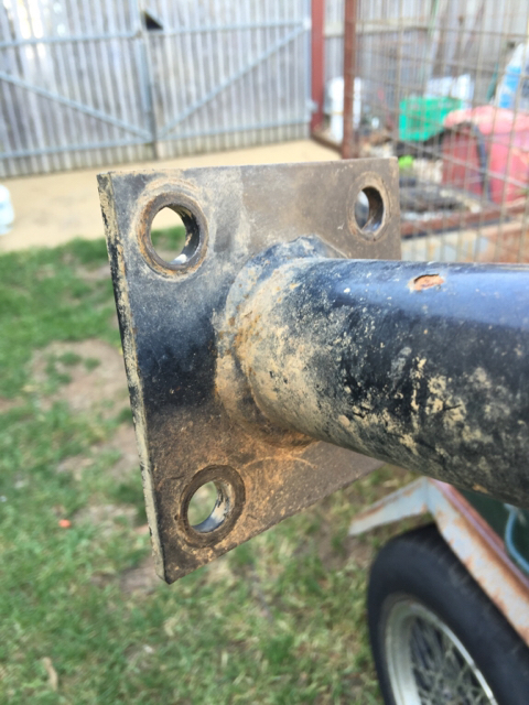

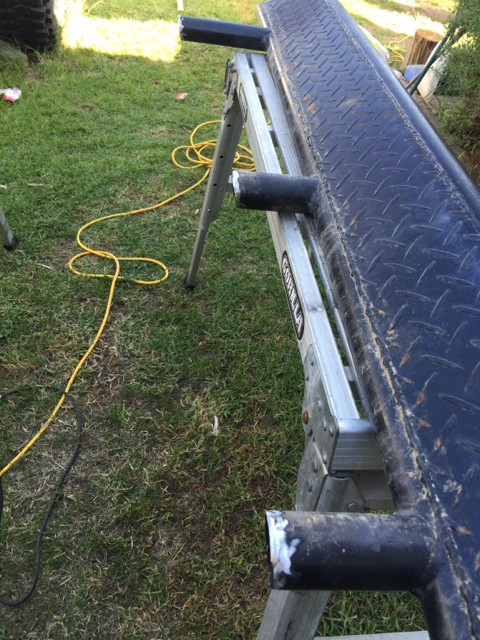

So my rock sliders where made for a 2" body lift. I have removed most of the body lift so these need adjusting. Can't be hard? Right?
Cut the mounting plates off. Change the angle, line it up. Tak. Remove. Finish weld.
Yeah right! What a bastard! The front one is longer so making a slight change to length and I can't centre on all plates.

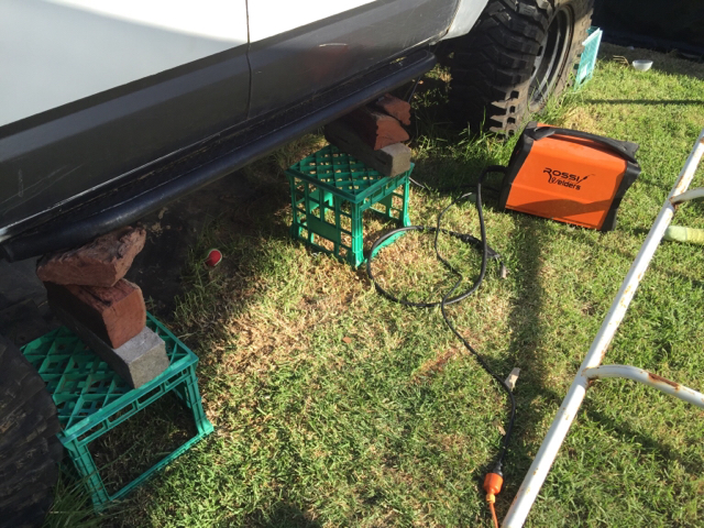

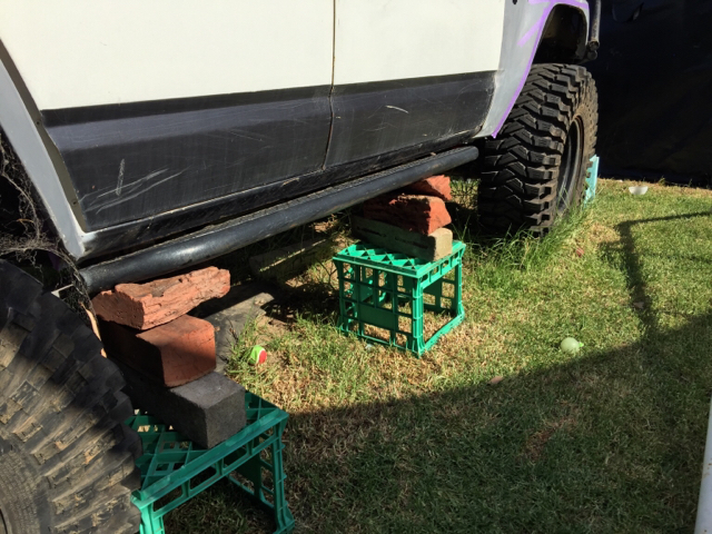

Finally lined it up after stuffing around for several hours last night. Very difficult to do this alone. Battle on.

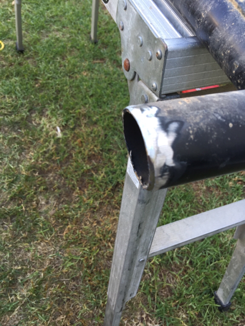

Tacked up and removed the supports. Undoing the mounts again. And while undoing the last one it came crashing down on me breaking all tacks, landing on me and loosing the setup completely! Damn you I said quietly.....
Just finished the first one!! Used the gas less wire I had in the welder, spits crap everywhere! I will Not be using it on any of the other bar work, I will buy a bottle.

No pics of your welds? ;p. I hate gasless mig.
Spray the area with cooking oil ,that should stop the splatter
