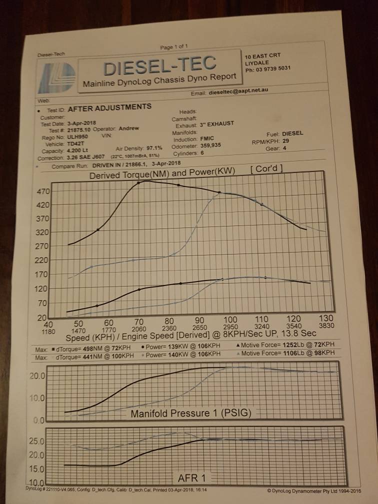

Picked up the GQ last night from dieseltec, drives heaps better now. Set at reasonable level I'm happy with, pulls pretty hard if you give it a poke and cruises much better. Haven't had a chance to drive it much tho, had to go out for tea last night. So putting out 140kw and 500mn at the rear wheels at around 20psi could defiantly get more out of it but think it's enough for what I want it for.
http://www.nissanpatrol.com.au/forum...2018/04/28.jpg
Nice result ross. For reference though this turbo really comes into its own at around the 28psi mark and 180kw+ area. There is quite a bit of r&d going on up here so if I can get down for licola then I will pass some of the findings onto you and andy.
Yeah nice one. Andy did say could get some more kays on the motor then get some more boost into it down the track. Reckon I'll drive it for a bit and see how it goes but so far very happy with it and also do want to keep it safe for peace of mind and longevity.
A bw at 180kw is for longevity. Once we start venturing beyond 200kw it starts to get a little hazier but the way the bw generates boost its much nicer on drive train. Remember you are not always using that amount. There is one up here that has been running 200rwkw+ for over 2 years now without an issue.
