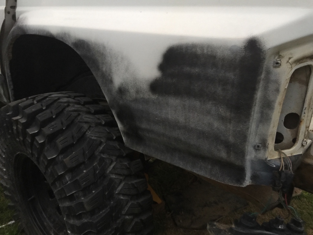

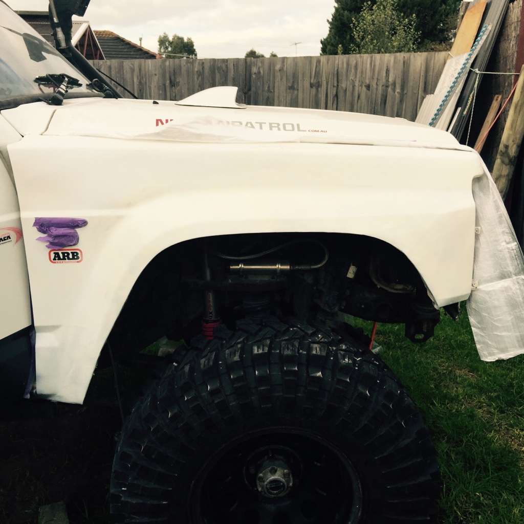

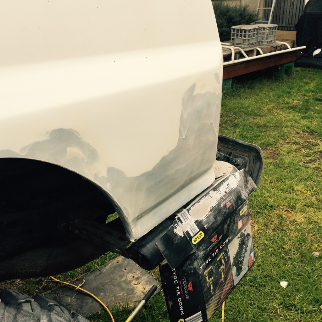

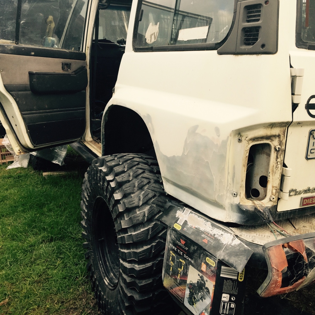

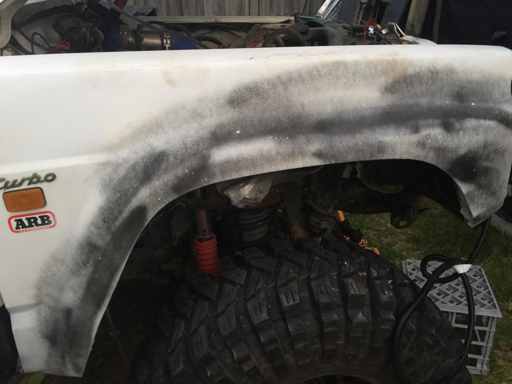

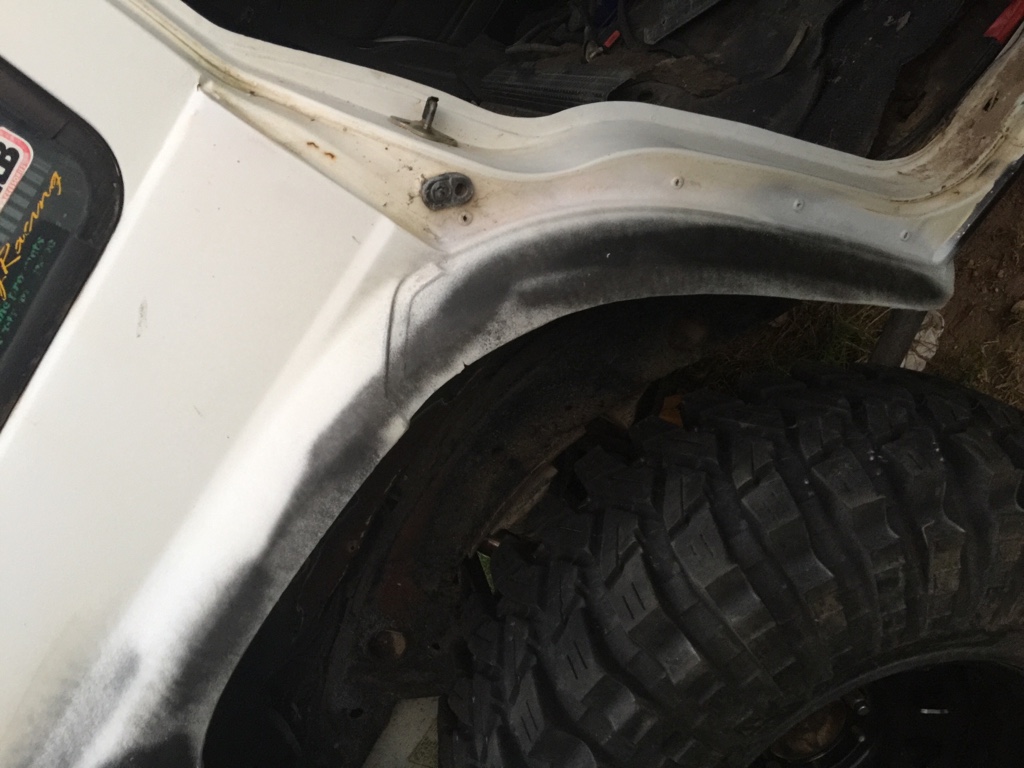

So I have neglected this thread a little. Pace is slow but been doing other things.

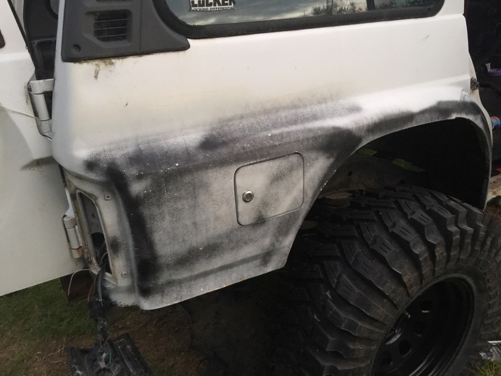

Guards are fine and waiting for a final rub and paint.

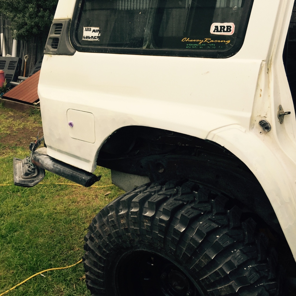

Lightly spray a sand coat over and gave left it for better weather while I do other things

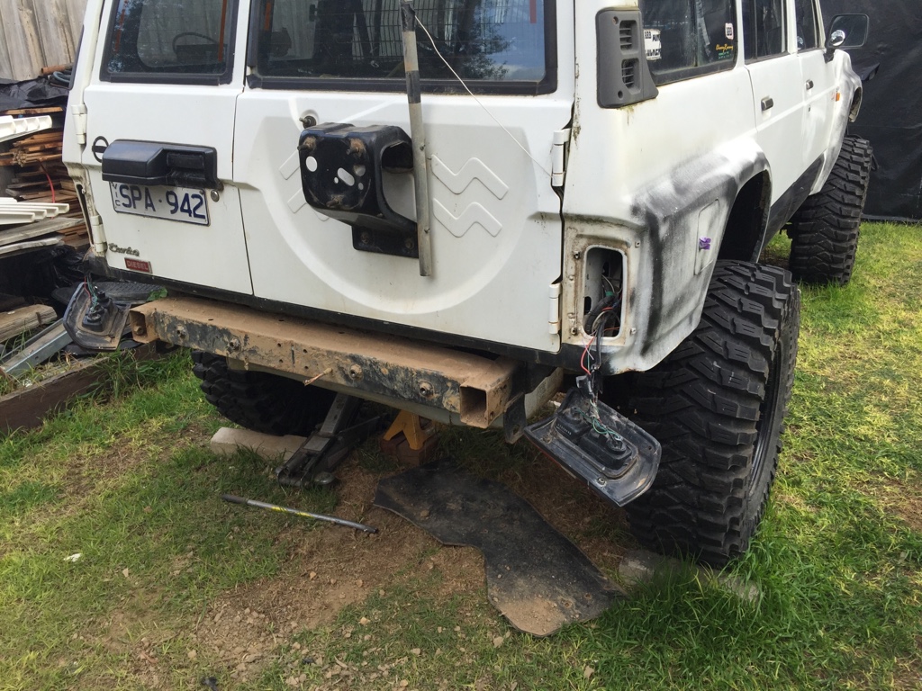

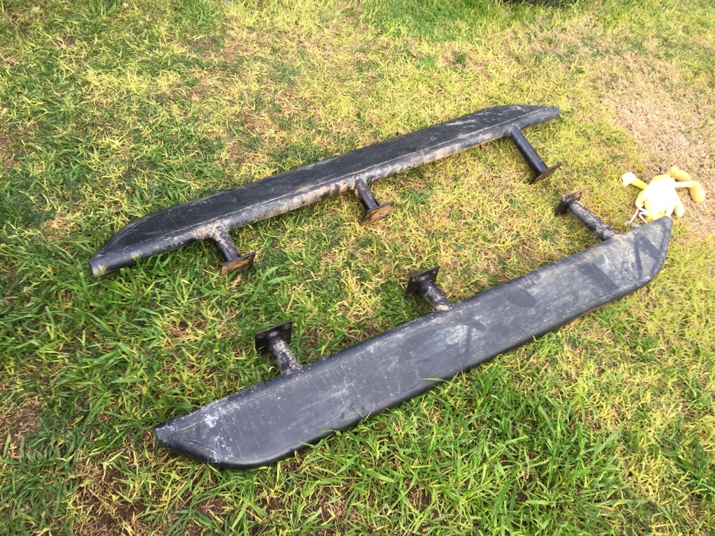

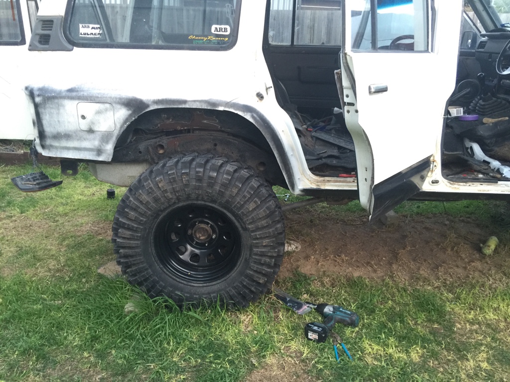

Finally got around to dealing with the body lift. This is a massive job and one I have been not looking forward to. All the bar work is to suit the body lift! Sliders, rear bar, front shock towers. Damn!!
http://www.nissanpatrol.com.au/forum...015/08/217.jpg

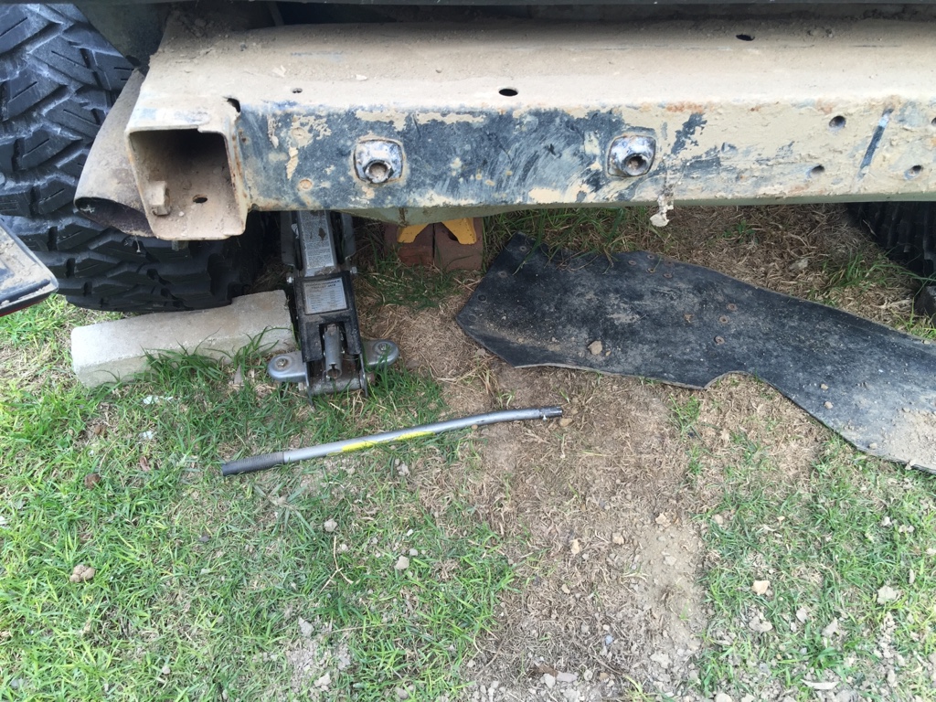

What a bastard these where to remove. The bolt is 18mm!! WTF!!! Who has an 18mm anything!!!! I had to go and buy a single socket to suit! No f'ing idea how I fitted them last time without an 18mm socket????

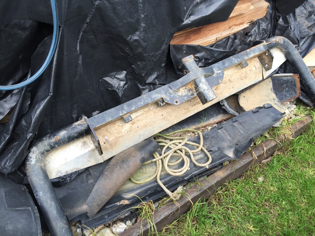

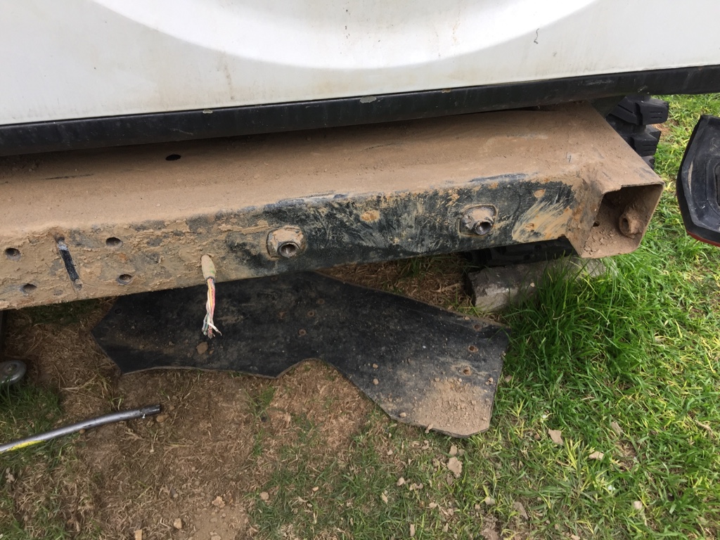

Next is the rear bar. Bloody hell! I made it Good!! No less than 14 bolts hold on the rear bar!!
http://www.nissanpatrol.com.au/forum...015/08/219.jpg
http://www.nissanpatrol.com.au/forum...015/08/220.jpg
Notice I have welded a row of nuts across the back for extra fixing points. My rear bar is also my recovery bar as I don't have a towbar fitted. I well and truly Over a Engineered my bar but confident it won't break.! Lol

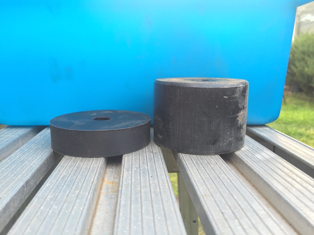

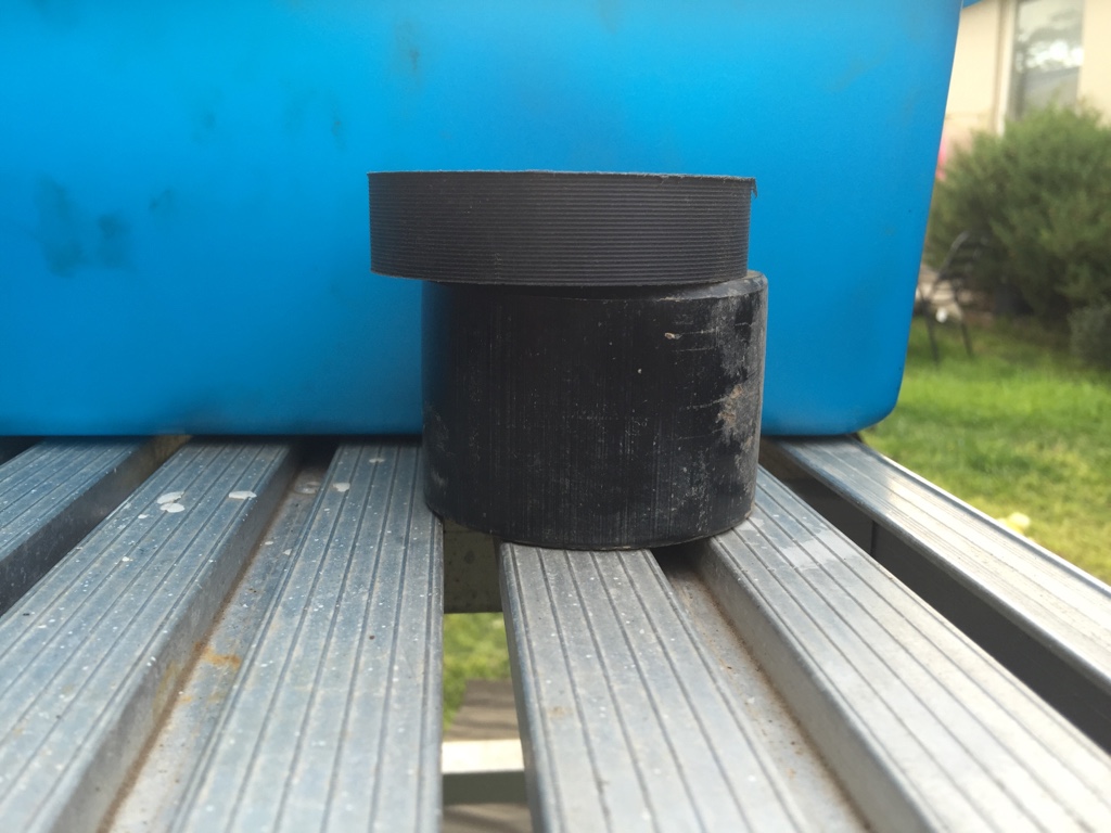

Today was body lift reduction day.
Kallen made a set of 20mm body blocks about 12months ago for me and I have finally got around to fitting them. I had to buy a new set of bolts as mine were all to long.

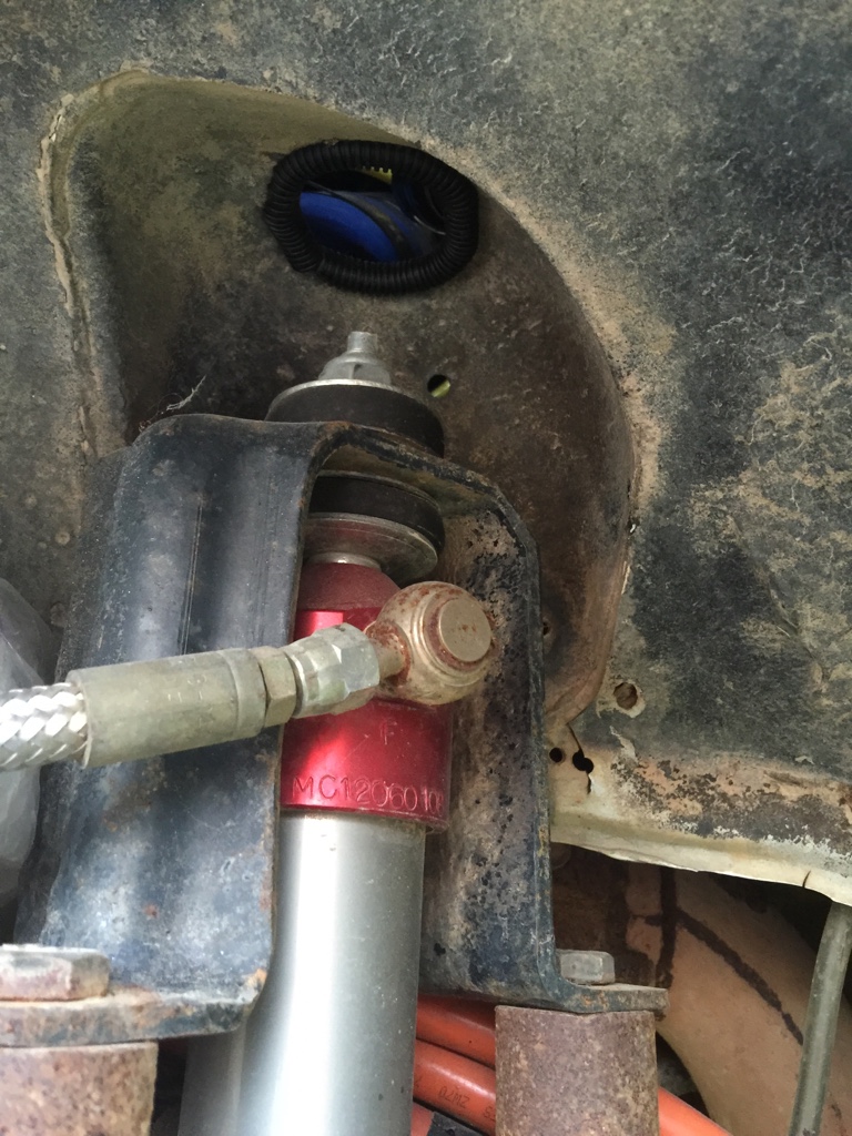

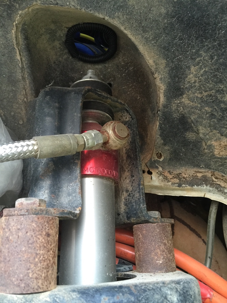

I have lifted my front shock towers to accommodate longer front shocks do I drilled a 50mm hole in the top of the inner guard so I can still get to the top of the shock if I need to remove one any time.

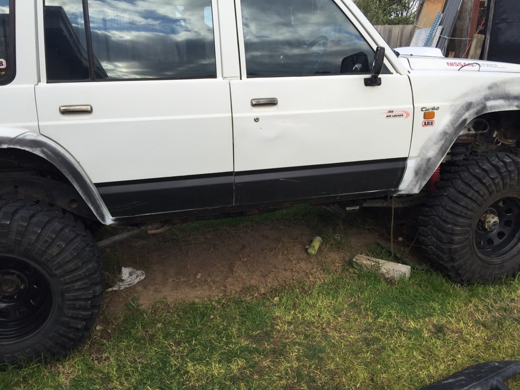

So jacked up the body on both sides. Some of the bolts were a bastard to remove but got them all finally.
http://www.nissanpatrol.com.au/forum...015/08/227.jpg
All done. 30mm drop. Need to tighten all the bolts now, will get to them tomorrow Arvo.

My car is too big and removing some of the body lift gives me back 30mm straight away. The 20mm blocks almost look factory too so I might not get pinned for a body lift which is now illegal in Vic I am told.it was legal when I fitted it.
