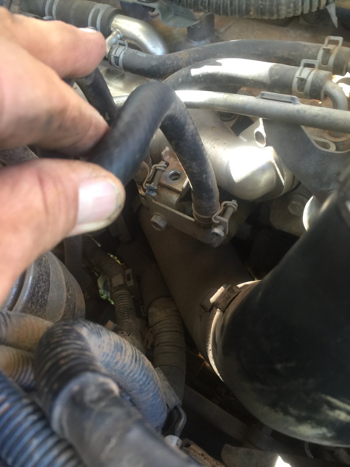

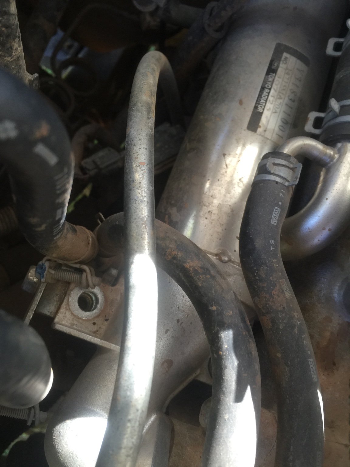

RightO my sprints wasn't open fork them, need a 12mm ringy to replace the lost one. So intercooler off and the bracket holding the fuel hoses to the egr thing
http://www.nissanpatrol.com.au/forum...015/12/207.jpg
http://www.nissanpatrol.com.au/forum...015/12/208.jpg
http://www.nissanpatrol.com.au/forum...015/12/209.jpg

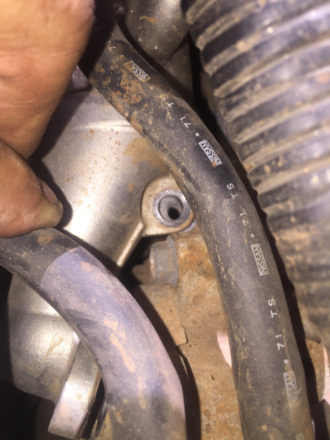

But this MOFO snapped getting it out ?!$@
http://www.nissanpatrol.com.au/forum...015/12/210.jpg

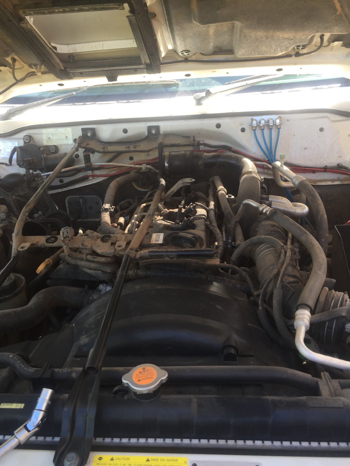

Anyway EGR blanking plate in (cheers TD) and it still runs YAY
Well done. Your engine is thanking you as we speak. It can finally breathe some fresh smog-less air.
Thought id effed up big time. Took her for a drive pop bdrdrdrdrdrddddrrrrrr. Didnt tighten one of the intercooler pipes up enough and popped it off
