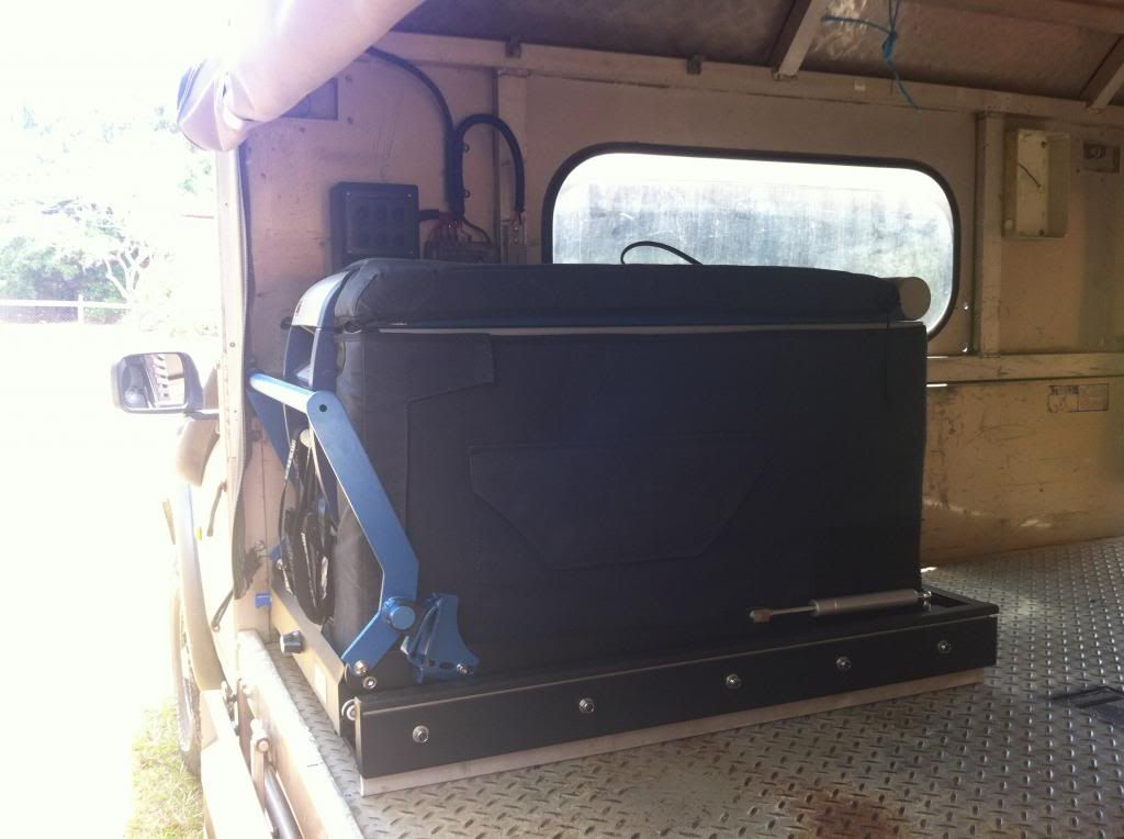

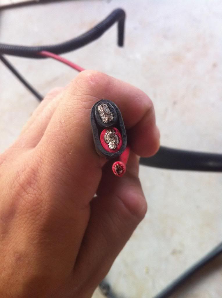

OK been a while since an update. Just before chrissy with the help of some members from here I purchased a drop down fridge slide. This will help the girl access the fridge as she is only 5ft tall. Also the wiring that was installed by the previous owner wasnt up to mys standards so I replaced all that and wired in some new stuff.
First off this is the wiring comparison for the supply to the canopy, you can see how small the previous owners wiring was.
http://i1248.photobucket.com/albums/...ps43e3c87f.jpg

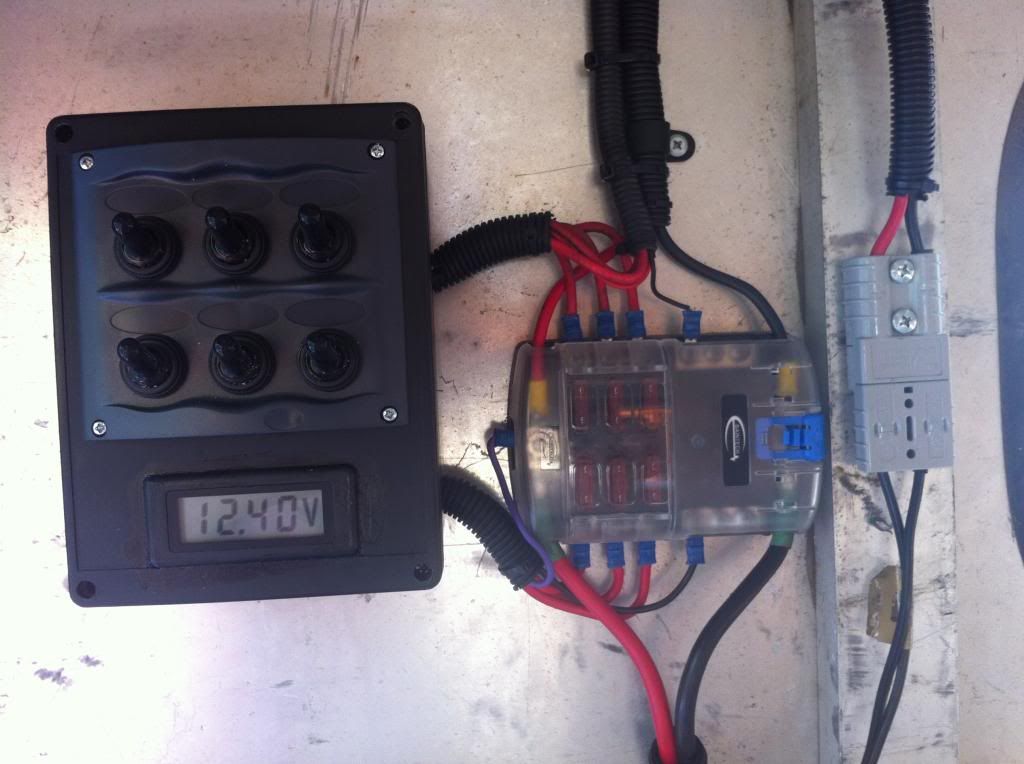

Then I installed the fuse box with a Neg bus bar, switch panel for canopy lighting and a voltmeter. As you can see I have changed everything to anderson plugs as well for a better connection.
http://i1248.photobucket.com/albums/...ps689929e5.jpg

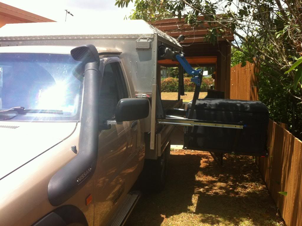

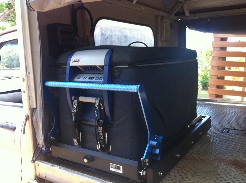

Then the fridge slide went in. This thing is great, the design and placement of the struts makes it a breeze to use even with a full 80L fridge.
http://i1248.photobucket.com/albums/...psb75d31b6.jpg
http://i1248.photobucket.com/albums/...ps50b75148.jpg
http://i1248.photobucket.com/albums/...ps9e9a19c0.jpg
http://i1248.photobucket.com/albums/...psda8dec84.jpg

G'day mate,
That fridge slide defiantly makes a difference to your set-up mate!
PS, once again! your craftsmanship shines through on your installation workmanship! Job well done and nice photos mate!

G'day mate,
Where did you source your control switch panel from?
