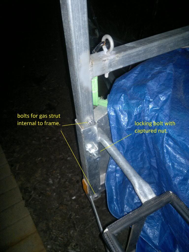

How exactly does your framework go? does it all get lowered when driving, so the tents are not sitting up that high when your driving..
Any chance of a few pics of the framework and setup?

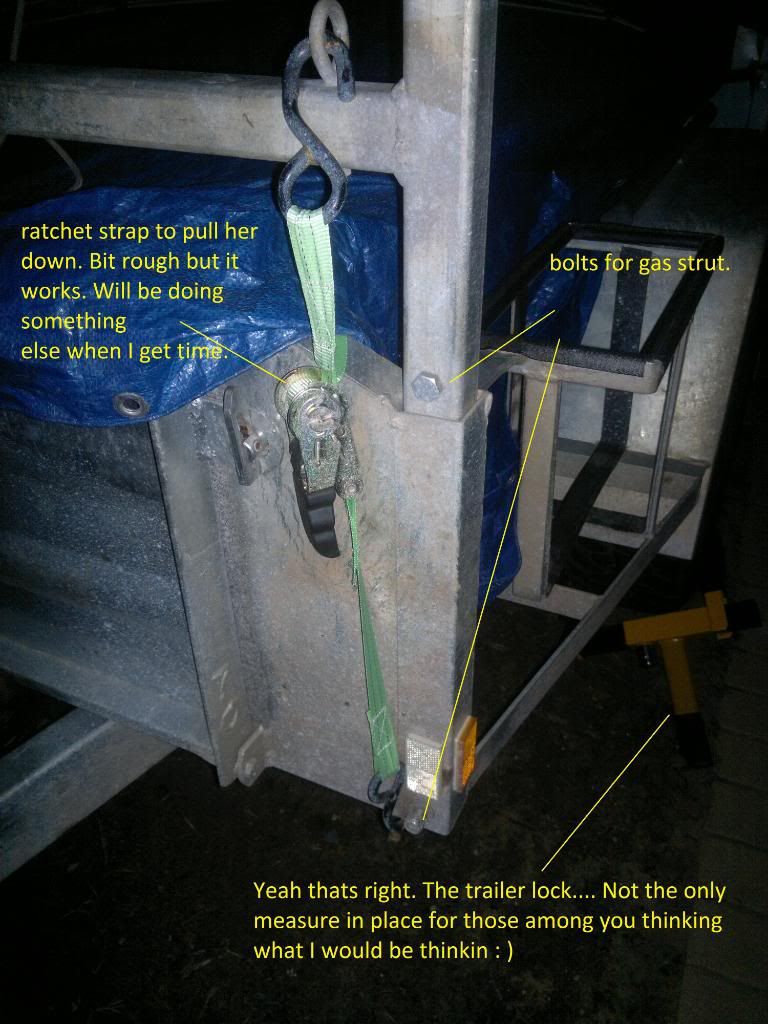

It all colapses down about 350mm. You can see the cross rail at the front and rear that support my tiny and sturdy the whole thing up. That at driving height would be about 100mm from the top of the trailer. This means the tents are lower than the roof of the truck to reduce drag. Works well. Got a few things left do but for now I use ratchet straps and locking bolts welded in to hold her down. Gas struts to help lift her up. Give us a PM if you wanna have a look. In Baldivis.

Not here for long mate. Goin back east for a new job in Sydney. The biggest issue you will find without gas struts is getting it to come up even. This sytem will jam allot as it is inside the box section (am thinking about greasing the whole shit). I have issues when people try to help and they don't understand it has to come out even. The handbrake and I have no troubles though. The gas struts just help to get it out evenly without jaming up, especially considering the tents are off to one side. The spring lock sounds like a good set up. I am a little concerned at how you would go getting it down though without the struts. You will need someone on each corner to hold it up while you undo the spring bolts.. Just a thought mate.

Eye to eye so you can bolt through them. I beleive they where 700 long extended but you would take your own measurements to optimise the amount of lift. I have mine set to 500N but I need to get them pumped up a bit. 600-700N would be better with the tinny. You can get them made to your spec I:E if you want different ends and pressures they just screw new ends on and change the pressure ( can only INCREASE the pressure though, you go to hard they are fucked). Cant remember what I payed. I remember the anchor thought it was extausion and I thought it was fair ( She's tight as hell.... With money...).
