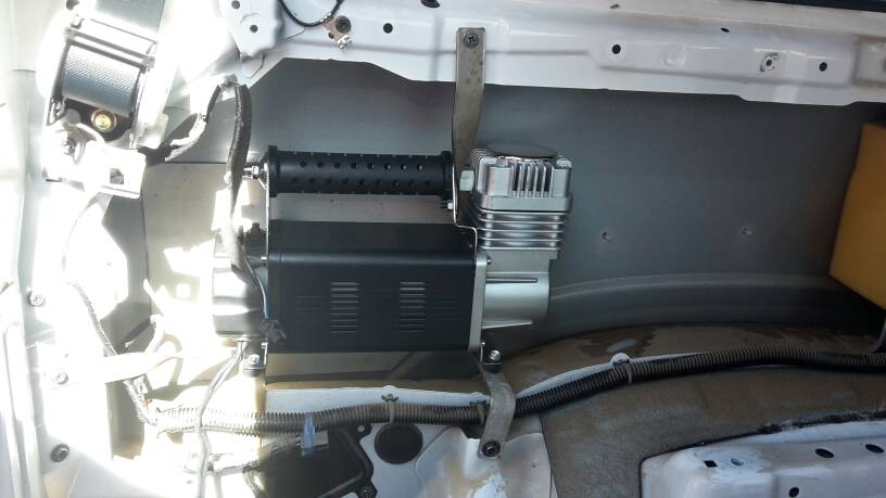

So main tank breather mod done for extra capacity..
I also started the mounted air compressor in the rear 1/4..
Stainless flat using original bolt holes..
Solid as a rock in there..
Next I have to make a manifold to take the new pressure cut off, a gauge and outlet line..
It's a nice fit and heaps of room..
Might even get a small 25-30L water tank in there.

It's gonna get pretty hot in there mate. Maybe a small computer fan that comes on when the compressor has power?
Yeah agree you may need to fit a panel with vents on it to get abit of air flow going

Yep I have a 125mm 12v fan I'll put on the relay so when the compressor is running it'll be drawing in cold air..
Not hard at all.. once the bloody draws were out the way (they ain't coming out unless I dismantle them!!!) just remove the few screw on things like Jesus handle, cargo clip and belt retainer.. remove the window surround and then remove the lower section..
It's majority clips..
I don't think I need external air.. this cavity is huge.. and runs all up into the roof..
