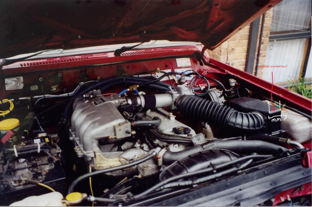

Heres my VN Airbox Upper and Lower installed into my 1988 GQ.
They used to be around $40 for both Upper and Lower.
http://imageshack.us/photo/my-images...dpatrollpg.jpg
Another one
http://imageshack.us/photo/my-images...atrollpg2.jpg/
At this stage the car was running straight LPG through an EFI intake manifold with the injector holes plugged.
Up to VS I think are the same except VS has a sensor hole in the upper which will need to be plugged if you dont have the sensor filling the hole.
I later installed the factory GQ airflow meter in one of these by enlarging the inlet hole and drilling new mounting holes. Luckily there is enough area to allow you to do this as the Factory Airflow meter is quite a bit larger.
Also worthy of note is the filter element is identical to the Factory GQ patrol EFI one.
I later installed the factory GQ airflow meter in one of these by enlarging the inlet hole and drilling new mounting holes. Luckily there is enough area to allow you to do this as the Factory Airflow meter Mounting is quite a bit larger.
The only Downside I found that it would have been more difficult to attach a Snorkel to this setup.

any chance, in that location, to get around the overflow bottle to snorkel cut out?
I think we are onto a winner here :). cheers
