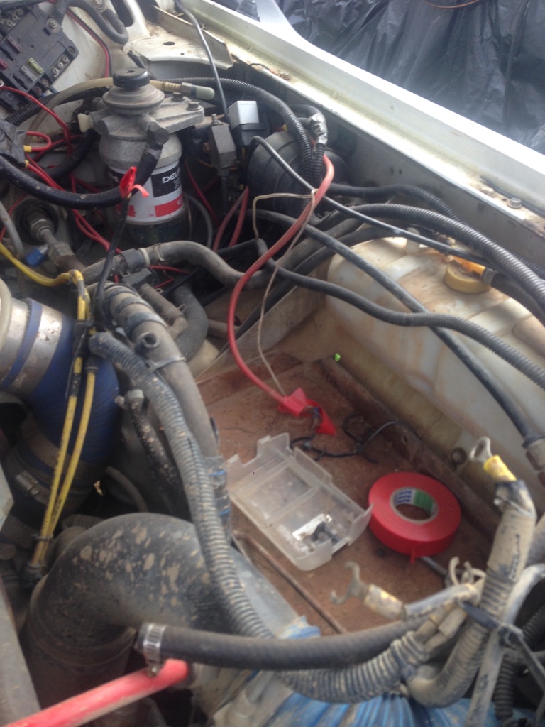

So I had s bit of a look through and there is a heap missing here.

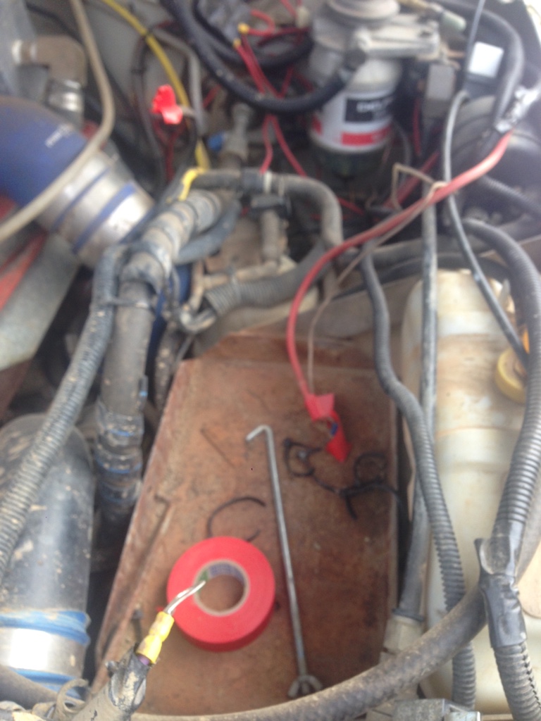

A couple of pics of the rewiring and cleanup
http://www.nissanpatrol.com.au/forum...015/05/196.jpg
From that ^^^^^^
To that VVVVVV
http://www.nissanpatrol.com.au/forum...015/05/197.jpg
http://www.nissanpatrol.com.au/forum...015/05/198.jpg
That's a clearer pic of where it started

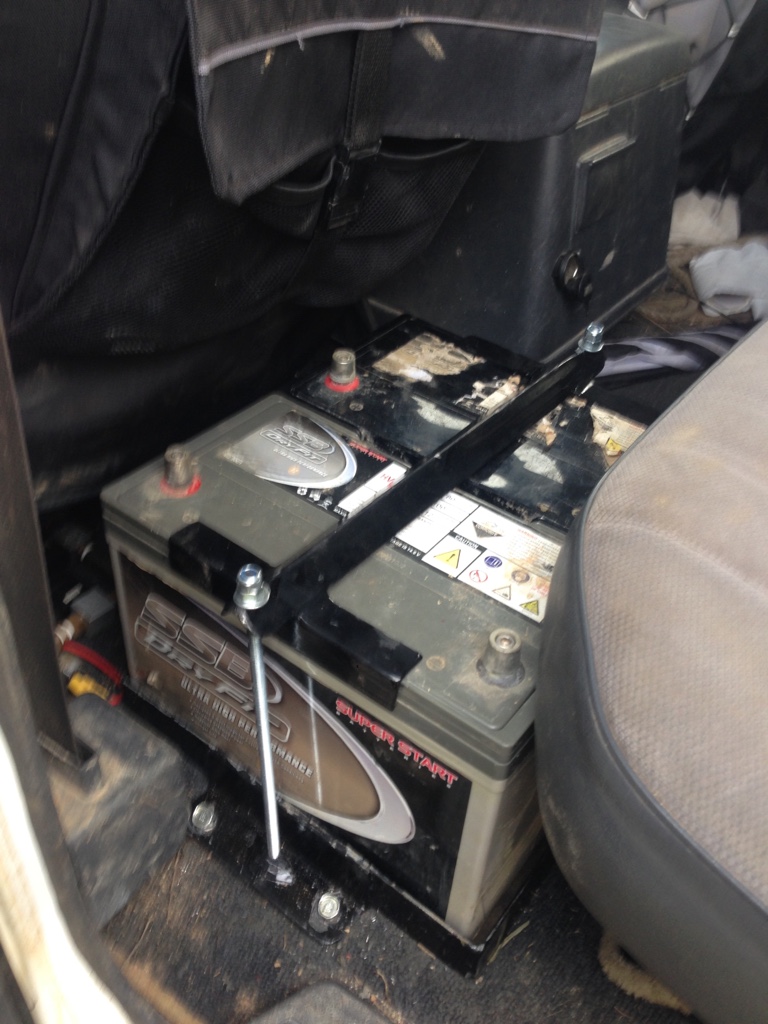

So numb nuts where is the battery now and what sort is it?
Any pic's of that.

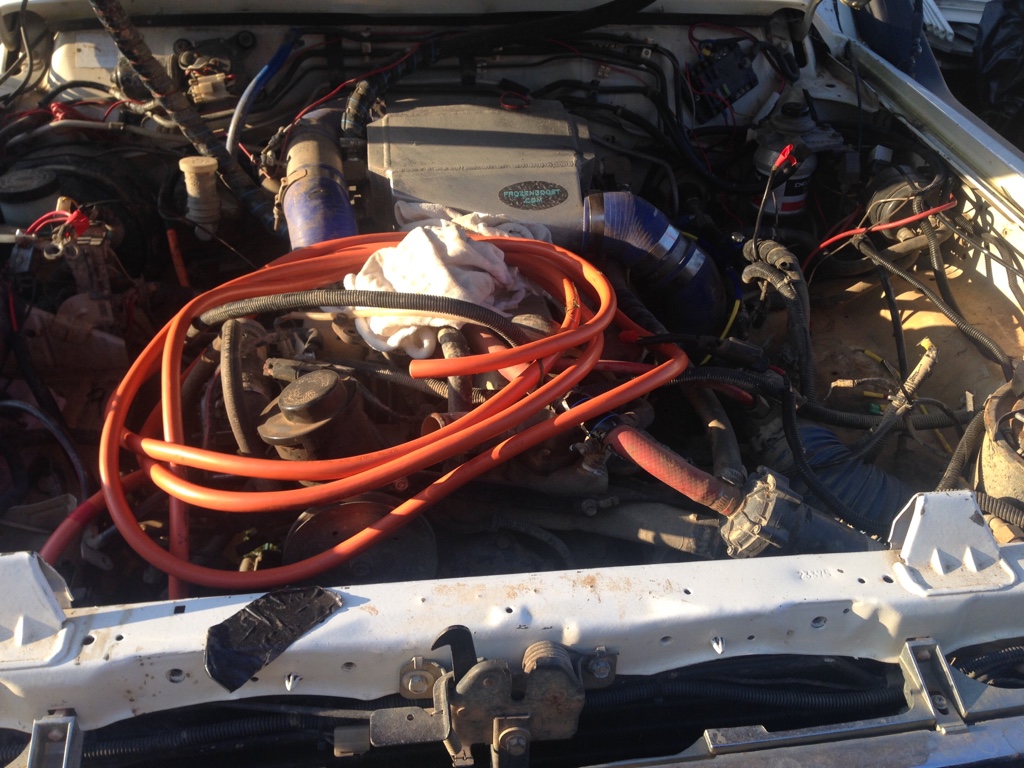

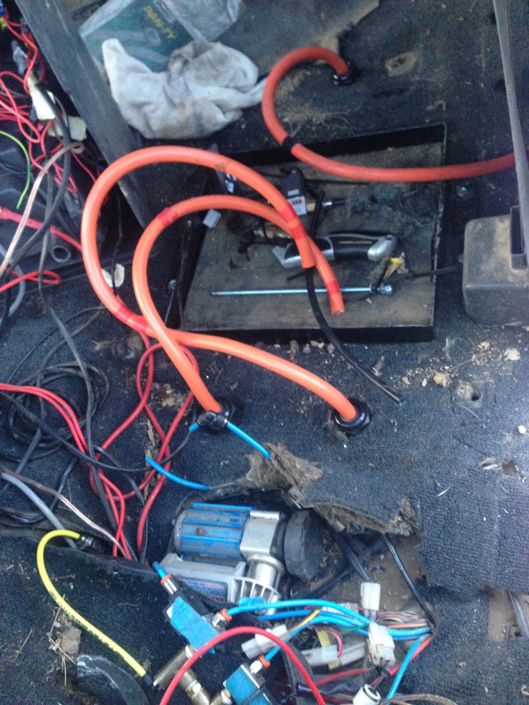

The interior is out of the car at the moment allowing me access for sorting the air system ready for the Freespool for the winch and run all the 24v system. I gave run 70mmsq for the entire 24v system, sick!!!
http://www.nissanpatrol.com.au/forum...015/05/199.jpg
http://www.nissanpatrol.com.au/forum...015/05/200.jpg
http://www.nissanpatrol.com.au/forum...015/05/201.jpg

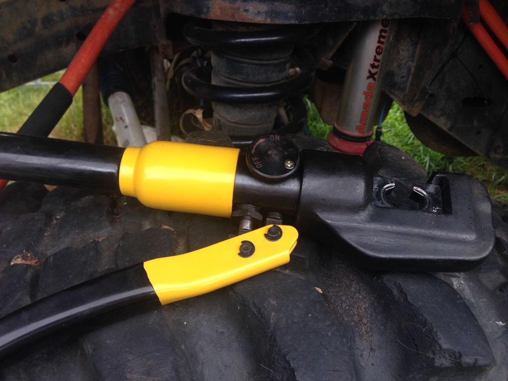

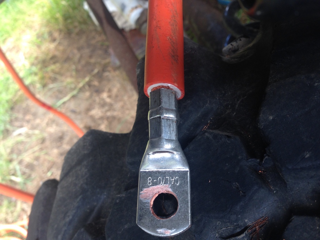

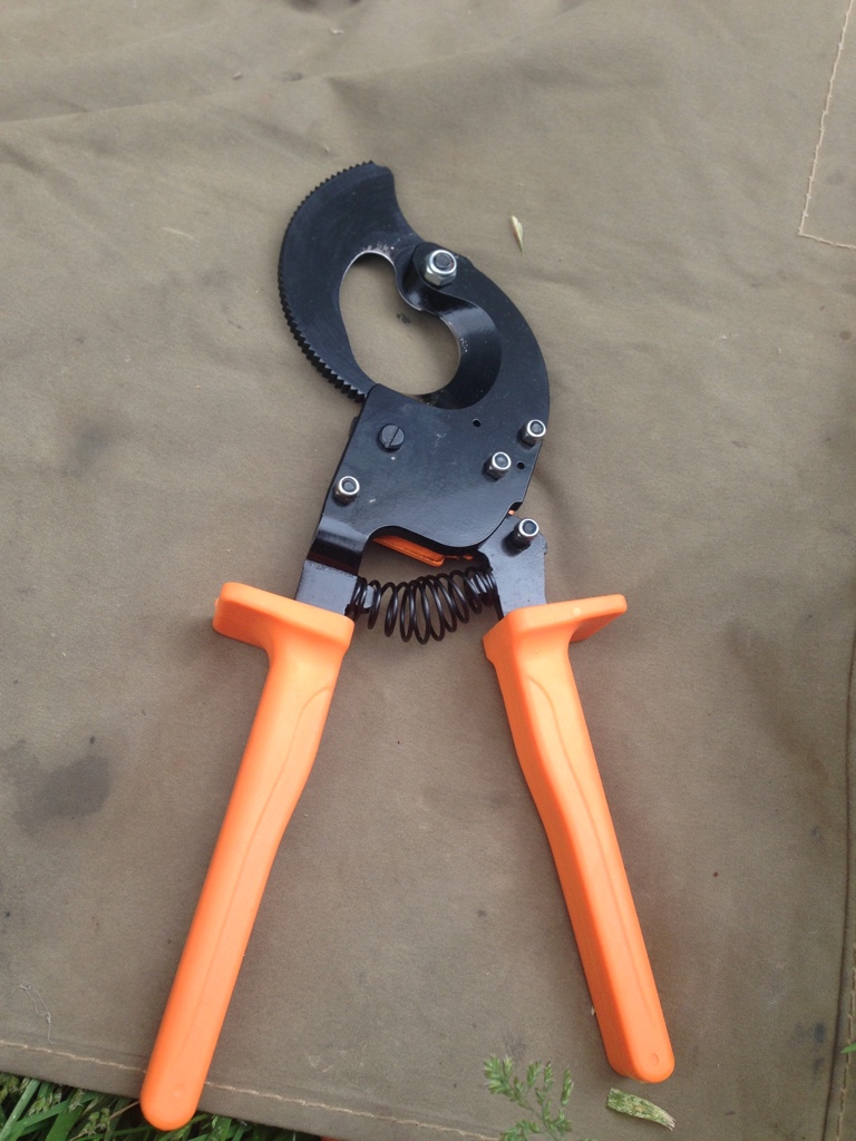

$45 crimper off ebay is wicked!! I had to buy a set of cable shears to cut the 70mm and they work a treat too
http://www.nissanpatrol.com.au/forum...015/05/202.jpg
http://www.nissanpatrol.com.au/forum...015/05/203.jpg

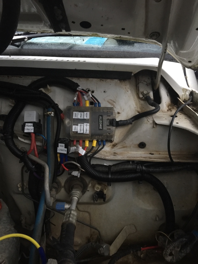

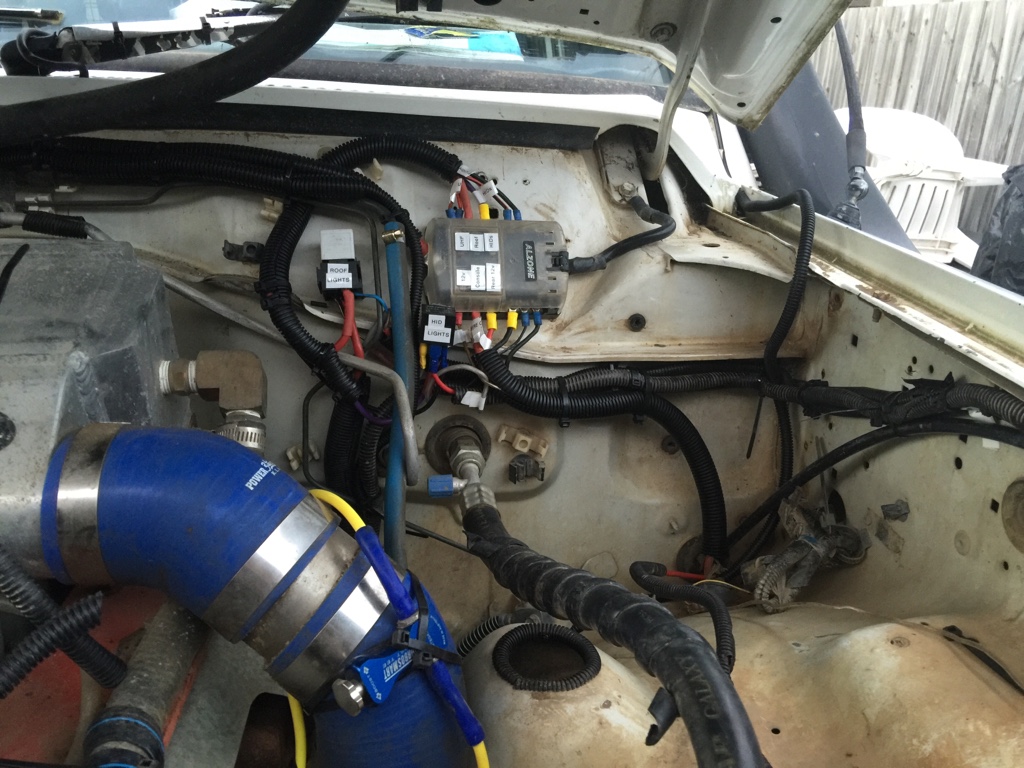

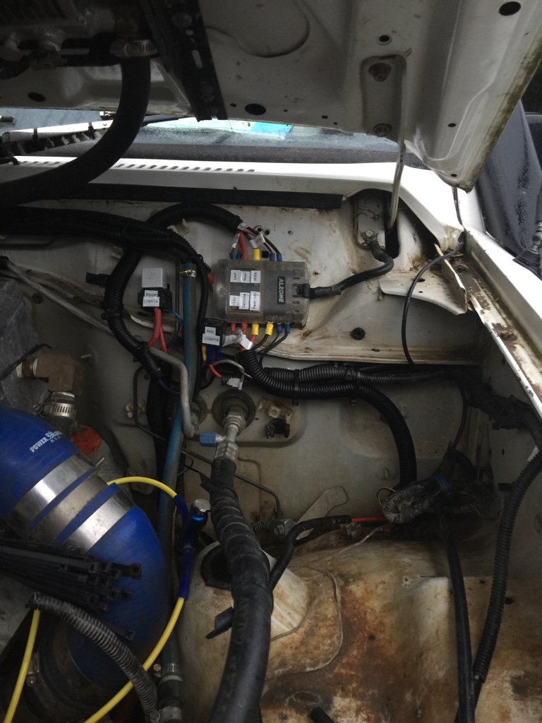

I will now run only 1 x 12v battery in the car. It's under the Bonnett in the usual spot, it's a brand new Marine battery. All the stuff that was on the second battery is now wired to the fuse box you can see in the fire wall.
http://www.nissanpatrol.com.au/forum...015/05/204.jpg
http://www.nissanpatrol.com.au/forum...015/05/205.jpg
24v system is s pair of Fullriver Gel batteries that were my pair under the bonnet before.

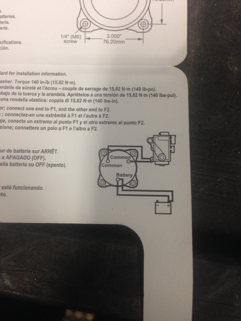

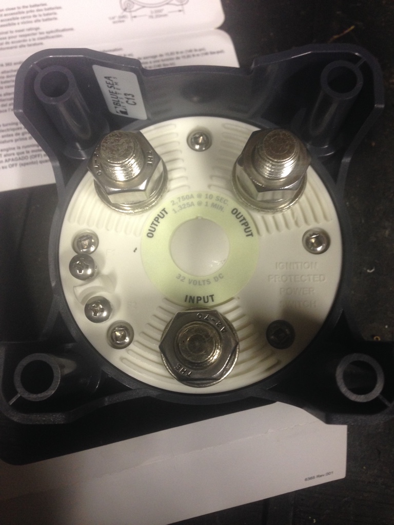

I am fitting a 600amp continuos switch on the back of the centre console so I can turn the system off in an emergency.
http://www.nissanpatrol.com.au/forum...015/05/207.jpg
http://www.nissanpatrol.com.au/forum...015/05/208.jpg
http://www.nissanpatrol.com.au/forum...015/05/209.jpg
