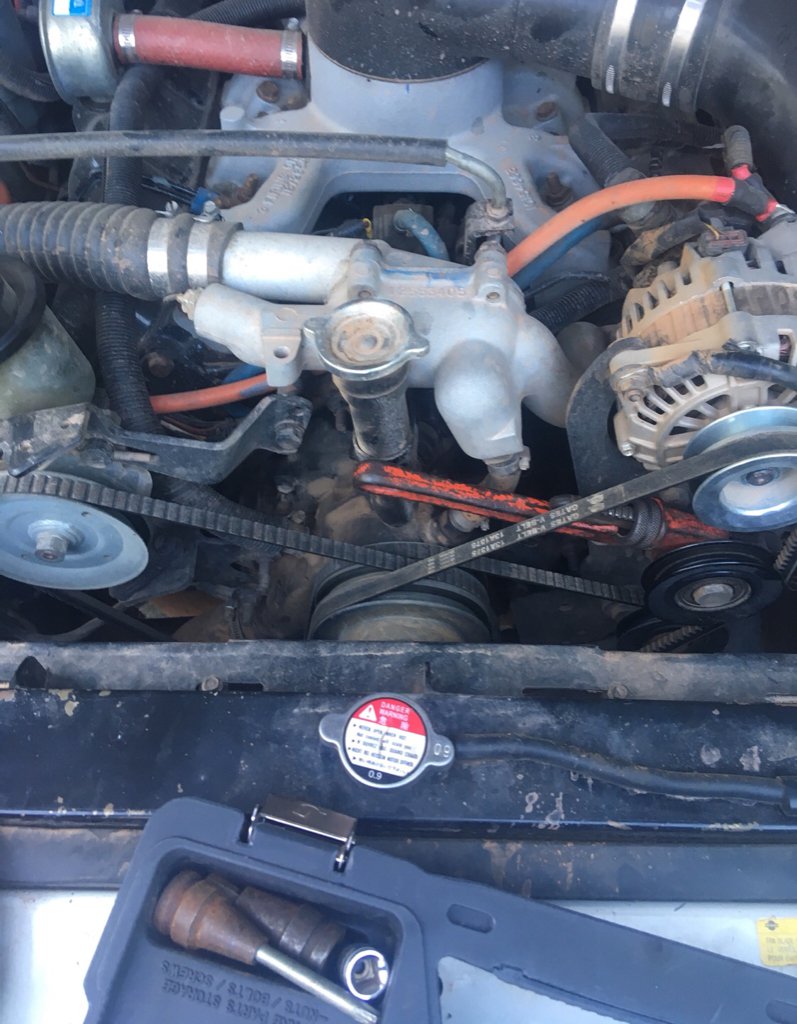

I’ve sussed out a possible Alt twin V belt option tonight by installing a larger belt to share across with the PS pump and off the crank together. It will require an additional idler pully for guidance away from others though, for now all I could do was to stretch the last bit of life out of the belt. http://www.nissanpatrol.com.au/forum...018/01/147.jpg

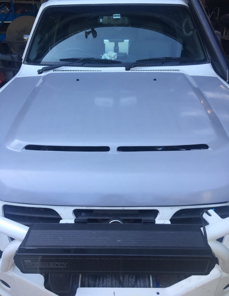

Installed the unpainted new bonnet from Blitz before doing another identical hill test run flogging it again with the boat. http://www.nissanpatrol.com.au/forum...018/01/148.jpg

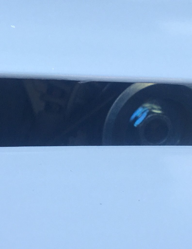

Alternator sits perfectly in fresh air flow now.
http://www.nissanpatrol.com.au/forum...018/01/149.jpg
Seems to have worked for now on the Alt although time will tell without the secondary belt yet and a rectifier thingybob.
Best news for the new bonnet has been water temps ran 3-5 degrees cooler on the big flogging haul up compared to last night and temps dropped about 3 degrees below TS presets when cruising on the flat, very happy, will test some more for sure!
