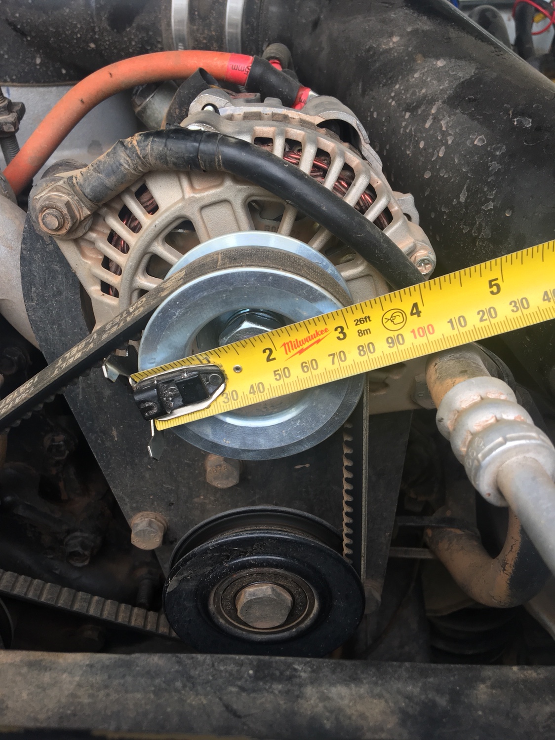

the ZD30s have a cutout in the radiator shroud to allow air to flow to the Alt for cooling, maybe look at doing something similar.
Mark, my 100amp alternator failed after 1500klm. It overheated to the extent the insulation on the windings charred and blew out the back. I am betting your alternator has been beefed up to generate the 170amps peak and the rectifiers have been left the same, as they can only be so big to fit inside the alternator. To that end the recifiers are doing more unit work at 170amp rating than they are at say 90. Regards the 60amp draw, I would say this is well above the duty factor for that alternator, probably above most alternators to be honest. I am going to fit the external diode pack as previously discussed to get past the heat resistance issue.

2.43 to 1.
Hmmm... if thats the size for the TD then thats a tad slow to me for a Chev

As a point of interest I'd be a tad suprised if you get max output from that Alt with only one drive belt as well.
Anything over about 110/120 will usually have two belts.
That Alt of yours will pull something towards 2 horsepower at max output
which is why poly vee belts are better ie serpentine.
I can pull 200amps out of my aux alt. on 1 'a' section vee belt, but for longevity you don't want to do this. I tong tested this with a DC meter so know it is possible.
