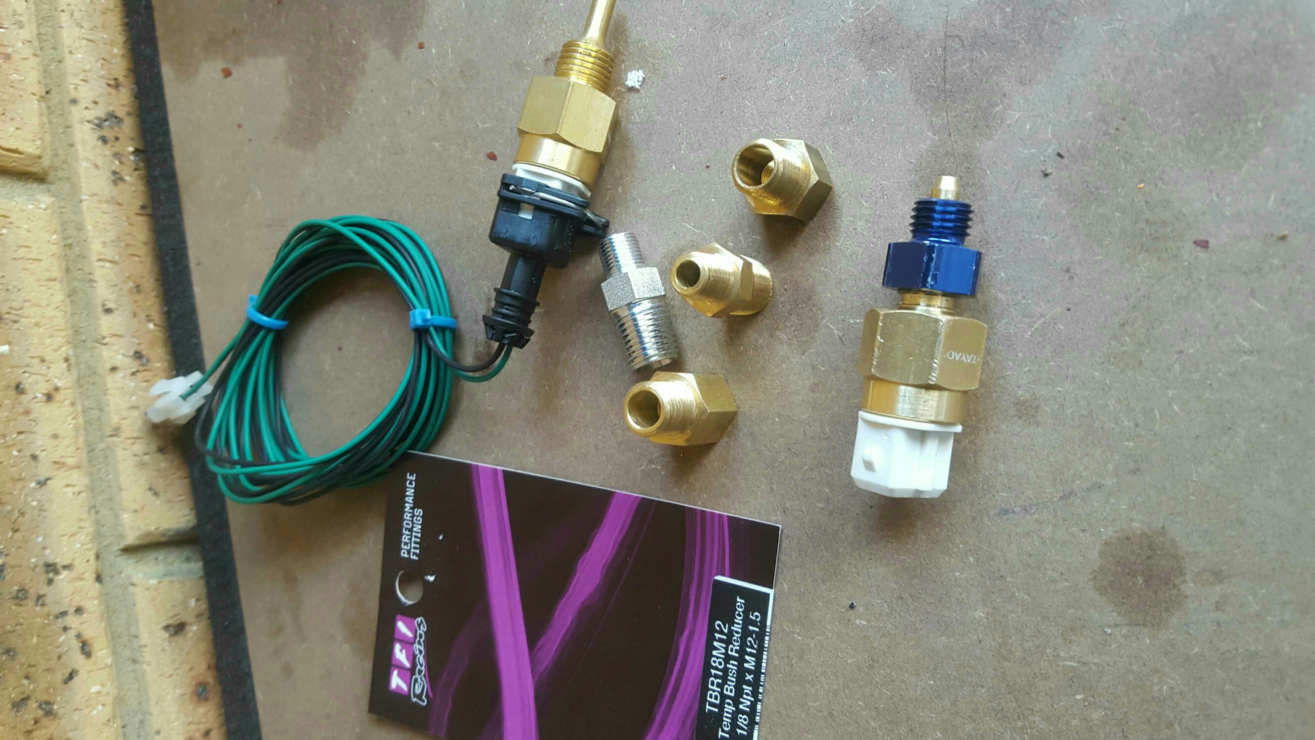

After trial and error of few adaptors and sensors , the blue adaptor is best fit as it allows the most sense probe surface poking out at coolant end.
Case dismissed. Now to plug it in one cool morning.

I'm actually thinking of get the OEM plug and drilling and tapping that. Then the probe will be further in. As I reckon my temps are false. They are hotter than it actually is. Because of the sender sitting out so much its soaking more radiant engine heat than coolant.
How do you know its hotter than it really is?
You talking about drilling the original blanking bolt ? I thought about that, but once you drill big enough hole/thread for the probe, there ain't much meat left on the side walls. Unless you're talking about something different ?
Mat was right earlier, the main sensor thingie is at the very tip, as far as my quick google search has revealed ...
It'll be hard to gauge whats accurate and whats not, as there is nothing to compare it to. Wish if somehow you could pickup the readings from the factory probes in a numerical way.

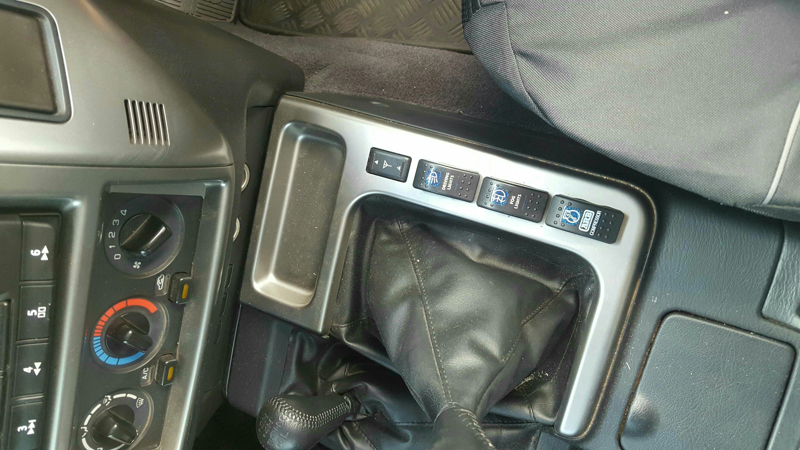

@ Eric does your centre,, console right of the gear stick have any switches there?
Yeah mate. That antenna switch is doing nothing. It'll be replace with front locker switch early next month...
http://www.nissanpatrol.com.au/forum...015/12/121.jpg
Tapatalked from S6
You just mounted the switches ,,I brought the inserts that the switches fit in.
Good to see there is enough depth for switches, Thanks for that>
