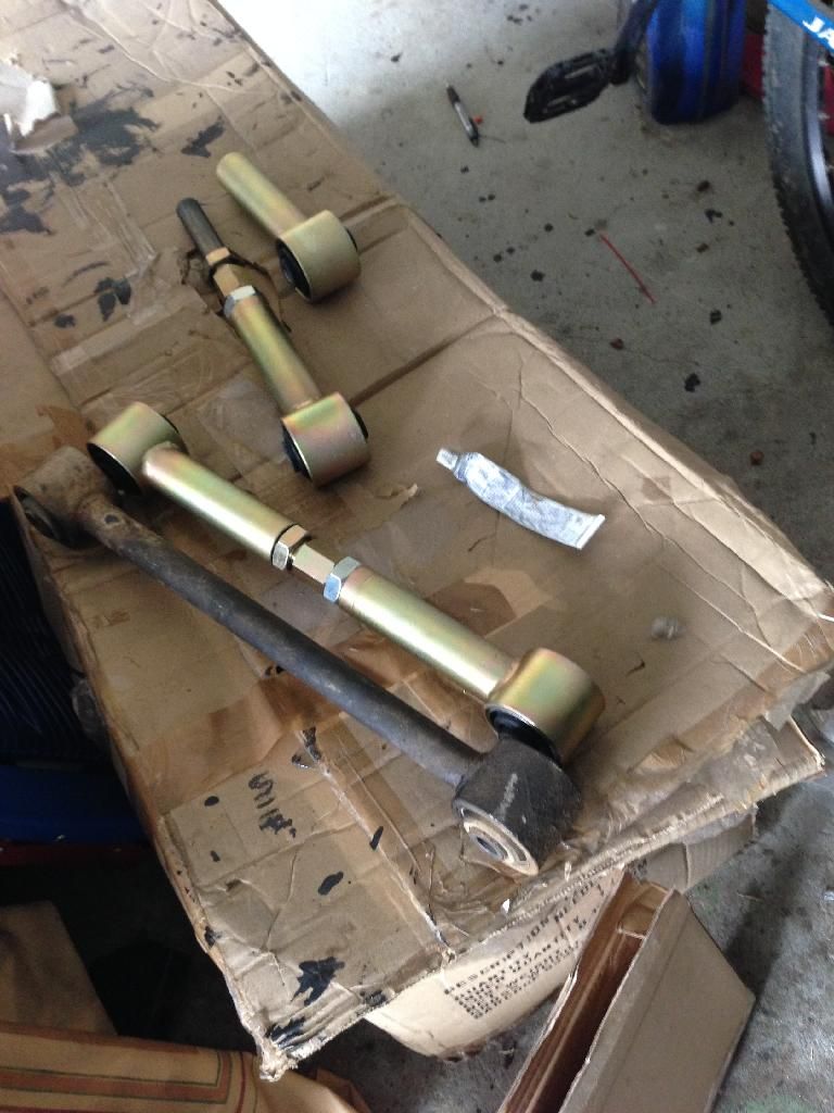

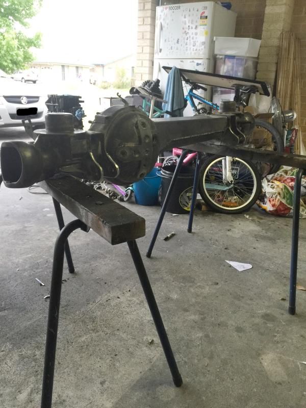

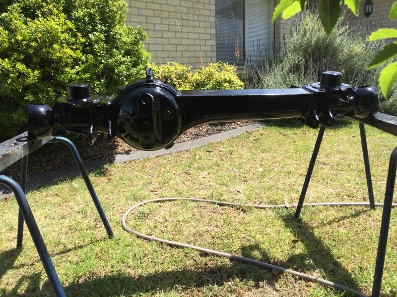

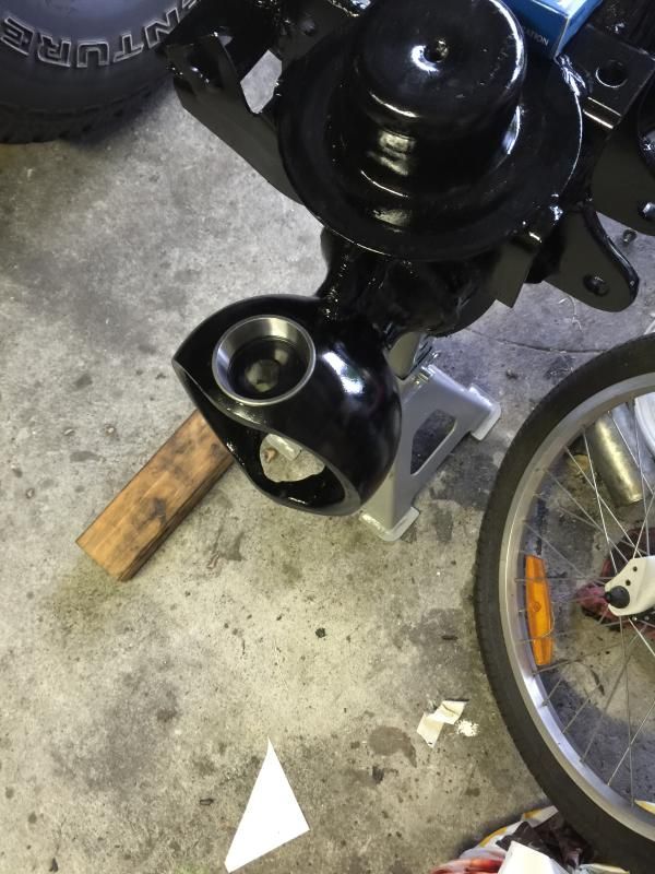

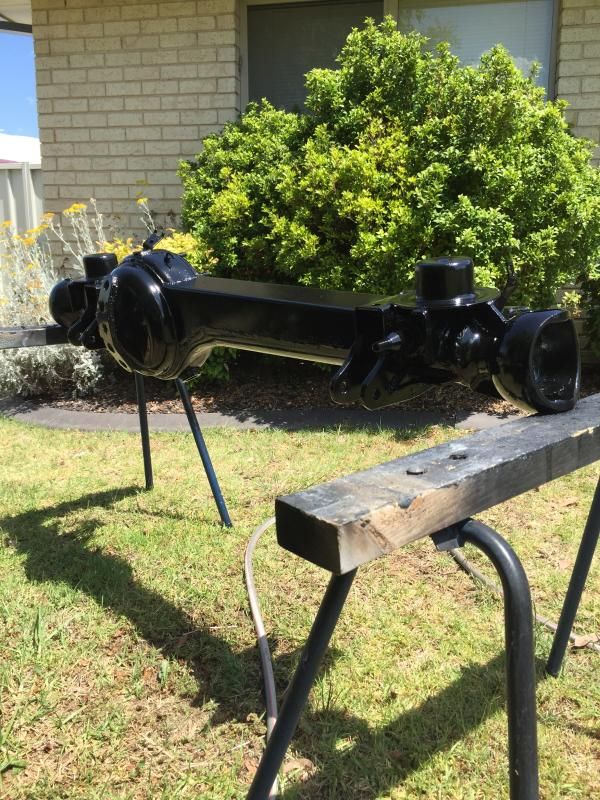

Getting there with the diff bracing...
http://img.photobucket.com/albums/v9...EE8CA08CB6.jpg
Hey Cameron
I did make another thread somewhere about how to weld it and I did get some very good replies on how to do it. I can't remember the specifics of it, I'll see if I can find the thread...
Edit, found.
http://www.nissanpatrol.com.au/forum...1-Welding-tips
Thanks Parksy (and also Macca86!). It all makes sense, but I thought it was a good opportunity just to take it in. Was pretty sure one of the pros would give some advice, as they did. Looks like it has come up fine for you too.

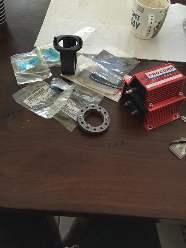

Couple of toys arrived today.

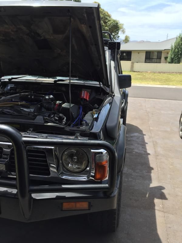

Installed new ignition coil. Got rid of the occasional miss I had at idle and revs much better.
http://img.photobucket.com/albums/v9...6711CC1310.jpg
It's the big red box on the firewall. Four nutserts and it's not going anywhere.

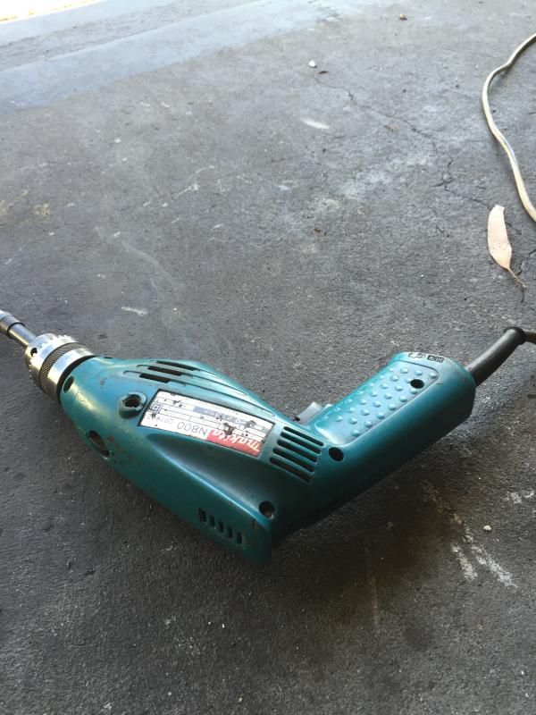

Killed my drill drilling the radius arm bolt holes.

Hard to take a photo of the smoke, but this was after a 5 min wait.
So desperate times call for desperate measures...
http://img.photobucket.com/albums/v9...64CD930A30.jpg
Had to remove the front of the press drill for it to fit... Bloody horrible job.
That does look like a 100% bastard of a job mate
Yep I hated every minute of it. Got quite good at sharpening drill bits though. And drilling through welds is a bitch. That metal is bloody hard!

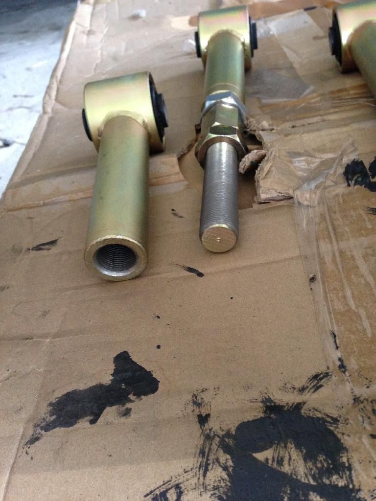

Bearing kit arrived today. Big box full of many little boxes. Was like Christmas.
Was keen to put a couple in...
http://img.photobucket.com/albums/v9...304FF3F6F3.jpg

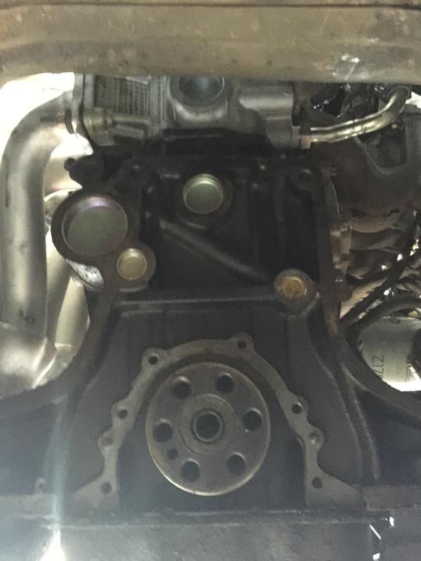

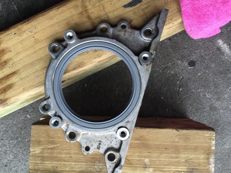

New rear main seal installed.
http://img.photobucket.com/albums/v9...BED617ABDE.jpg
Back of the engine without seal. Welsh plugs look in excellent shape.
http://img.photobucket.com/albums/v9...2F98341794.jpg

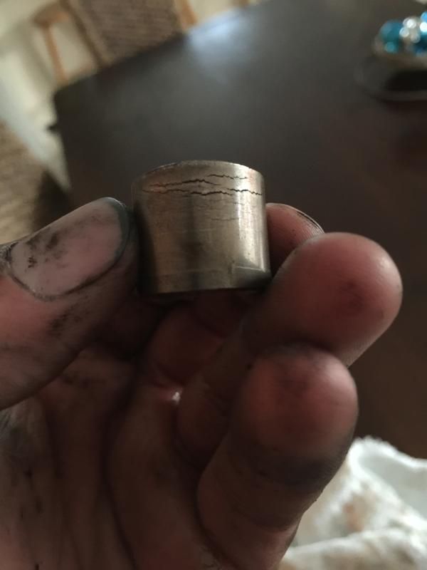

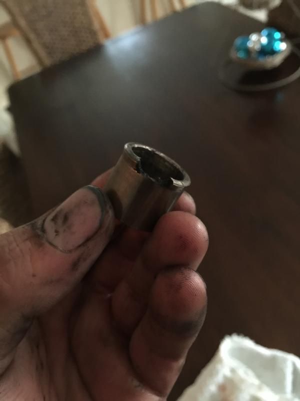

The old spigot bearing. Was making an awful hum when clutch was depressed. Was not the release bearing!
Used a 16mm bolt, a 4pound hammer and bread to remove. Worked bloody well.
http://img.photobucket.com/albums/v9...6DB8B45936.jpg

Old spigot again. Fubar!
http://img.photobucket.com/albums/v9...4A8C22C8_1.jpg

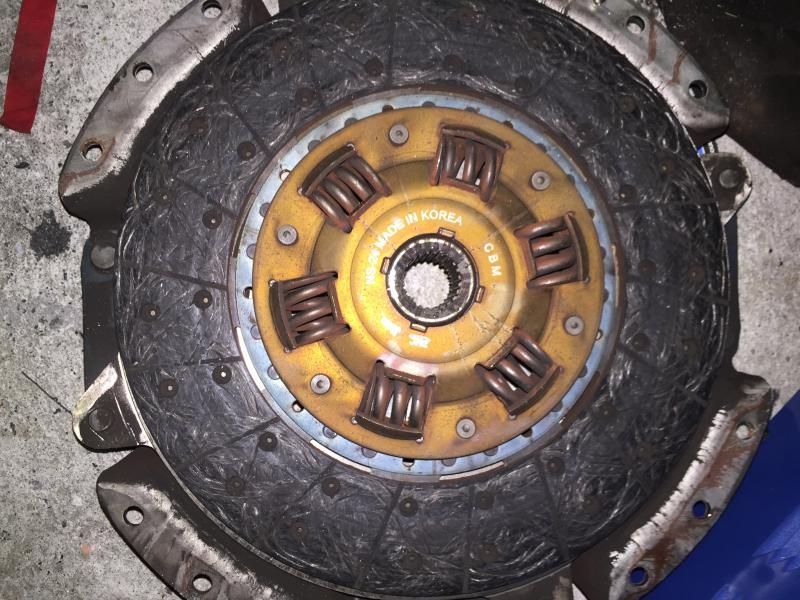

Old clutch. Anyone heard of this brand before?

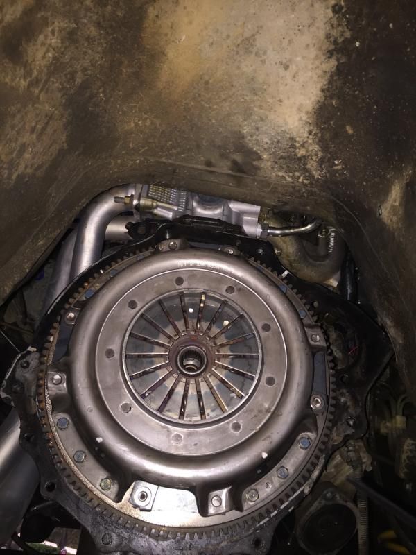

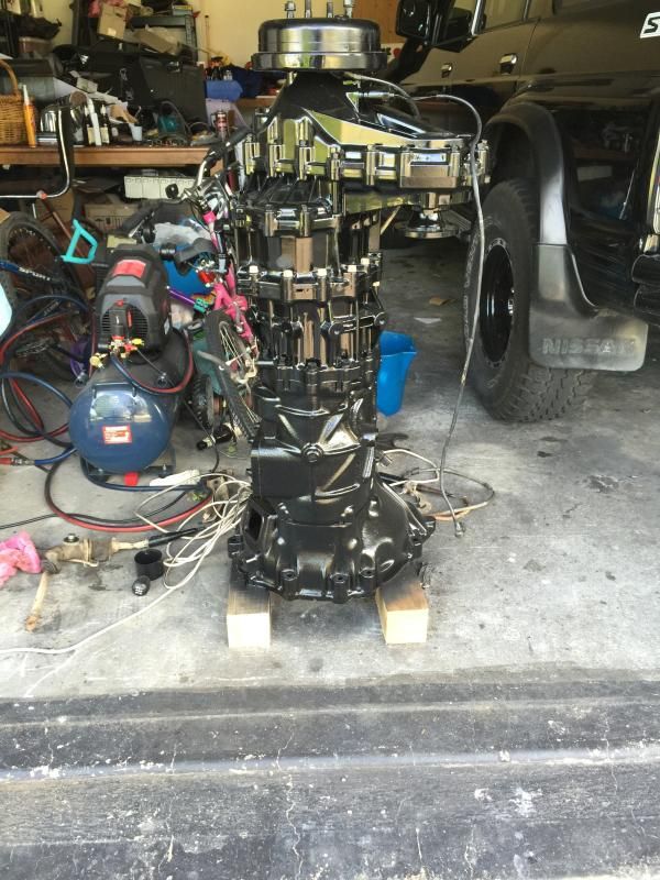

Week old exedy clutch installed. Better not let me down... Has been a hard day.
http://img.photobucket.com/albums/v9...4DF455B5E7.jpg

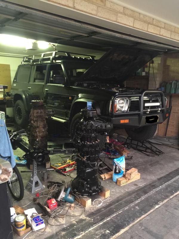

Should add, I asked a couple of mates if they wanted to give me a hand. All of a sudden, everyone is busy. Doing this solo.
http://img.photobucket.com/albums/v9...CF63698C31.jpg
How the hell do you solo a gearbox out and back in? Those bastards are heavy!
Lookin good.
Hopes and dreams and lots of swearing.
Awesome job Parksy, what is the paint you have used on the gearbox mate? POR15 or just a gloss black?
