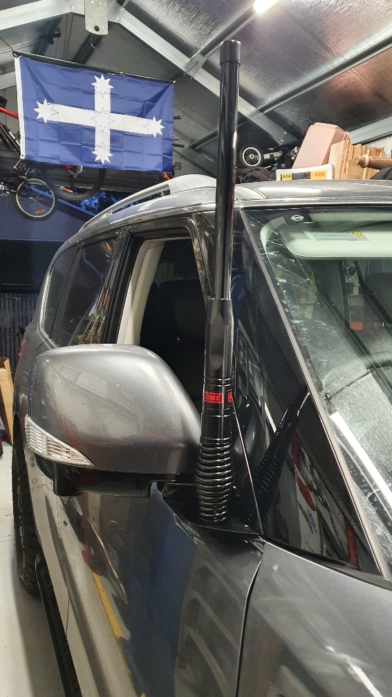

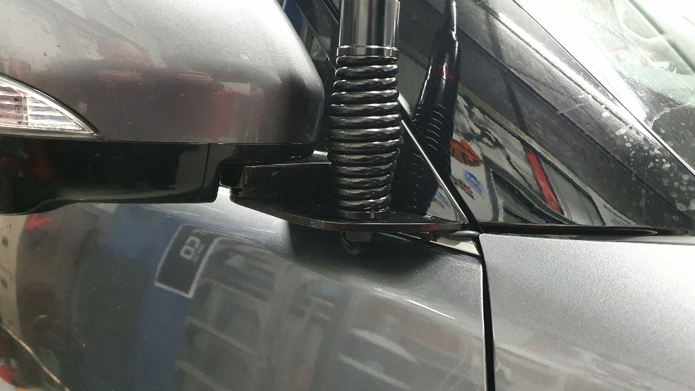

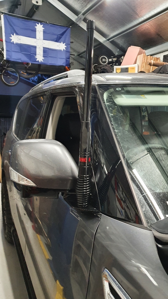

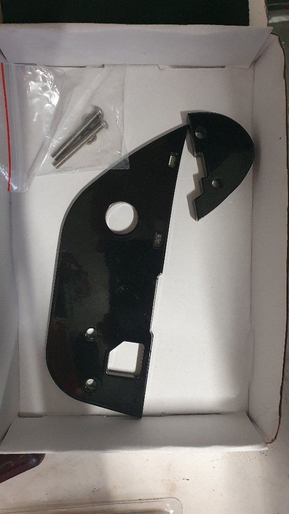

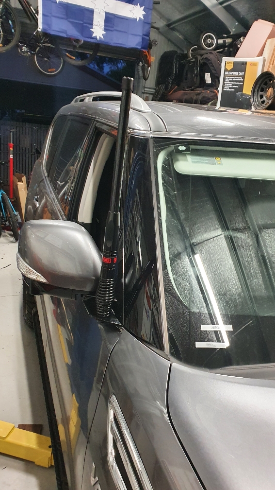

Well I just fitted a driver's side Vogue UHF Aerial mount. It came with no instructions which kinda sucked and the longer screws where 10mm Too Long and had to be trimmed. But Bloody Hell I'm living this position!!! I can't see it sitting in the drivers seat and there I no more looking through it off the bull bar. Stoked.

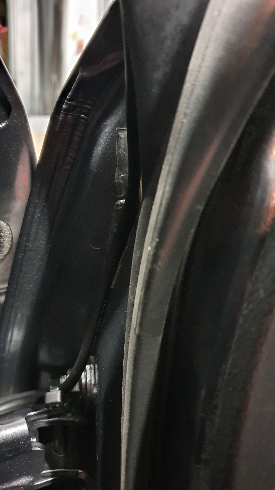

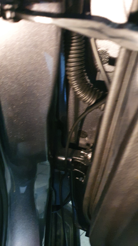

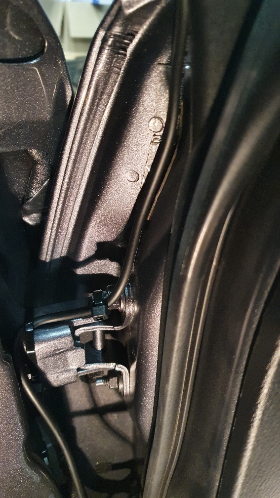

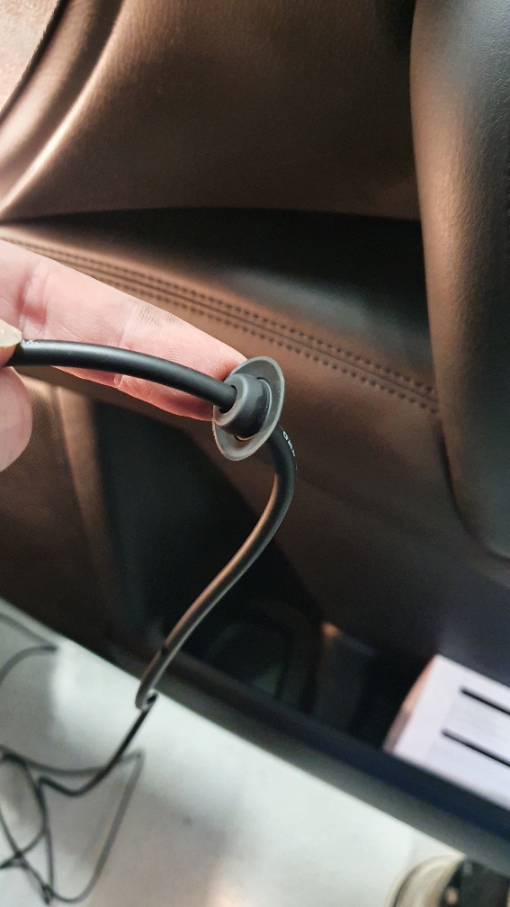

I uses HD double sided tape to keep the Aerial tight and tidy. There was a nice little grommet in the A pillar just under the factory loom which also worked a treat.

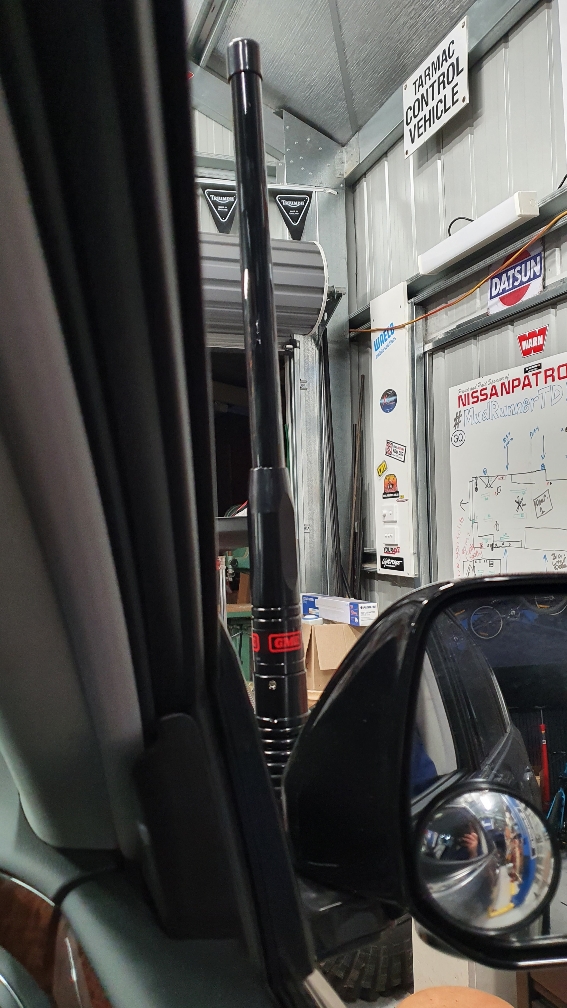

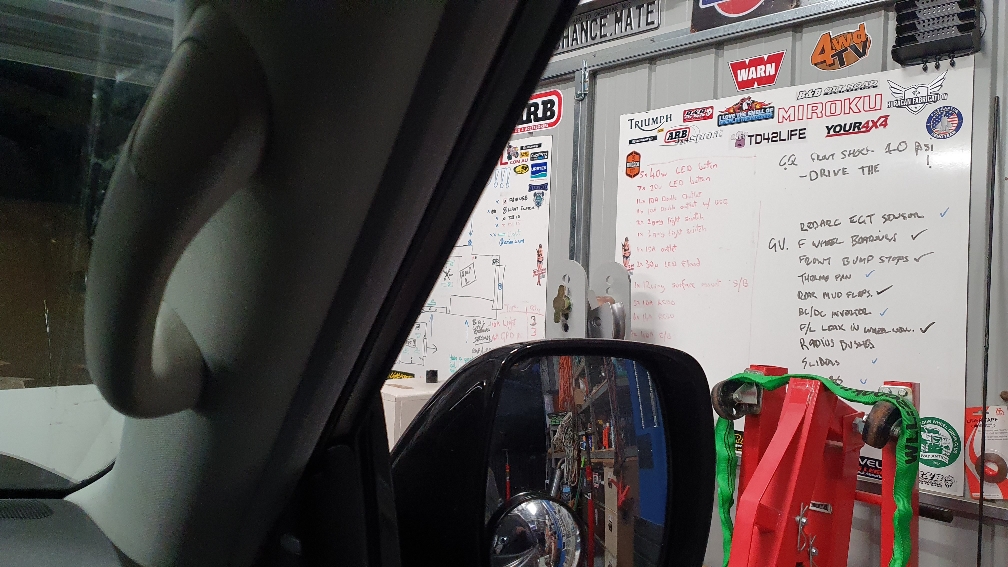

And from inside I xant see it unless I lean over.

I like how you have your own forum handle on your whiteboard in the shed. You big man child....
