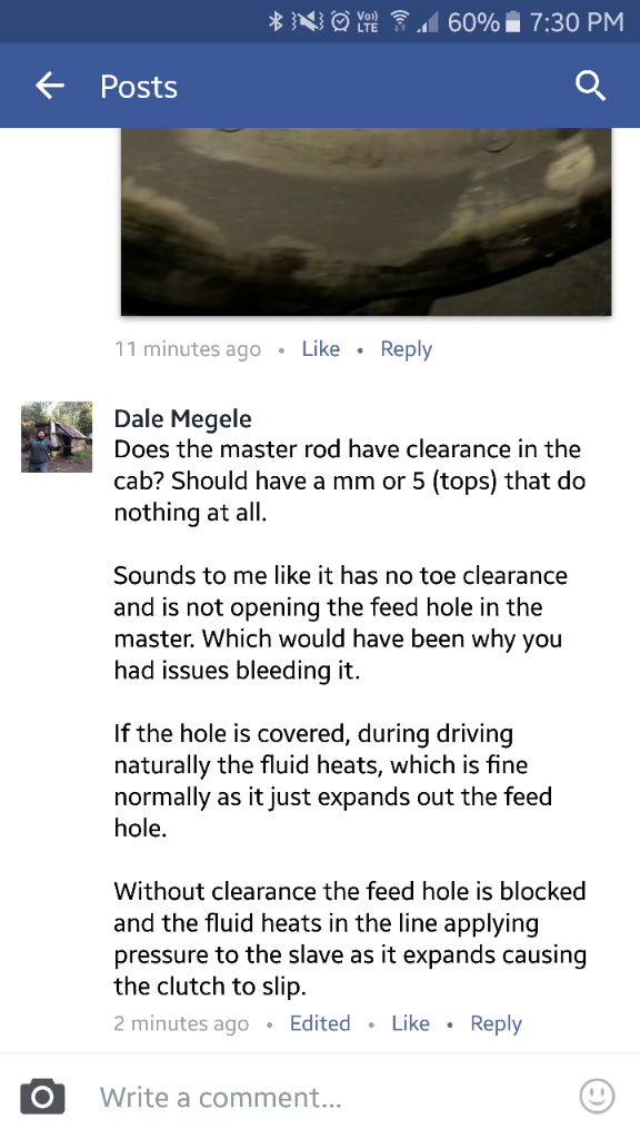

This was suggested on facebook

I just gave it an adjustment and took it for a drive and I "THINK" I have fixed it... Time will tell!
New clutch and everything else was needed, this problem only came about after the new clutch was put in.
