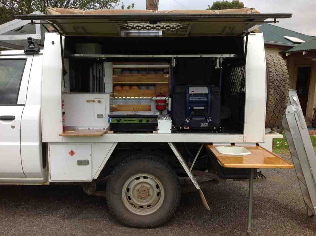

Time for another update. The 'kitchen' is now basically finished, just need to get the gas supply to the stove sorted. Bit of a hiccup with that though. I plan to have a gas bottle in the under tray tool box, like Telstra did, but with a bayonet fitting in it's side. To use the stove ..... pull it out & connect hose to bayonet fitting. The biggest size bottle I can fit inside the cabinet is a 3kg one...... BUT ...... an older type of 3kg bottle which is 235mm diameter & 300mm high ..... No longer sold in Oz as far as I can tell, but I had two out of date ones & had them sent away to be retested ..... & they've lost the bloody things. Grrrr. If they don't find them I may be restricted to 2kg bottles. Current 3kg bottles are 250mm diameter which is a smidgen too much to fit. Will get a frame made to hold two (hopefully) spare bottles under the tray behind the rear driver side mudguard. I have since turned up a 3rd out of date suitable 3kg bottle which needs retesting.
Anyway, enough about gas here's some of my woodwork.

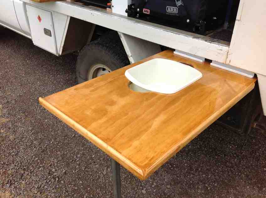

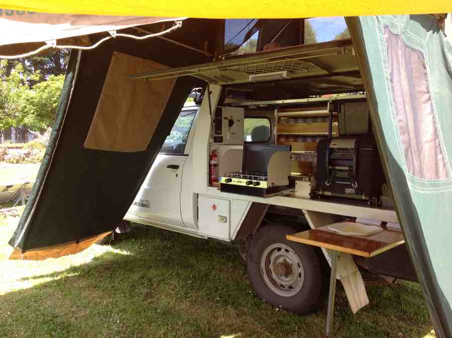

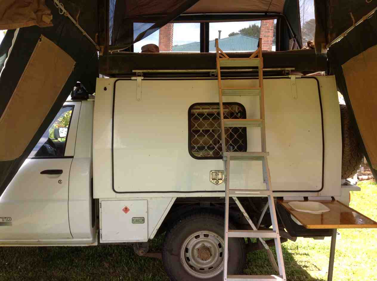

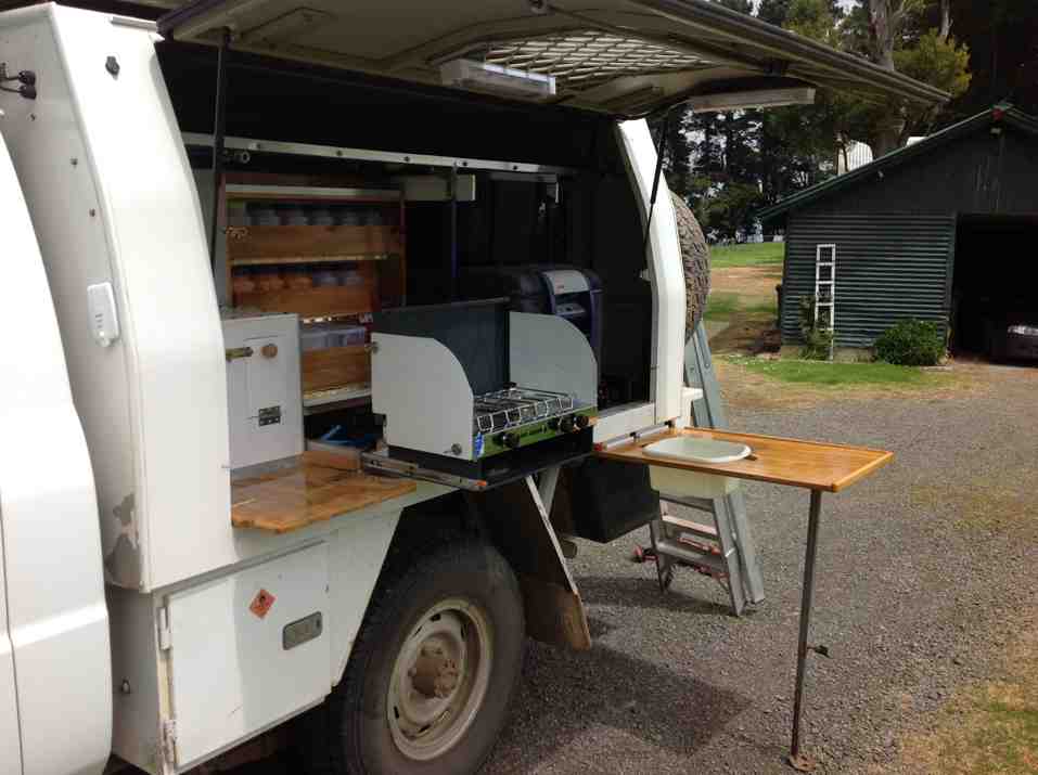

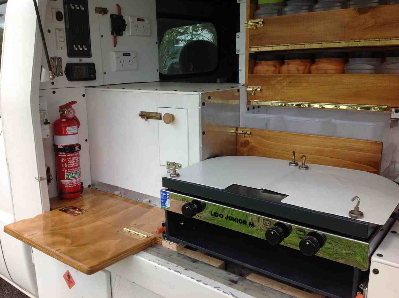

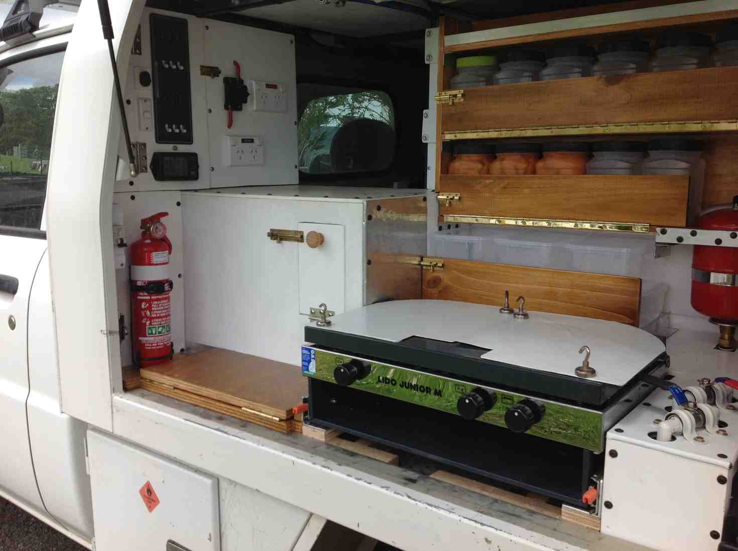

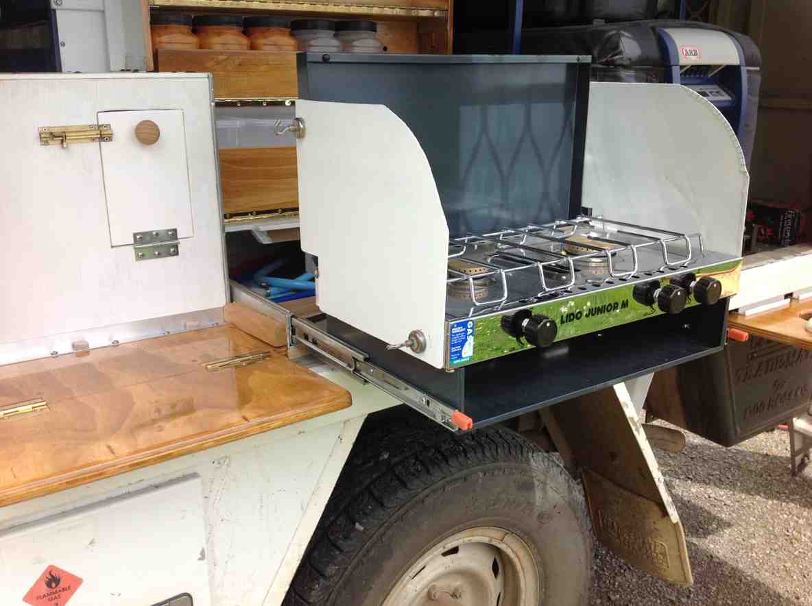

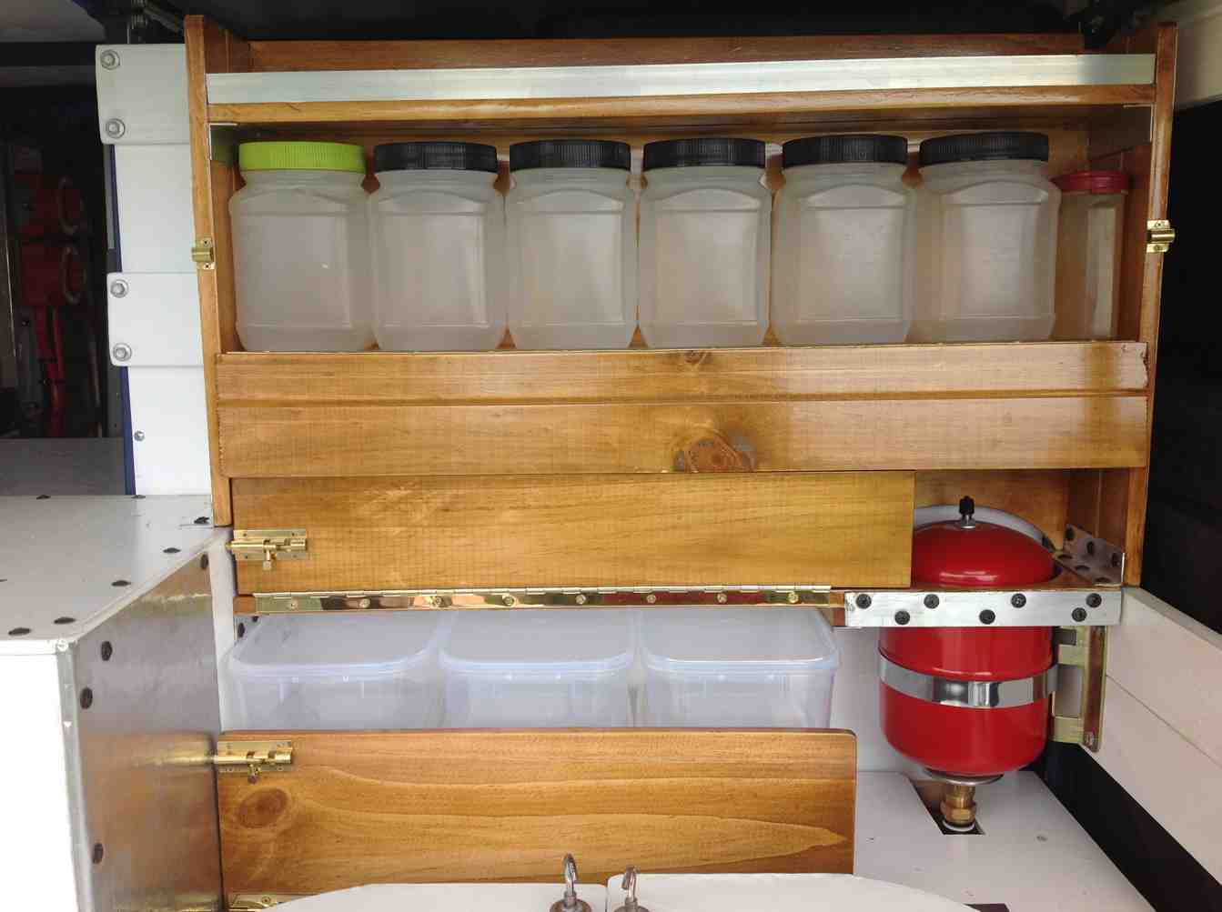

Small worktop to left of stove folds out. Table with sink has telescopic leg with 'peggable' foot. Table clips to side of vehicle in a couple of seconds & leg fitted afterward. There are hot & cold hose connections under the tray to supply water to bowl ( or shower). Stove slides lock in both in & out positions, & complete stove can be removed in moments. (We have a second tent & may sometimes cook inside it when, for example flies/mozzies/sand flies are unbearable). Normally though we only expect to be under the awning that the rooftop tent provides. Stove wind guards (made from the sides of a dead microwave oven) are held on with rare earth magnets. Shelving for commonly used foodstuffs were sized to fit the containers, which are the 1kg 'SPC' plastic fruit jars. These are very durable ( have used them for years in our bus) a good shape & cost around the same full as many empty (& less useful shape) storage containers. Having the lid a bit narrower than the body of the container makes it easier to build storage where they won't move around on rough roads. The peaches are lasting us a long time though! :-). All other food will be stored in the fridge, freezer & the larger plastic bins. Remember it is our hope to eventually be able to go bus for a month or two at a time.
