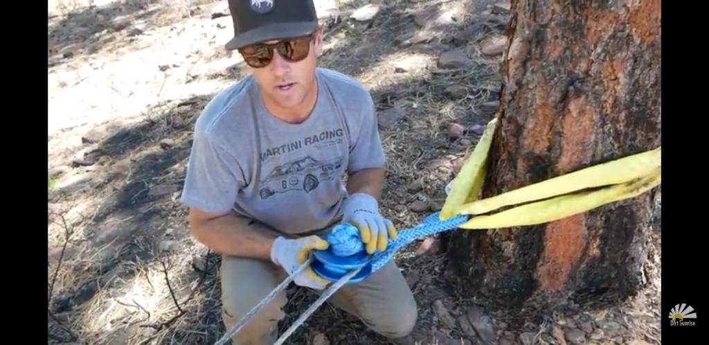

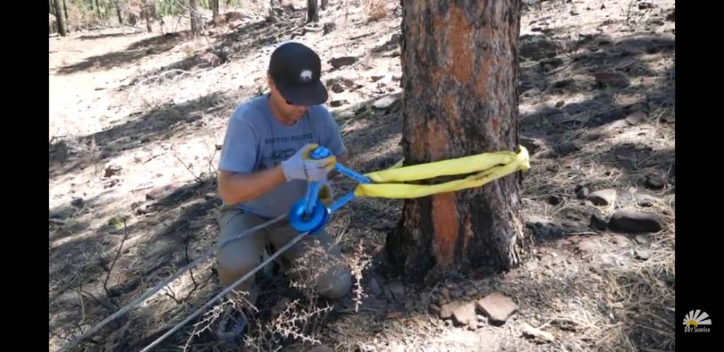

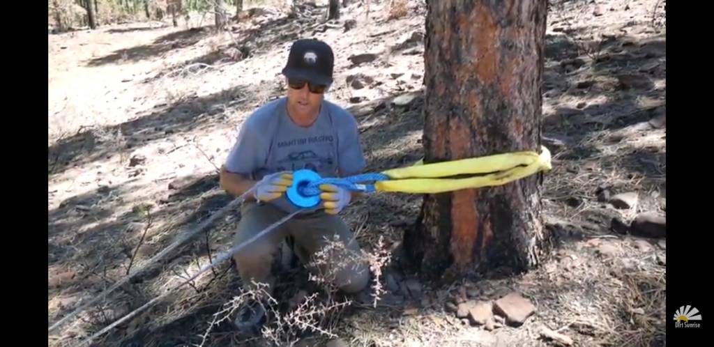

Here are some screen shots for your interest!

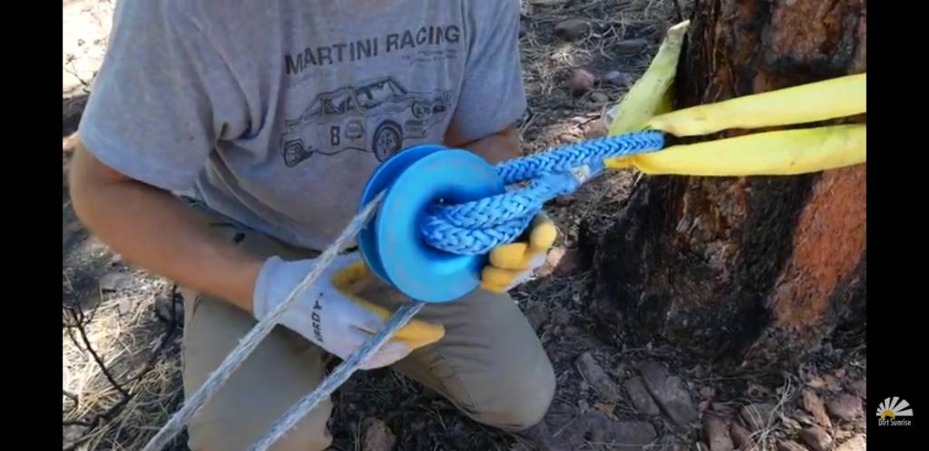

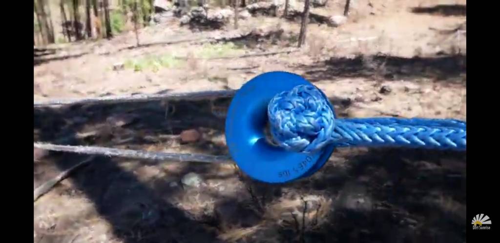

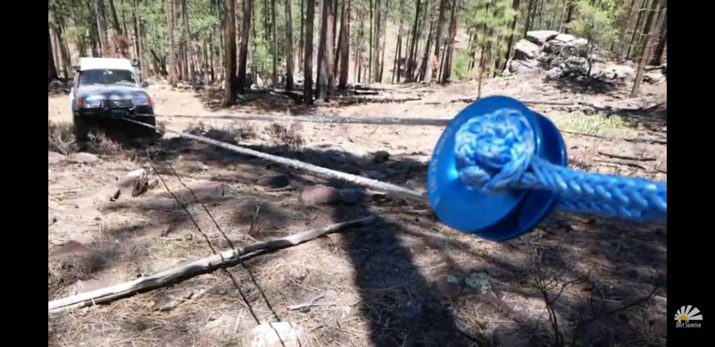

Here is some application pics. Last 2 minutes of the vid. A great interview though gents.

All good mate. The weakest link in the soft shackle is the eye around the knot. Regardless of its use that never changes. Considering this, how you set up the soft shackle when under load is important. Rather than trying to pull the back off the knot you fit it so the knot is near the load and trying to pull through. Much less load here.
So dyneema is very very slick mate. With the ring spinning slowly around the soft shackle there will be very little friction. They discuss it a little in the vid. A winch recovery through a snatch block or ring is half speed of winch. So slow.
Assuming your soft shackle is clean and the ring is clean then there is no dirt to cause damage. Your winch rope is not slipping through, it is rotating. No friction .
If under an extraordinary event the ring failed and the rope came out from over it it would be caught by the shackle, it is looped through the shackle. This is a bonus.

You can see here how it would spin as a dry bearing. If it did not spin then absolutely the original concern would be true, the dirty winch rope would slip around and act like a saw blade and slice it in half.
http://www.nissanpatrol.com.au/forum...019/05/320.jpg

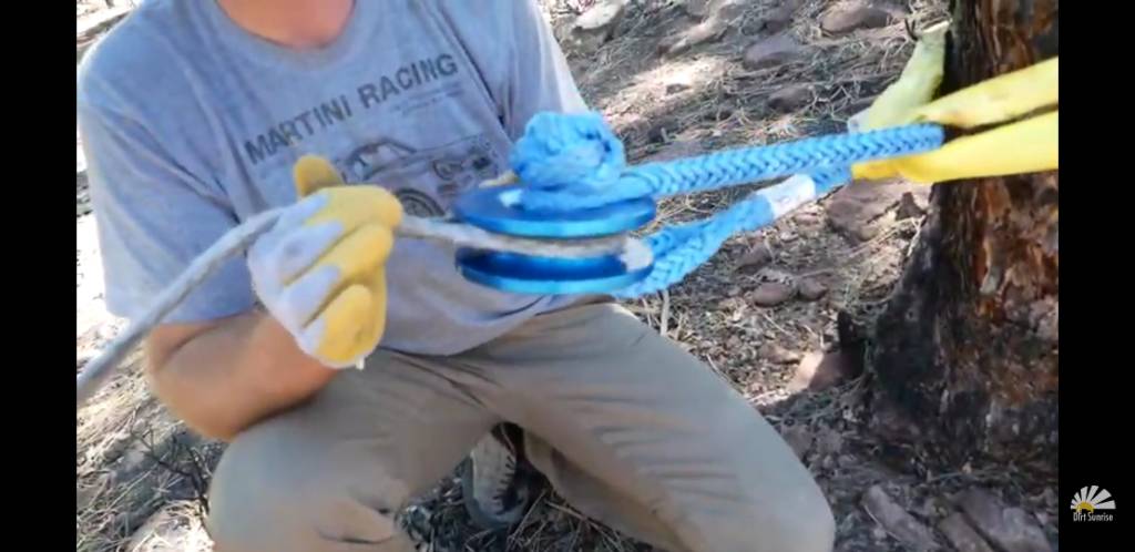

But in operation see how the knot of the soft shackle is positioned. Not trying to pull the head off the knot backwards.
http://www.nissanpatrol.com.au/forum...019/05/321.jpg
http://www.nissanpatrol.com.au/forum...019/05/322.jpg
The weakest part of the soft shackle is the loop because it is the thinnest. It is the size of the single rope, in this case 12mm dyneema. (Strong), what makes it weakest is the diameter of the bend around the rest of the rope, (at that point its 2x 12mm rope). By positioning it in this way the knot takes a fair bit of that stress.
