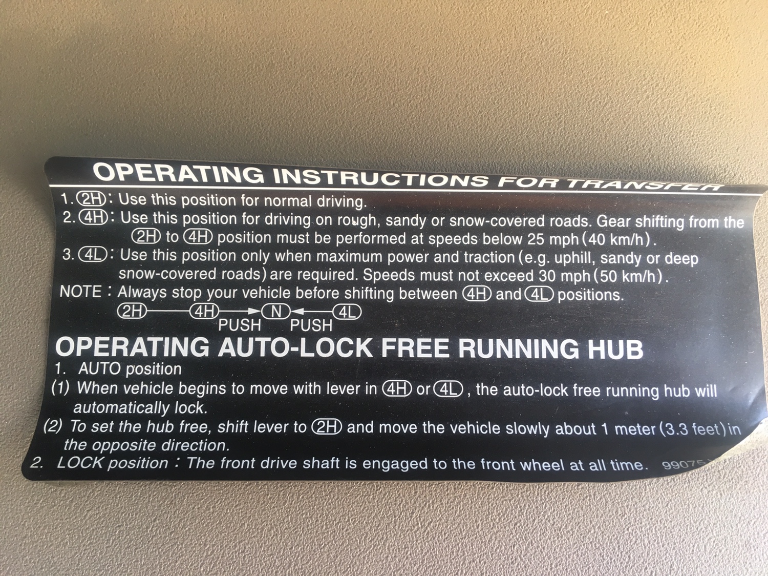

Just noticed yesterday the warning sticker under the visor of our stock 2001 GU TD42T family wagon, yet to install these great reduction gears.
http://www.nissanpatrol.com.au/forum...018/12/349.jpg
(4L) Must not exceed 50kmph it reckons so ran a few gear versus fully stock drivetrain tests on the old bus.
4L 3rd gear = 3,500rpm ish
4L 4th gear = 2,500rpm ish
4L 5th gear = 2,200rpm ish
I’m only assuming now it’s roughly those ‘TD42’ engine rpm’s per gearbox selection choice that we need to keep under for transfer case health and possibly not the 4th & 5th gear warnings I was once campfire Babbel given before?
Would this below be roughly speed calculated up @PeeBee mate or have I got it arse about upside down again mate. Maybe it doesn’t matter with the final drive reduction gears?
50kmph @ 85% reduction = 7.5kmph
50kmph @ 63% reduction = 18.5kmph
50kmph @ 43% reduction = 28.5kmph
50kmph @ 24% reduction = 38kmph

One last honest quandary bugging me on our GU stock sticker warning.
Transfer case is safely engaged say stationary from 2WD to 4WD High Range (no ongoing drivable max warning listed, speed and or rpm)
Snot along Fraser Island beaches as you choose? (80kmph max open beach legal limit IIRC in the day)
Transfer case is then safely engaged to Low Range and a definite warning is listed.
There must be something in that mate, almost has to be LR stuff spinning harder and to take greater care of mate?
OK, I think I understand what you are concerned about.
There are a couple of fundamental parameters that affect gear life and strength, rotational gear speed, tooth size, tooth width, material of construction, engagement width, hardness, lubrication and tooth finish. The gearbox gears are sized predominantly against torque rating, so the first gear is designed to transmit the greatest torque at lowest speed to get moving, within the applied power and is the largest gear. As you move up in gears the torque is reduced on the gear set itself until you get to the 5th or overdrive where the vehicle has greatly reduced requirements because it is already now moving quite quickly and has inertia and kinetic energy as well. It is then apparent that this 5th gear is the 'weakest' gear in the drive train. (you might recall the failures within the Toyota 60 series gearbox when they moved from a 4 speed to a 5 speed - predominantly caused by a 5th gear being sized to fit within a preexisting gearbox instead of modifying the gearbox size to allow for correct gear design sizing)
Then if you take that gear train and stick it into the back of essentially another reduction gearbox, being the transfer case, what happens in the situation of driving in 4th and 5th? So, the warning no doubt is related to how much hp is being transmiited, and torque from the motor thru the weakest gearset. So 4th being 1:1 and 5th O/D being say 0.85, I can see potential for gear set overload in the gearbox as a reaction to the vehicle drivetrain now increasing torque on the output shaft of the transfer case, especially in say a deceleration condition or jolting. Imagine this picture. 100kw motor, running thru a final 5th gear inside the gearbox, that is 1mm wide, then driving into a transfer case that is designed for high torque and has 50mm wide gears. You are cruising along at 50knhr on the sand in 5th low and hit some deep sand, which puts an instant load on the vehicle because its kinetic energy is now being strongly resisted by the sand, however your motor is trying to work against that at full torque because thats why you are in low range, for max torque output, so your hard locked up drive, assuming there is no clutch or automatic transmission involved where you can shear/absorb the change in energy, transfers through the drive and where the forces exceed the mechanical design capacity of the element, you will break something, in this example the 1mm gear will get damaged.
I think this is perhaps the limiting rational. I could pull the books out and work this through but its been 30 years since i designed a gearbox from scratch and it would take a bit of a headscratch to be honest. In summary, the designers want you to preserve the drive train by not exceeding your gearing design parameters, not only from a motive power perspective but also a resistive load from what you are driving in. (you have generated torque and resistive torque or reaction taking place) Logically you would not select the weakest gear to drive into a reduction gearbox and expect it to last, as opposed to a high torque capacity gear into a high torque condition - this will last, but relates to a reduction in physical speed and generated energy or inertia. Pretty heavy at 3.50 am MB, I think thats correct.
