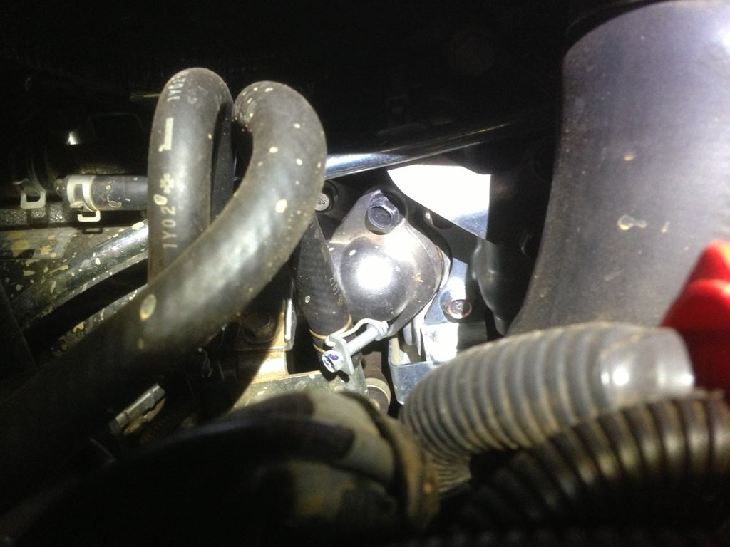

Does anyone have any pics of where the blanking plate fits on CRD?? There appers to be 2 places it could go from what i can see.
Do a search mate, there is a few threads around with pics
All the stuff i keep finding is for a Di
Not the best pics but hopefully give the idea
http://www.nissanpatrol.com.au/forum...013/04/170.jpg
http://www.nissanpatrol.com.au/forum...013/04/171.jpg
Cheers, ill check it out today :)
to put the EGR block in, do you remove the two hoses in front of it ?

CRD don't need NADS, the egr will circulate exhaust gas with particulates into your intake over time building up and restricting flow. Blocking egr stops this from occurring, it also reduces the annoying lag when you put your foot down.
To install you remove plastic shroud and intercooler. Then there is little bracket with couple of hoses attached to the egr pipe, remove bracket to enable hose to be flexed out of way. Then remove bolt on other side of egr tube where it bolts onto engine block. Then you can remove the two bolts that attach the actual tube to the intake into manifold. Blank goes in here I put gasket back on intake side as would prefer small amount of exhaust has leaking into engine bay then losing boost out the intake.
Takes about half hour to put in.
