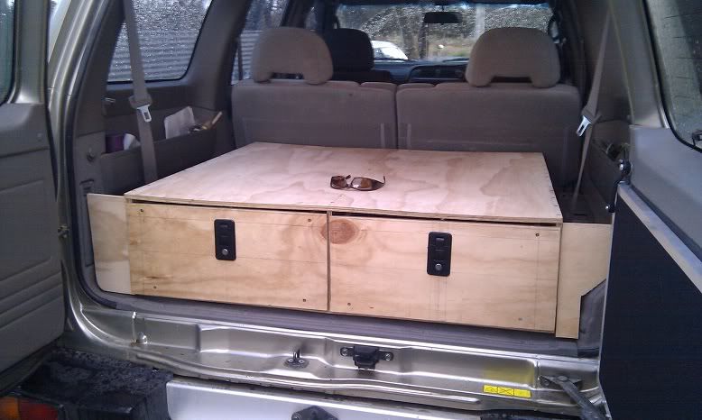

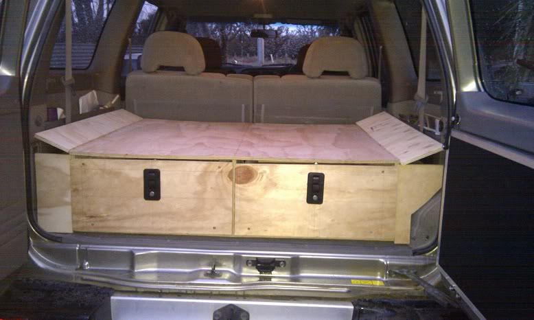

i have wanted to make a rear set of draw's for my GU for a while. I reckon i could make a set for about $500 (as opposed to the $2000 odd to buy a set).. I will be posting pics throughout the build and hoping to have them complete by the weekend..

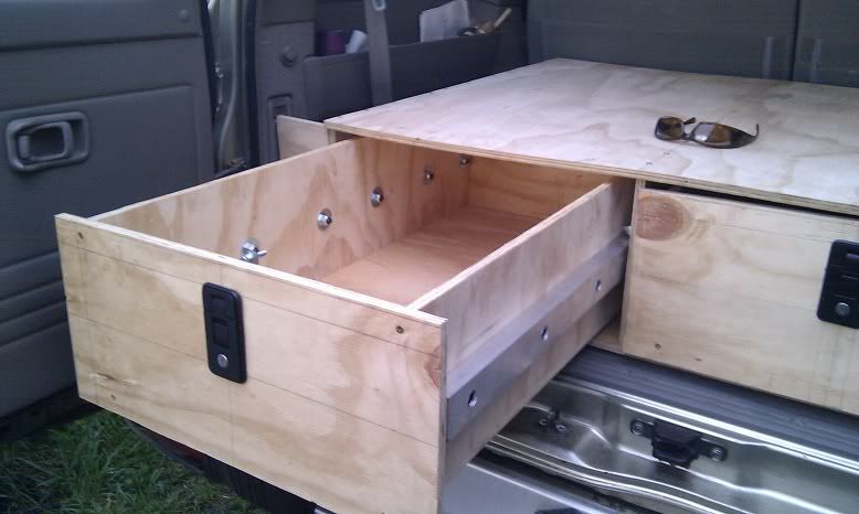

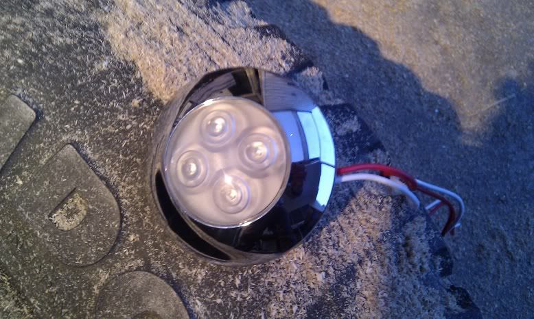

I will be making them out of 12mm Ply, fully carpeted with Roller bearing draw slides. I will also be hoping to add an interior LED light to each draw so when opened at night i can see into the full length of the draw.
I have taken a few pointers from Rohan (Plassy's) set of draw's after having a good look over his home built set at last meetup (Thanks Buddy) lol:smiley_thumbs_up:.
If anyone has been looking at building draw's for their troll, stay tuned!
