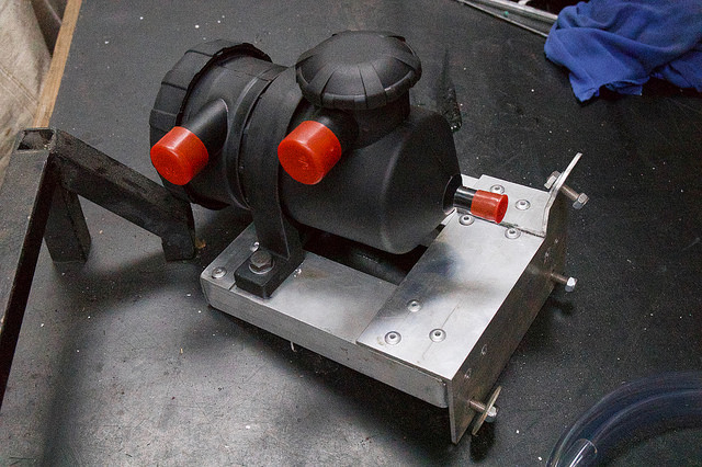

Nevertheless I have now bought one (a Provent 200 copy) & have spent this arvo making a bracket to hang it from.
