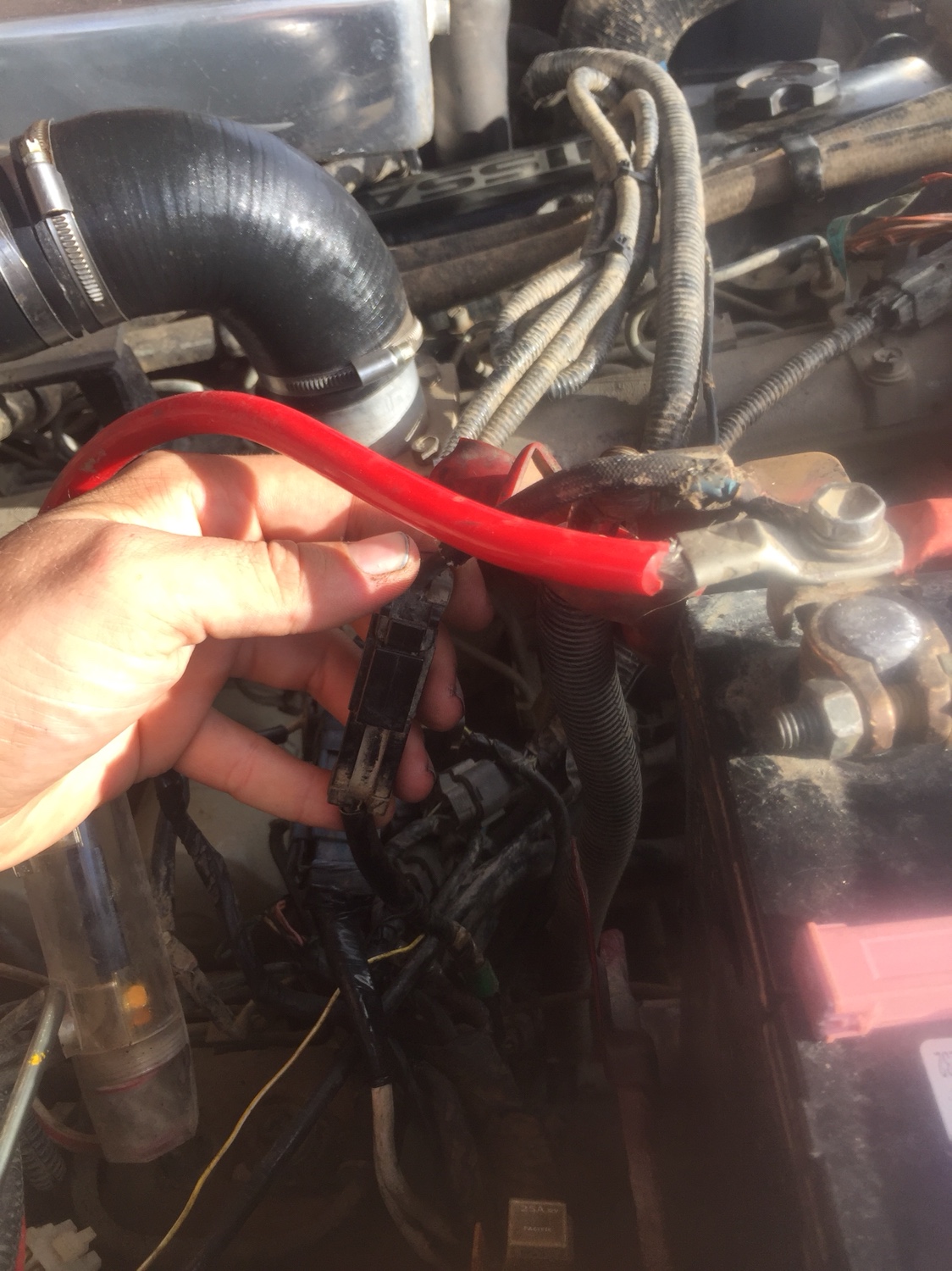

I’ve just installed a new alternator, before starting the install I removed earth strap off the battery, I installed alternator and went to put earth back on battery and it sparked the the positive side had some smoke,
Now I have no power at all.. I’ve been through all fuses and found a 10amp from under dash blown so I replaced it. It was for eng cont
It’s a td42 converted using all Tb42e wiring, there is one wire that goes to the battery that controls everything power wise but I don’t know where to look for fuse or relay that’s directly to that wire.. if anyone can help me shed some light on what happened that would be great! I’m going a little bonkers 😅
