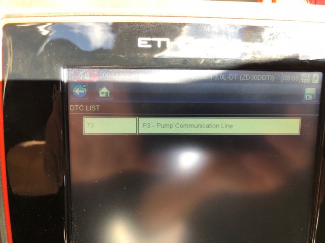

Showing error code 73
Pump communication line

Was showing all these before but do note the maf was unplugged and the plug to the injector pump was unplugged
Not sure why it was showing nats error
http://www.nissanpatrol.com.au/forum...2018/03/36.jpg
Only fault showing now is 73 pump comms line
