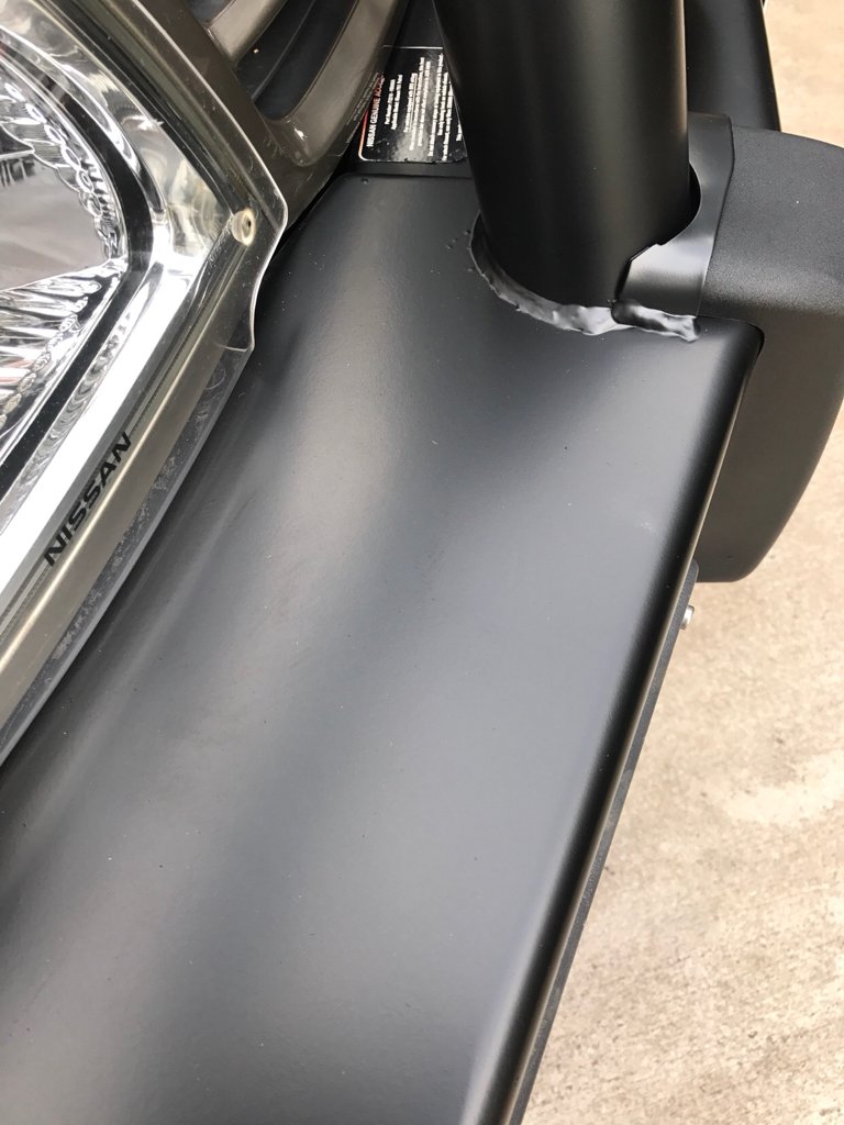

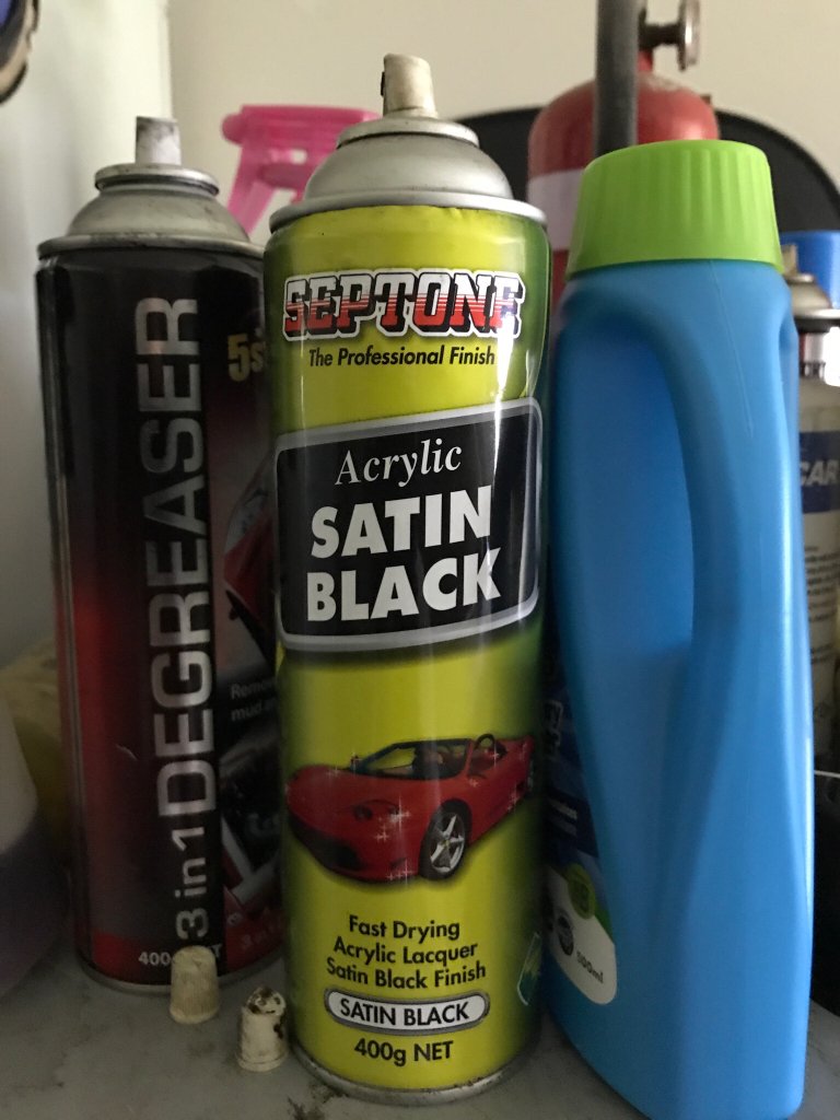

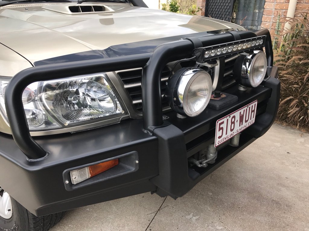

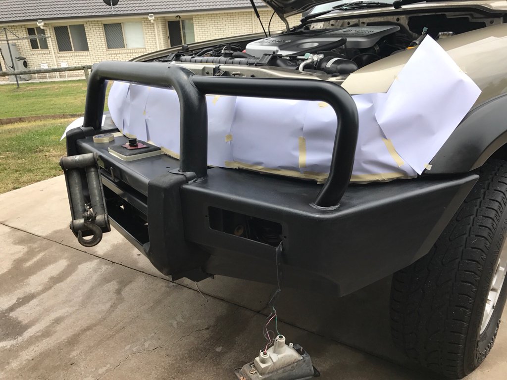

Powder coating is the best, but was out of my budget, so I gave mine a rub down with wet and dry http://www.nissanpatrol.com.au/forum...2018/01/30.jpg
And gave it several coats of
http://www.nissanpatrol.com.au/forum...2018/01/31.jpg
Leaving plenty of time between coats and it turned out like this
http://www.nissanpatrol.com.au/forum...2018/01/32.jpg
http://www.nissanpatrol.com.au/forum...2018/01/33.jpg
That looks great, good job
