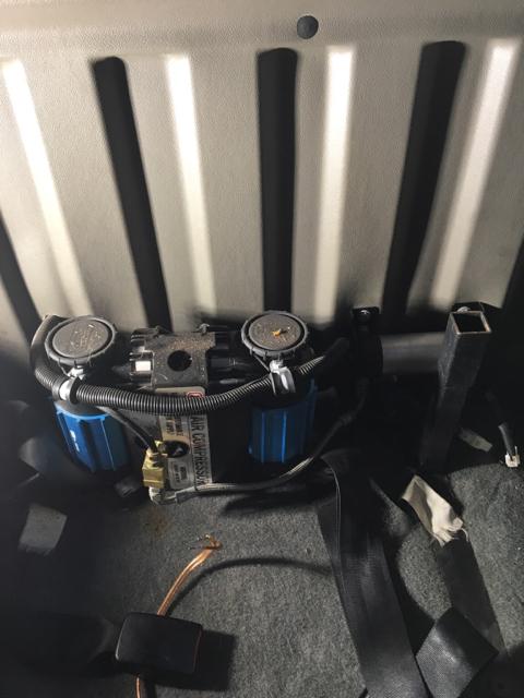

Very keen to please learn more here of your specific brand experiences blokes. I ran ARB's 15+ odd years ago thrashing without any dramas and now finally back in the HC climbing game have chosen ARB again. Last weekend we found my somewhat installed downwards compressor/tank plumbing was intermittently moisture/freezing the ARB solenoids and seriously 'wacking' until a final air stop of the 'bolt' I guess :-( ?
I know it's supposed to be a 'Prolocker' query thread but just thought I'd put this here as my findings today would affect all air activated lockers I believe.

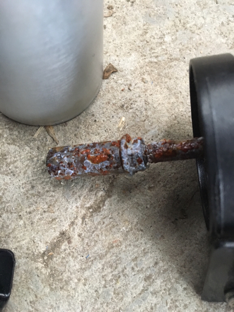

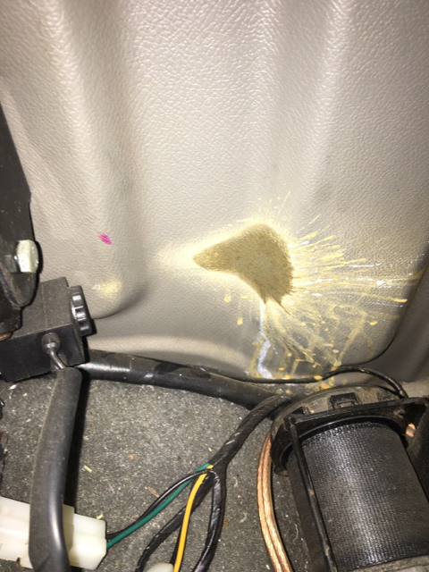

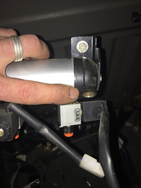

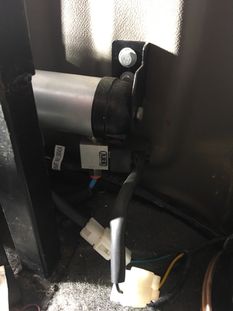

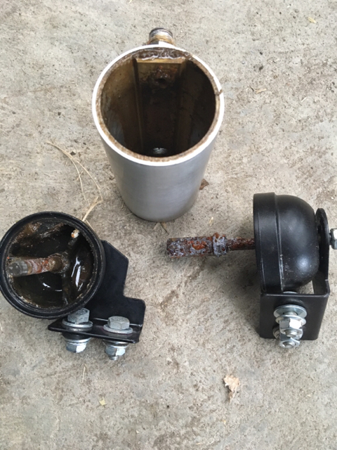

After last weekends debacle removed the rear cab seat for a closer inspection on @matfew 's upside down trackside correct diagnosis. http://www.nissanpatrol.com.au/forum...017/06/104.jpg The ARB solenoids were below the pressure manifold. http://www.nissanpatrol.com.au/forum...017/06/105.jpg Matfew whilst inspecting again on day 2 kindly ripped out the diffuser's which got some action back again. http://www.nissanpatrol.com.au/forum...017/06/106.jpg The manifold needs a full 180 rotation to have its drain bung lower than the solenoids and better maintenance by silly old me. http://www.nissanpatrol.com.au/forum...017/06/107.jpg http://www.nissanpatrol.com.au/forum...017/06/108.jpghttp://www.nissanpatrol.com.au/forum...017/06/109.jpg Long story short, ripping the whole lot out now and remounting correctly up higher where it can be friggin accessed and adding an easy maintenance water trap bowl etc...
