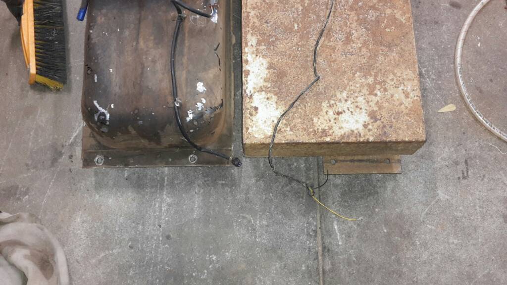

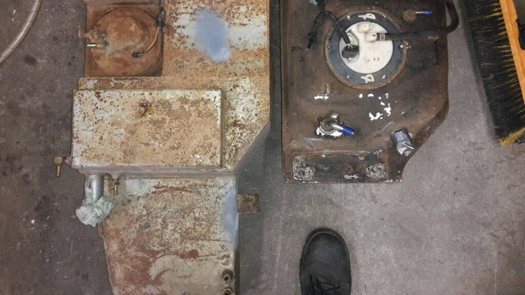

I'm looking at doing b the same..
Unfortunately it's not a simple swap due to floor differences..
From initial looks the gq tank had a top peice that is the expansion area..
The stock gu don't have this..
So I'm thinking that's why people say the fit if you have a body lift in to fit the gq Long Range tank to a gu..
I plan to remove mine..
I'll also insert the fast fill breather a touch lower to allow expansion..
But this is reducing tank capacity.. so it may only be 70l in the end..
