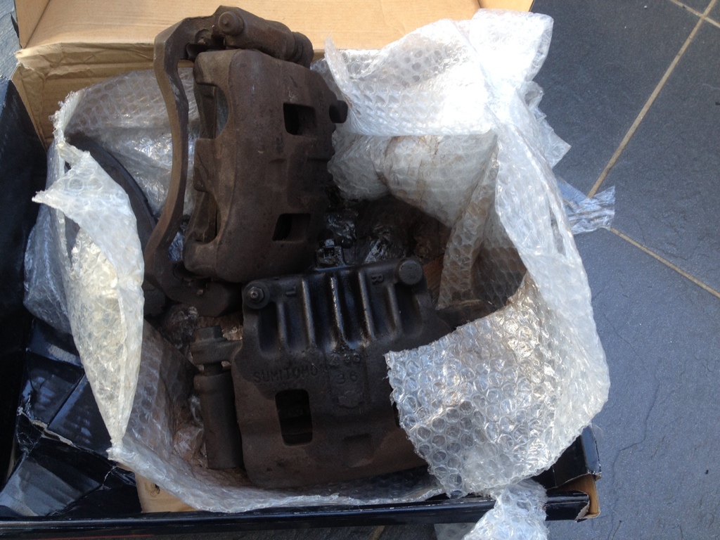

All the oils have been changed (somehow they squeezed 8 litres of oil into the front diff!)and the only thing left to replace is the brake fluid, but its still pretty good (had it tested). I will be getting new disks/pads and braided lines so it will get changed then. Going to rebuild the front swivel hubs and do wheel bearings while I am there.
