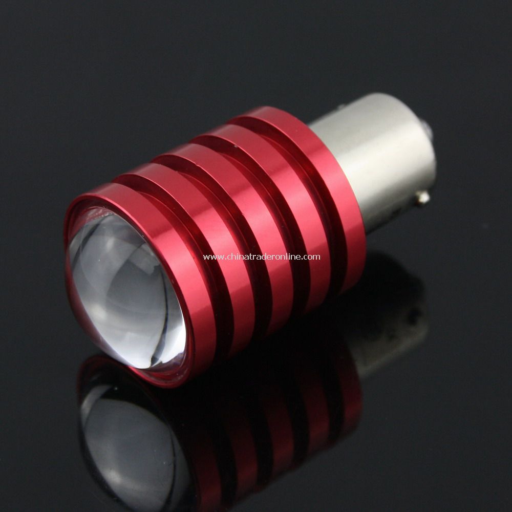

@THREEDOGS you'd be better off with this type of globe for your reverse light, much bright than the type you're showing. This is a 7W LED.

Yeah like them but they have a cut off point like projector lights. I have them on my trailer very impressed

They shouldn't have a cut off line, could be the housing you've got them in.
