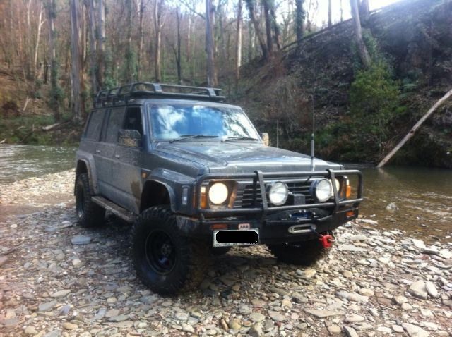

It's been a while since I've been on here and even longer since I've spent money on the patrol! But the finances have recovered after the new bike and its time to make the rig what I finally want.
This thread is to just show my basic GQ, but I want to use it as motivation to keep me moving forward, otherwise I lost interest and it all fizzles out.
I've never been an extreme fourby person, so it suits my needs how it is, and once I do a few more things it will be the perfect car for a few years to come. As it sits its a TB42 EFI on gas as well, and it shits me to tears, anyway, the mods:
- Dobinson 3" lift with suspension stuff shocks.
- Arb delux winch bar, side steps (they are terrible) and rear bar.
- Tigerz 12,000 pounder with rope
- IPF driving lights with cheap HID conversion
- Roofrack
- Rear LED's behind spare
- 33" MTZs
- Alloy airbox, 2.5" exhaust and extractors
- Alpine head unit, amp and sub
- UHF and water temp gauge
- Waeco CFX when out and about
Pretty much a run of the mill GQ.
The to do list:
- Build my diesel and freshen the spare gearbox I have to put in.
- Sliders and snorkel (once I decided where my new airbox will be going).
- Dual batts
- Possible front diff lock
- Theres more but I can't think of it and will only happen as funds present
- Sell off the gas system, engine and gearbox and go back to a long range tank and sub tank.
Just set it up for a bit of long distance stuff and still be cheaper than me buying a 4.2 gu. The specs for my new engine will be:
- Silvertop TD
- PPM H beam rods so I can fit 30mm gudgeons and late model pistons
- Late model turbo pistons, ceramic and teflon coated.
- United fuel injection TD05 18g turbo
- Unsure who will do my fuel pump and injectors as yet but most likely 11mm with boost comp, will discuss needs of 12mm and how much fuel economy I'll lose
- DTS low mount manifold to keep space to a maximum
- Will decide on intercooler setup as I get closer to completion
- 3 inch exhaust with some sort of muffler to keep sound to a minimum at 100kph.
All my research is finally getting put into motion. It's been a long time coming.
Once that is all done, it will be a good rig that I can cruise long distances in and not have to fill up at every servo i see. Then go and see some of this country.
http://i1206.photobucket.com/albums/...ps947932c1.jpg
http://i1206.photobucket.com/albums/...psb9783a3f.jpg
http://i1206.photobucket.com/albums/...ps929c06e4.jpg
So there the dirty troll is, keep me motivated!
