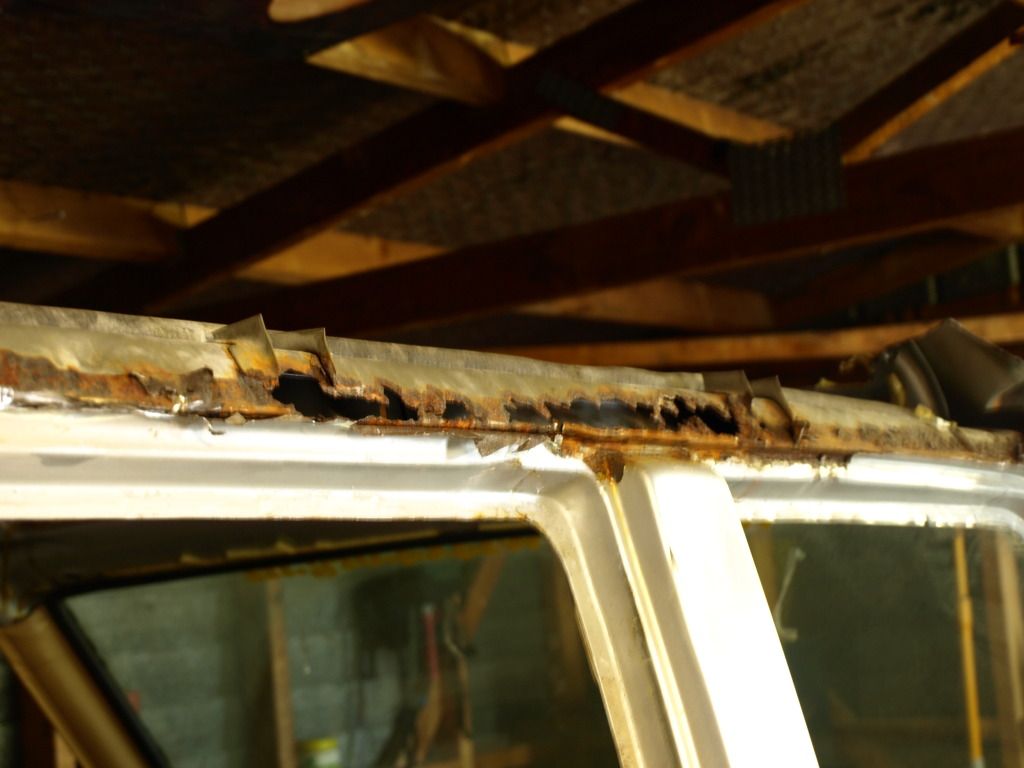

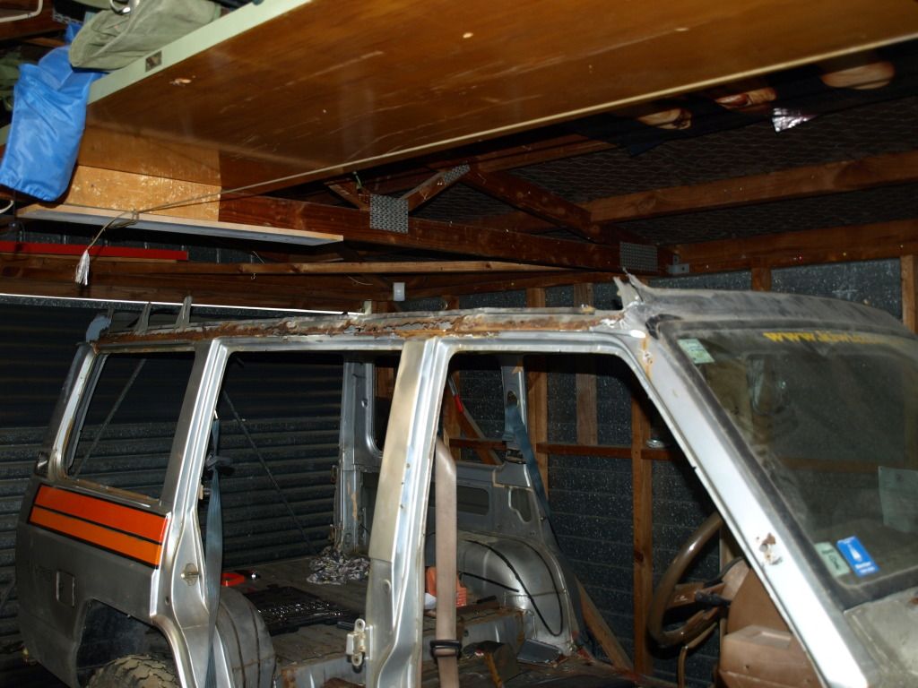

Obviously the 1st thing I was did was cut the roof off with a grinder
http://i1100.photobucket.com/albums/...u/00209427.jpg

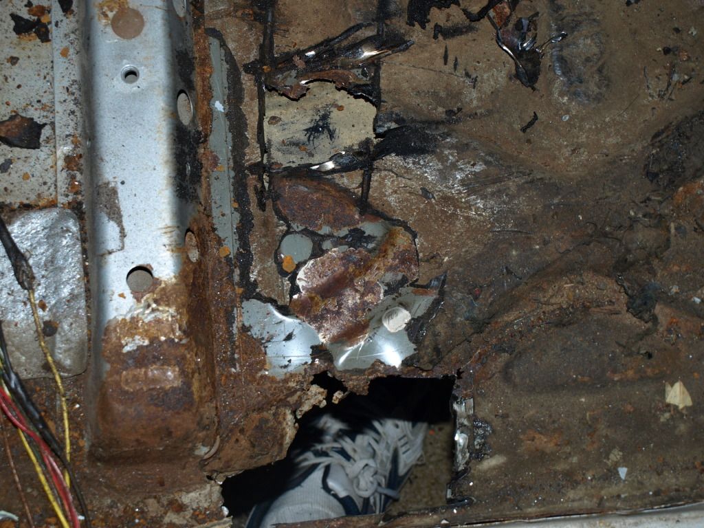

then i found the rust
http://i1100.photobucket.com/albums/...u/00209432.jpg
also in the drivers floor.
