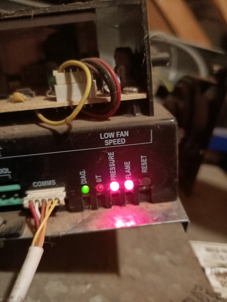

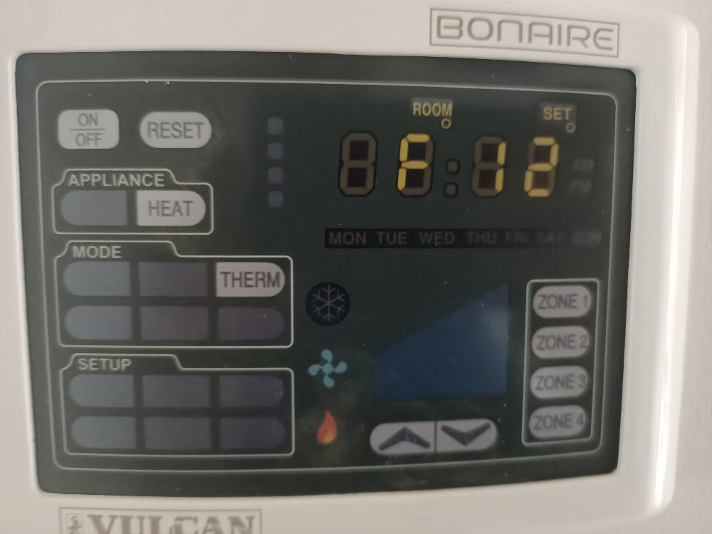

    So my vulcan Bonaire heater stopped working last night.
    Tried resetting from the control panel nothing. Tried resetting from the control box in the unit nothing. Cleaned out the return air fan, poked a bit of wire in the burners to clean out any carbon and wiped down the flame sensor still nothing.
    These are the codes I'm getting.
    Hc 01 is heating, but no idea what F12 is. My mate Google was no help here. Going by the led lights gas pressure and flame.
    I think this matches your unit?
    https://www.google.com/url?sa=t&sour...o8ME6AO34p5Nu_
    Pg 42 - F12 looks like a comms error. The pad can't detect the unit?
    You sir are brilliant. I couldn't couldn't find anything last night. At least I now know where to look.

    Funny thing is that I had the comm plug disconnected from the control box earlier today and it did nothing. This time I disconnected it from the control panel waited a little and plug it back in once it came back I had no heater option only cooler. Repeated a few times from both the control panel and a control box and also unplugged to Mains to the unit. Then success all back to normal.
