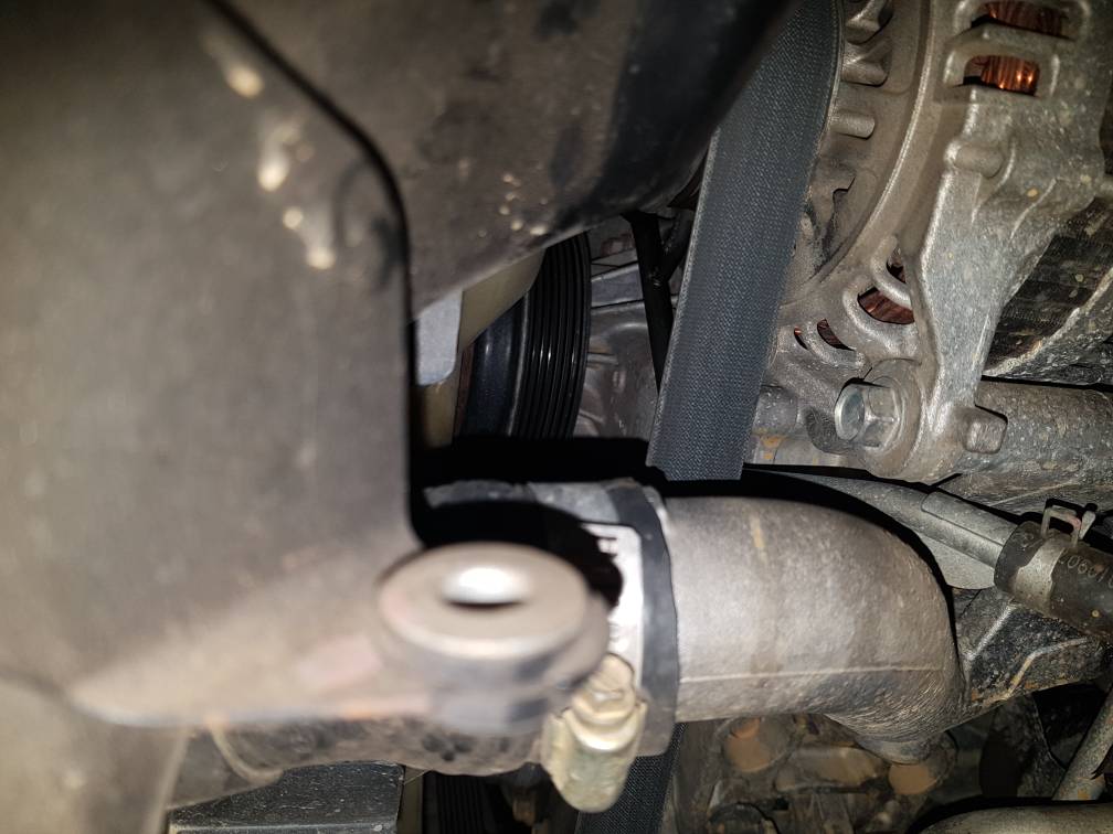

    @jack and @Bidja, ive opened the bonnet and going to put a little water on the tension belt and see if it changes the sound of the squeel.
    There appears to be 2 belts in the area, one flat and one more ridged.
    Which is tension pully?

    Info - Is your 07 ZD engine DI or CRD?
    Only one fan belt used (multi ribbed), it travels from the bottom then over to top side of the adjacent pulleys giving it the appearance of two belts (smooth and ribbed faces). Pic shows belt fitment: The tensioner (jockey pullley) applies pressure to the belt to retain belt tension. Note pic states Damper Unit (also called tensioner)
    Belt may be fine it is the bearing in the tensioner that could be causing squeal at start up.
    Mechanic thinking has exhaust leak sound, could be exhaust manifold gasket or related, this is why I asked you to describe again what you think it sounds like and the approx location. Have a read of post 9 again mate:
