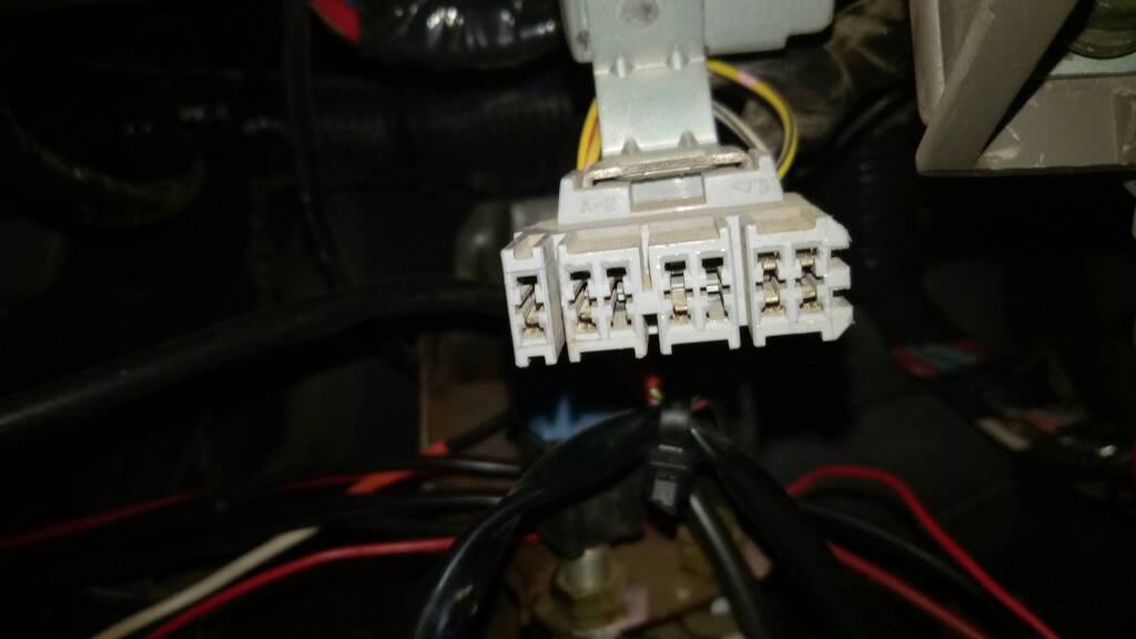

    OK and your using the same unit that I posted the pic of?
    Might need to find some time to travel up your way.
    Yes except the display is on the Laptop and not the Rectangle one shown

    OOI what shape is your dianostic port under the steering wheel
    see attached
    http://pinoutguide.com/CarElectronic...e_pinout.shtml

    Quote Originally Posted by Bob View Post
    Same.
    @Mike02Ti
    I had a look at the 02 sensor and it has two wires coming out of the plug, one goes to the gas system. Looks like it a similar set up as yours. I think I might be able to get my hands on a scan tool of some sort, just need to find out if it will connect to my plug.
    Edit
    No good with the scan tool. Only does odb2

    @jay see if you download NDS I for android or for windows you will be able to check out codes etc you should also be able to check out the readings from the o2 sensor as well. I have been using ndsII for a while for checking stuff and it's great to use. The android app will only read ECU . The windows version reads ECU and TCM
    Only thing you will need is a consult I plug either usb for windows or bluetooth for android.
    Maybe a member around you has one to borrow?
    Alternatively you can get an adapter from consult to obdii style as well

    I did try a while ago with a Bluetooth obd2 and adapter cable. Worked well on my wifes ve, but did nothing on the patrol.
    Will need to look at it again.
