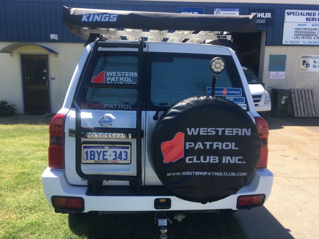

    Like the threedogs recovery point on the rear and the ladder.
    Here's mine from the rear.
