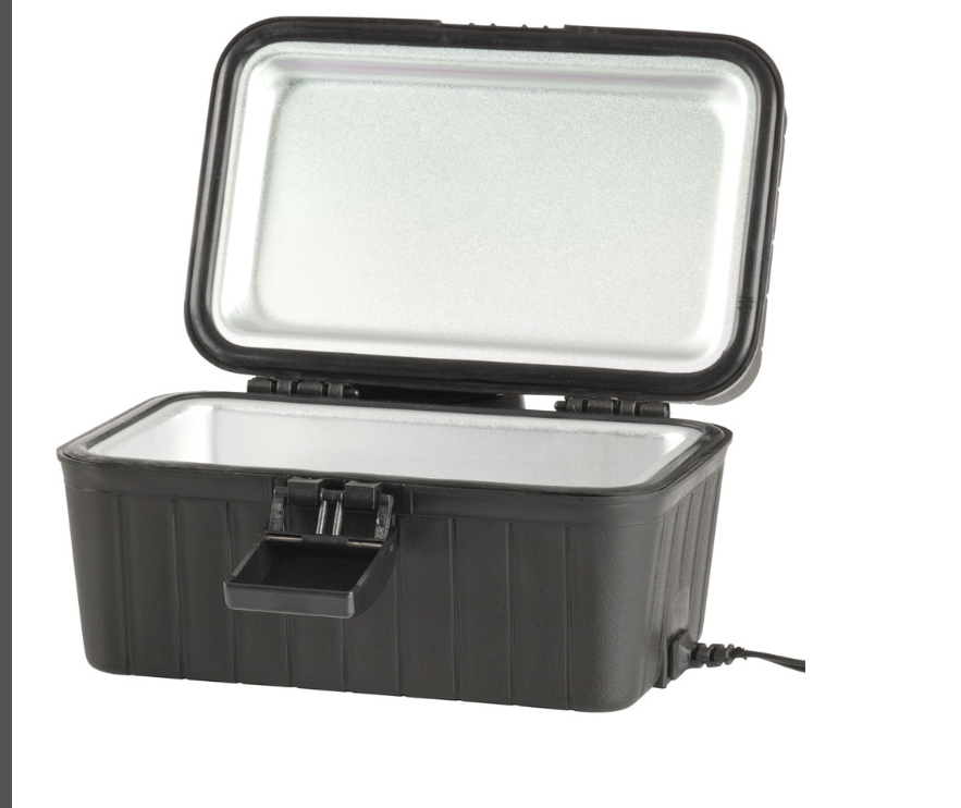

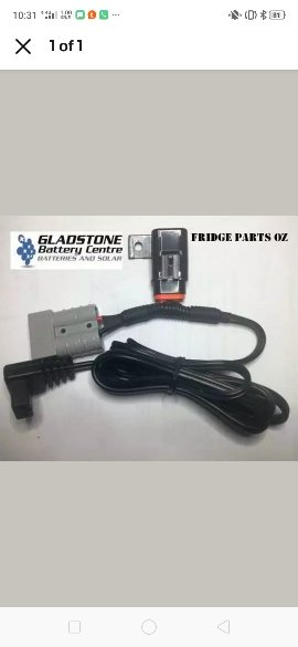

    What I'm trying to do is run a cable (size ?) from my fuse block with the other end to have a double Anderson plug. One will power the fridge (1st pic ) and the other one of those little 12v ovens (2nd pic). I will cut off the cig plug and replace it with a Anderson and have a inline fuse (10 amp). I believe that the oven draws 6 or 7 amps.
    So when both are on 11 amps would be the most if the fridge draws 3-4.
    Fuse block fuse will be 15 amp, what size cable ??? Length would be between 1.5 - 2 metres.

    I've got one of those ovens , they come with a 15 amp fuse , they draw around 13-15 amp for about 20 sec when first plugged in , and settle to around 6-7 after that , great little oven for the price .

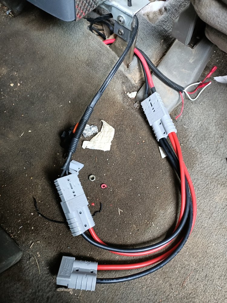

    All done.
    I did take everything on board and this is what it ended up with. Remember that I have my aux battery behind one of the rear draws and the fuse block just above that, bolted to the back of the cage.
    8 gauge wire + to the fuse block and - to the battery, other end Anderson plug this pops up under the fridge, Jaycar had a pre made piggyback which was cheaper than making one, so one end goes to the fridge and the other will get bolted to the handbrake cover for the oven. The oven itself now has 4 mm wire, 15 amp inline fuse and an Anderson plug. The fridge has 10 amp and the fuse block has a 15 amp. Little test and nothing blow up. The oven seemed to heat up much quicker. The real test will be once these restrictions are lifted and we get out and about again.
    Thanks for all the help.
    First time making up and Anderson plug wasn't difficult at all.
