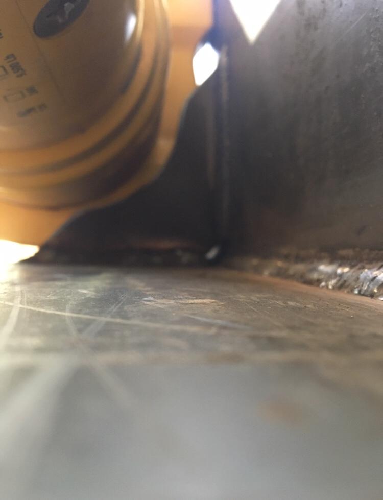

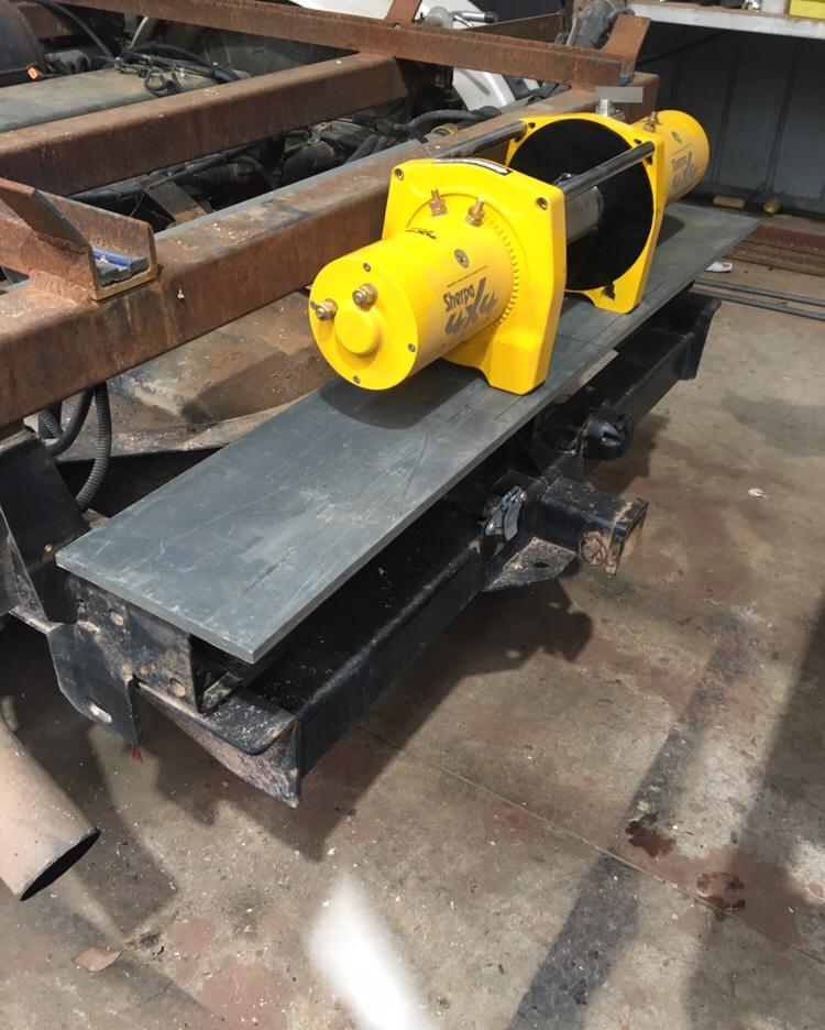

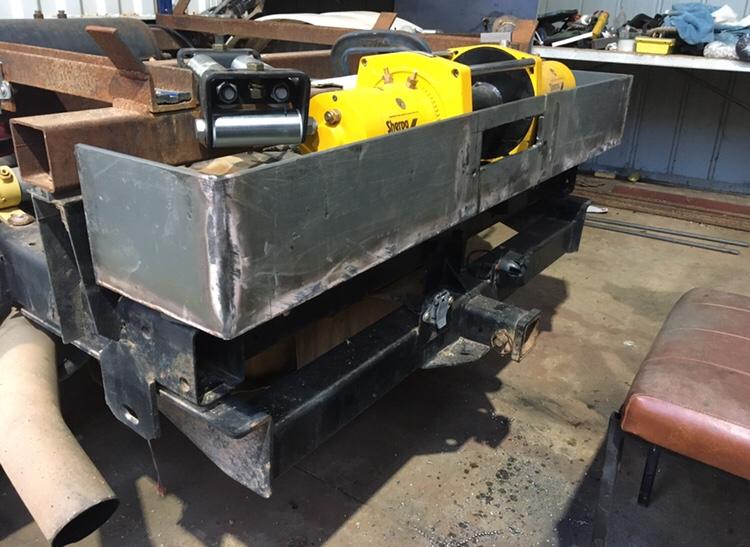

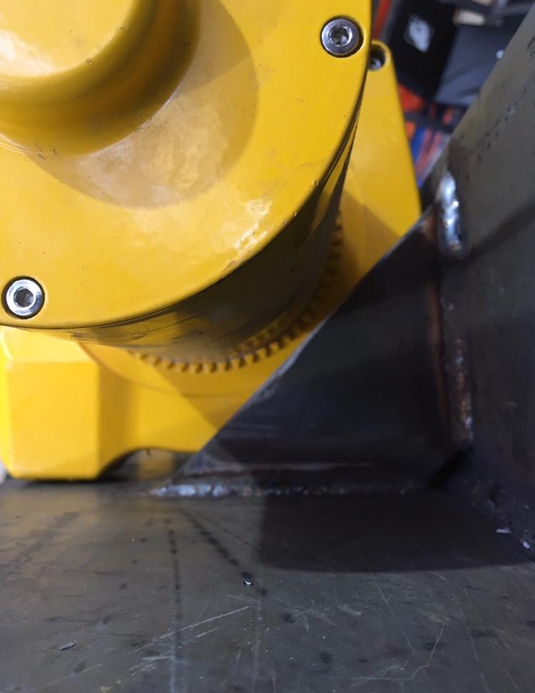

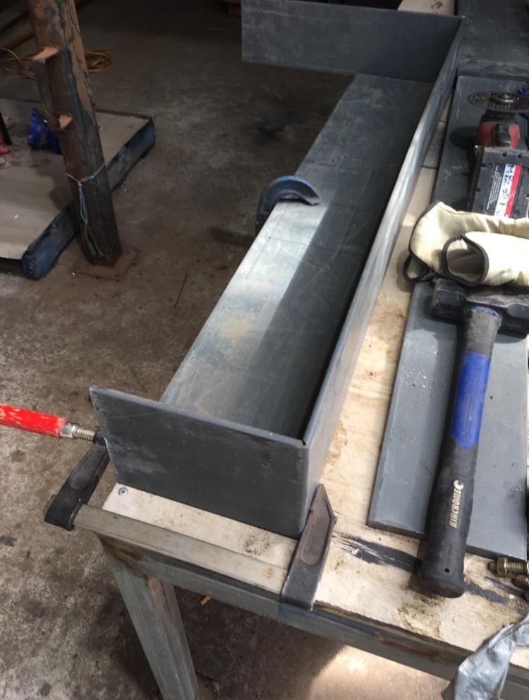

    Rear Winches - Lowering Down versus Hauling Dead Vehicles Up
    Have diverted slightly off your awesome plan thanks @PeeBee Mate, a lockdown shed day finally made an agricultural looking start finally:-)
    Forgot I had this 200mm x 12mm plate & another 150mm x 10mm tucked away down at the yard.

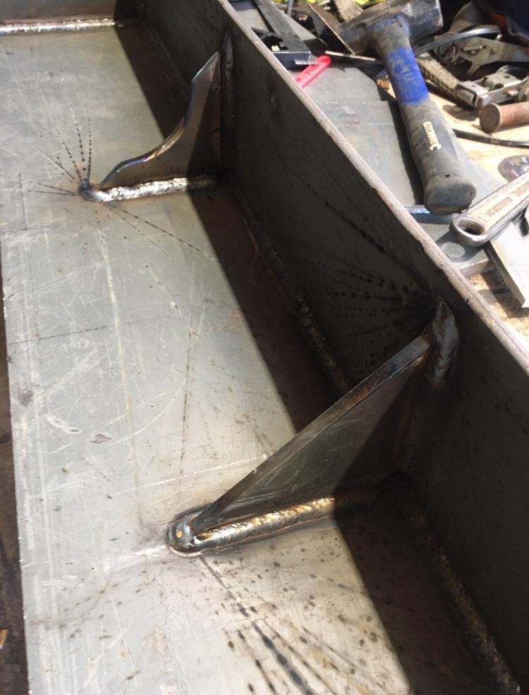

    Added a couple of bracey triangles either side of the spool, may need more along the plate although I’m thinking it’s only a fairlead plate as the winch is bolted down on the 12mm beast below.
    Unfortunately had to sculpt out one of the triangles as the gearbox on the twin Sherpa is a larger diameter than the secondary motor side.

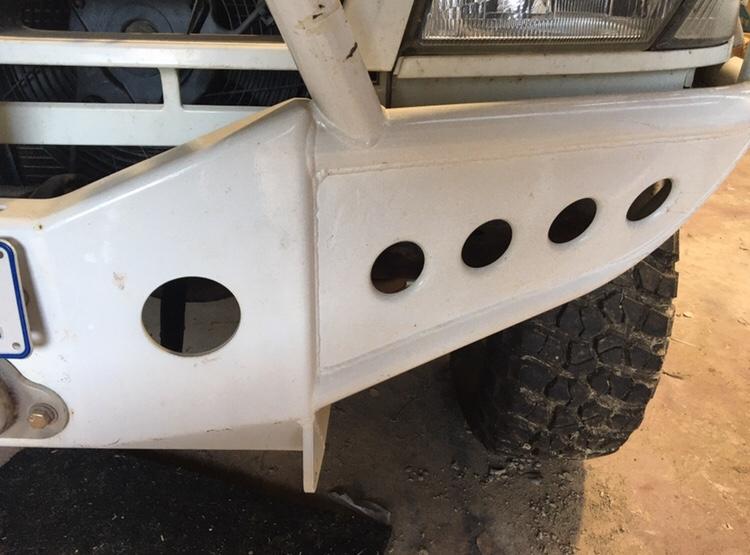

    Had enough for one day, next round will aim for the vertical “fish plates” to the chassis side holes & towbar below and a few speed holes for some sexyness to try and match her Millweld front
    Any do’s or dont’s for scrub truck safety before next round would be greatly appreciated please!!

    Far out Markie that is chunky certainly aint gonna fall apart anytime soon lol. . . Nice work looks smick, get the old girl go'n shes had long enough rest and the mountains are call'n, hopefully can get there soon. . .

    Looks good mark, top job. Don't overlook the load on the fairlead as it can be the primary reaction point of the pull. Adding the H/D fairlead assy will provide the support to a large degree

    Cheers Gentlemen, was actually waiting to get properly flamed, it is quite fairly heavy this wacky contraption :-)

    Fab up a local area deflector to push the air away from the alternator, as discussed a fair while ago. Whats in the way of the tank going straight up or even displaced slightly? Why 150mm lift, how big was the ding? What about a simple bash plate out of ally, say 6mm?
