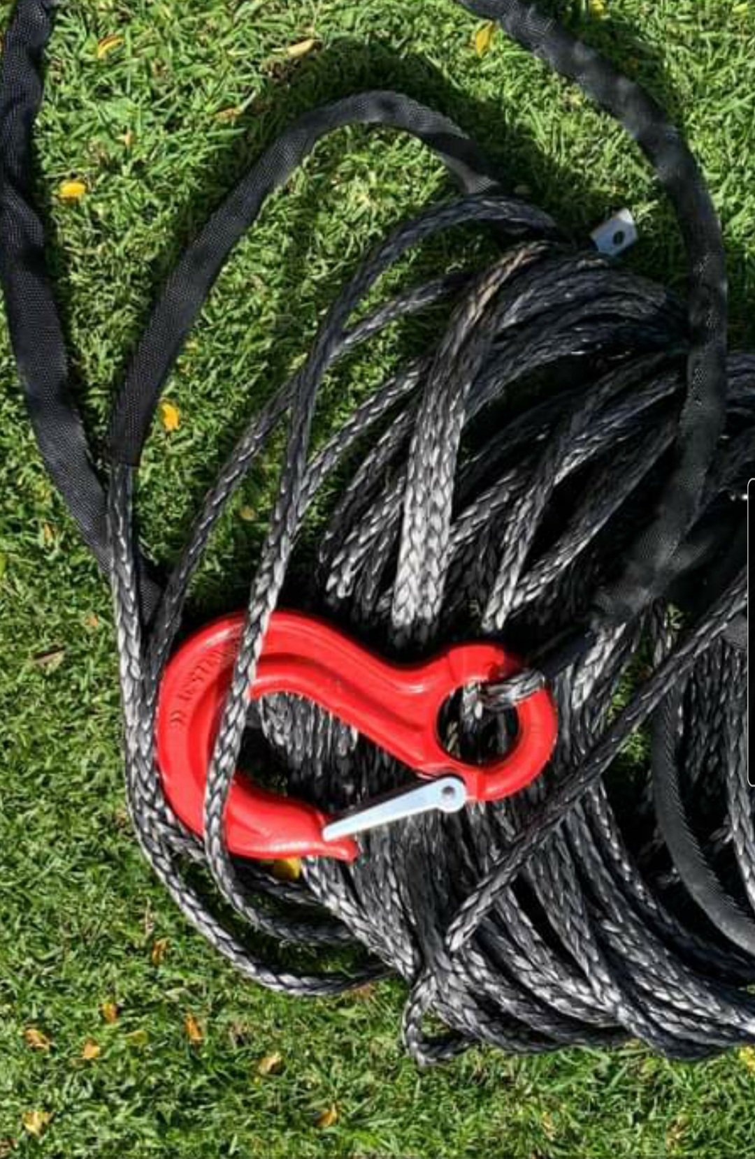

    Yo John, I brought a hook thats made with plasma/Dyneema in mind
    Of course its a TJM product rated and didnt break the bank. Those rope
    terminals make things neater, you can leave to hook off till its time to
    go 4x4ing.
    If youre going to hook the rope up under the patrol , can I suggest you
    put some split tubing over the exposed section. stops it being sand blasted
    while just driving around
    I used to run this hook. What i dont like about it is that i hvae to punch out the pin to remove the hook and then the rope has a steel thimble on it and your washing machine wont like it.
    Most comp guys have gone to this style of hook. This is what i have on my Himount.
    https://www.ebay.com.au/itm/5-3t-13m...t/302934214848
    It also wont get full of mud like the hinged type.

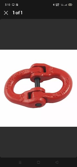

    I was going to use hammer lock. I've got the same hook bug rated 3.2.
