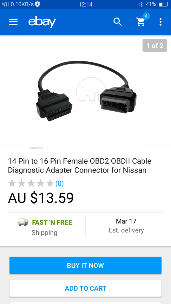

    OK I think I'm going to go with this.
    http://www.obdinnovations.com/nissan...stic-interface
    And the NDS1 for Android.
    Can't find the Bluetooth plug locally, this one is from the US.
    Mike where did you get yours from?

    My bluetooth plug is the OBDII ELM327 type from jaycar. Works well.
    Sucks you cant get one local for consult.
    But i have an advantage of mine having the OBDII port from factory and not the consult plug like yours.
    Im just wondering though if you could convert the consult plug to an obd style...... might need to check out the pinouts and see. I dont see any reason why this couldnt be achieved as basically thats what a consult to OBD adapter is.

    Oops I forgot about that.
    I've tried something like this with a obd2 elm327 and it didn't work. Something about protocol.
    Probably why people go with the PC/usb version.
