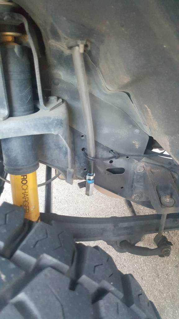

    Oil disposal isn't really an issue. Just drain the can at every oil change and dispose of the oil with the old sump oil. I have the hose with a ball valve running down and coming out in the inner front guard and its secured to the sway bar bracket on the chassis rail.

    Thanks for the comments. Seems the common solution here is hose and valve down the side.

    The extra work required to plumb it into the sump, you will need a non return valve too, its seriously not worth it. It takes minutes to turn the tap on and drain it when you do a service.

    It's a no brainer. My kit from Provent came with the hose and valve ... Simple.
    Drain every service. Easily accessible.
