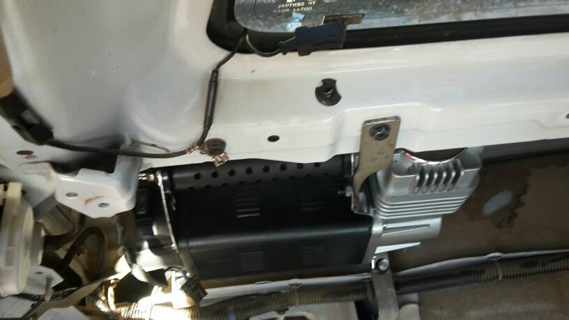

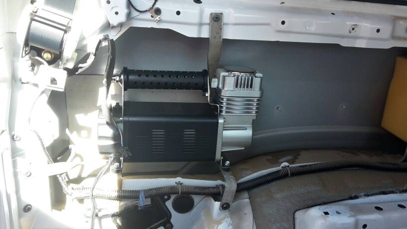

    There is plenty of room..
    I've just mounted my thumper compressor in there..

    i'm not keen on cutting out supports. with out bracing it. but those photos are very helpful. thanks

    Quote Originally Posted by garett View Post
    Nothing was cut mate..
    There was a couple of brackets for the rear ac but all bolt in..
    So no cutting anything..
    mines a gq and i'm pretty sure the bracing is welded. last time i had the trim off... rear a/c oooooh, nope i got none of that.
    Ow sorry mate yea mines a gu..
    If you remove the jack cradle that opens up a bit of room. Maybe a small 70-100ah battery in there..
    The gq does come in a long way above the wheel arch and doesn't leave much depth in the pannel..
