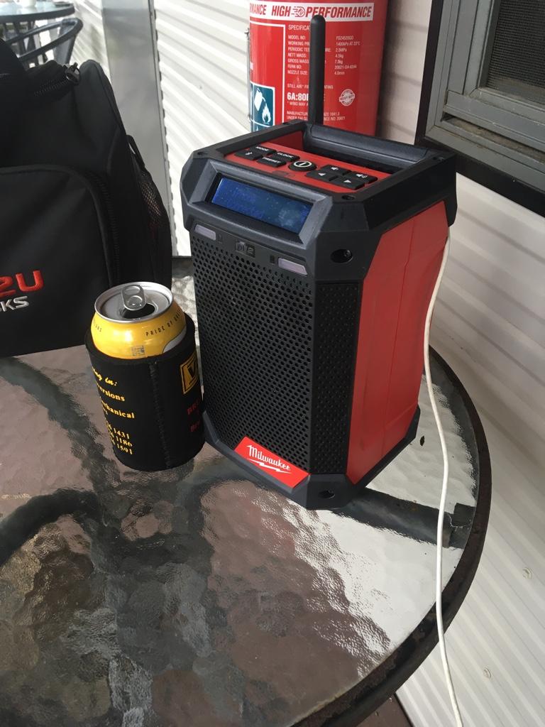

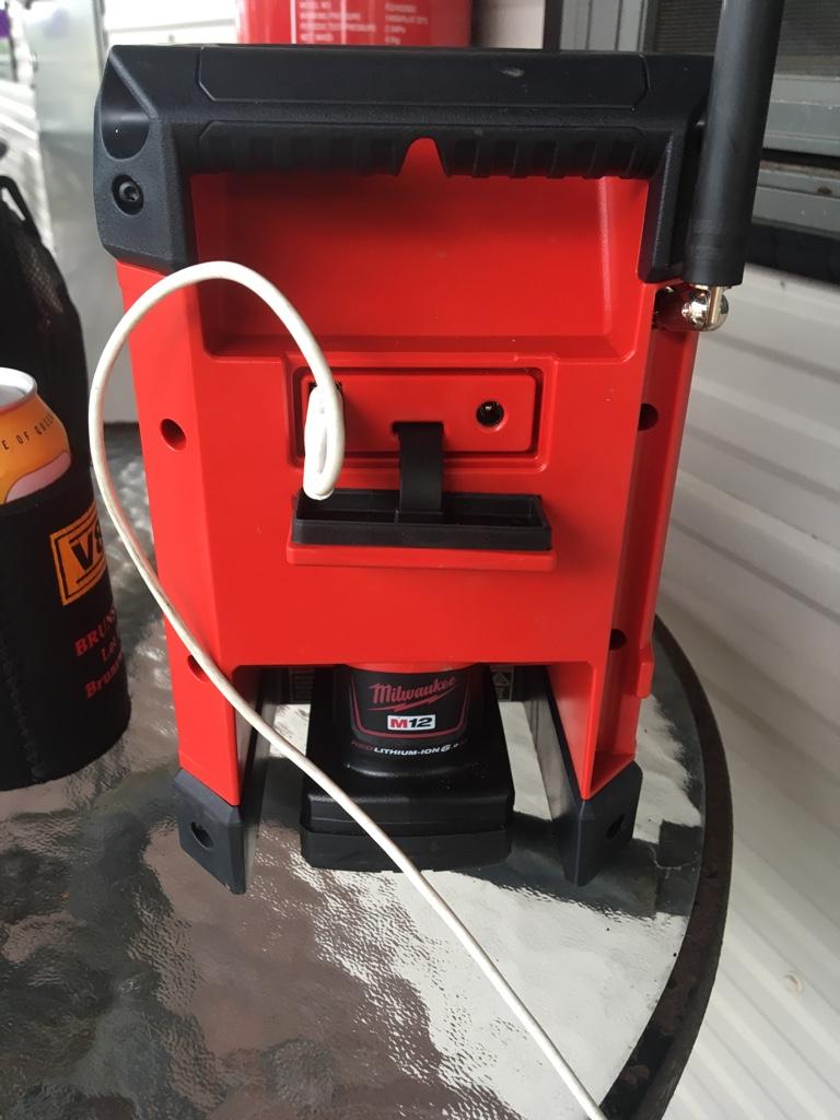

    Not really a Tool as such but splashed out and bought a third little M12 battery powered Milwaukee item for my slow growing collection.
    Caravan park permanents might complain to Management about the Tool in Donga #1 blasting Daddy Cool soon though
    Milwaukee make brilliant sound systems mate. Very nice

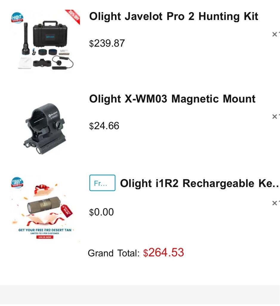

    I guess you can classify a torch as a tool.
    Olight have their winter sale on till Thursday 21st….some good bargains there
    Just bought a Jevelot Pro 2 hunting kit. This torch rocks
    If you become a member you get a $15 voucher by spinning their prize wheel, plus there’s other prizes to suck you in

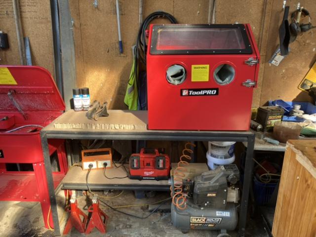

    Our SCA parts washer wasn’t cutting the mustard off for my rebuild, lashed out on a cheapo SCA Toolpro sandblaster, works good enough for my current needs, maybe a bigger volume compressor would be nice though

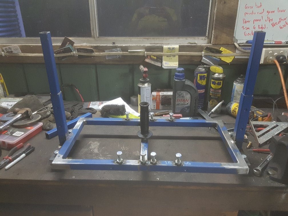

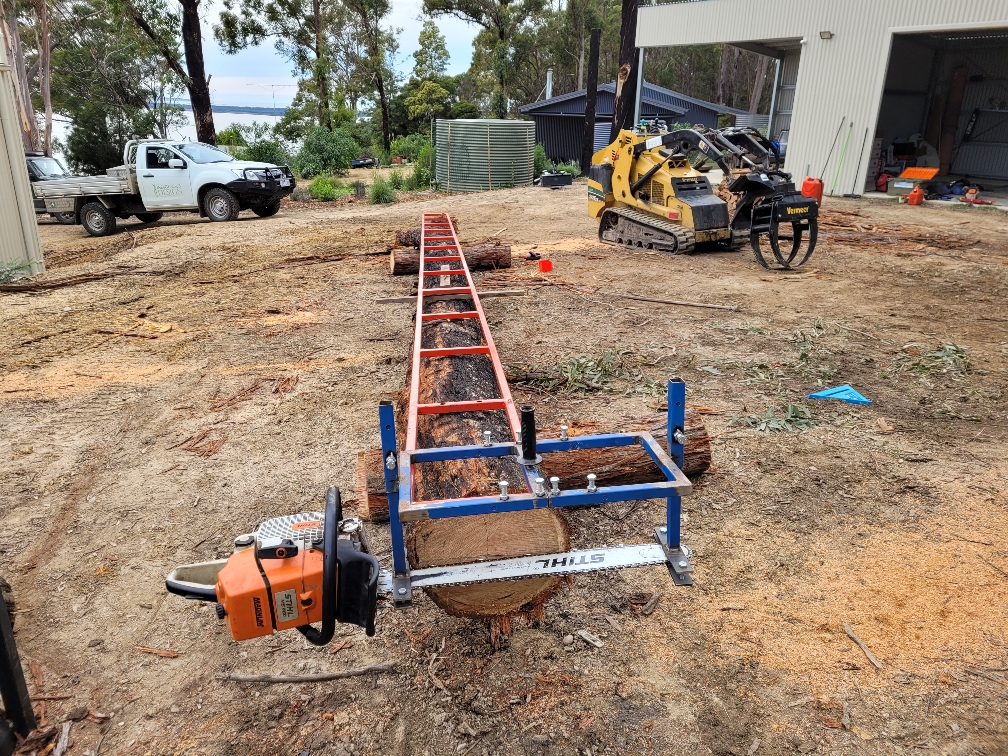

    Nice one John, I made a home made Alaskan jobbie to suit 30" and upwards and works well as long as you've got plenty of time and a bit of muscle to slog your way through. . With a 30" bar cranked the oiler right up but any bigger will need some extra lube as discussed. . Also as discussed skip tooth and 10 degree chain and make sure bar is dressed really well if not will wander and be a real PITA. . Have been an offsider on a Lucusmill a few times and they are an awesome bit of kit bit priced accordingly. .

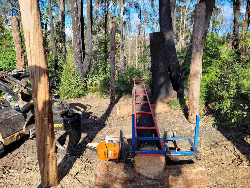

    Alaskan style are petty cheap on ebay or Jono & Jono but here's a few pics of home made jobbie. .
    Also made made some first cut rails but can use a ladder or timbers would work as well. .

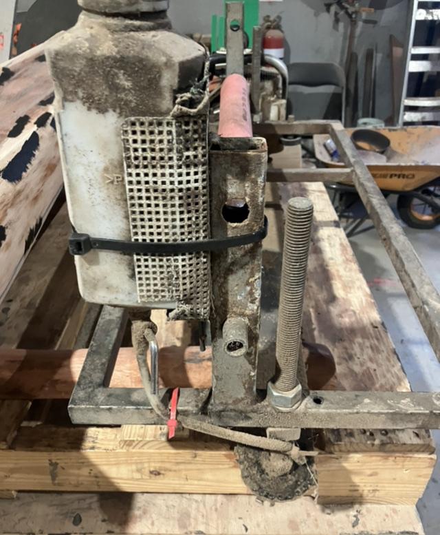

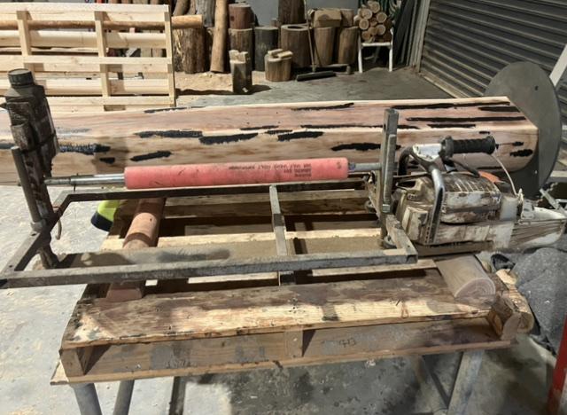

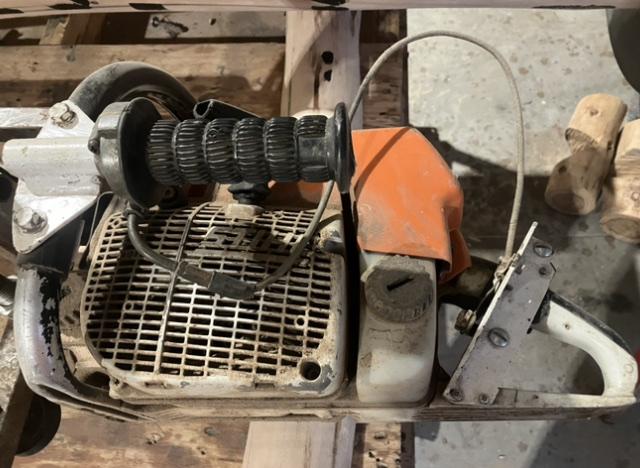

    Here’s our dusty old 660 Alaskan:
    This is the secondary oiler/lubricant gravity fed bottle on the end:
    Problem we found with using bar oil 100% on the gravity feed was getting constant regulated flow.
    Many Youtubey videos from USA recommended a 50/50 bar oil / diesel mix but this stains the timber deeply and costs a lot of money in oil/diesel.
    We changed to detergent/water mix tests and found it to be cheap and more effective in cleaning sap during cutting too.
    Hand throttle is a great addition:

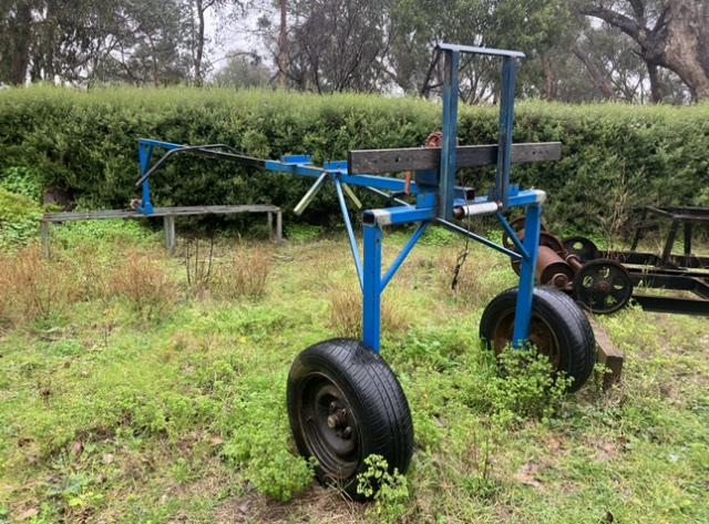

    You’re welcome to borrow our little snig trailer anytime for hauling the long logs back to your shed for block & tackle hoisting up to a decent working platform height:
    Vicky will also need to follow behind you whilst cutting with wedges to keep the weight off your bar
