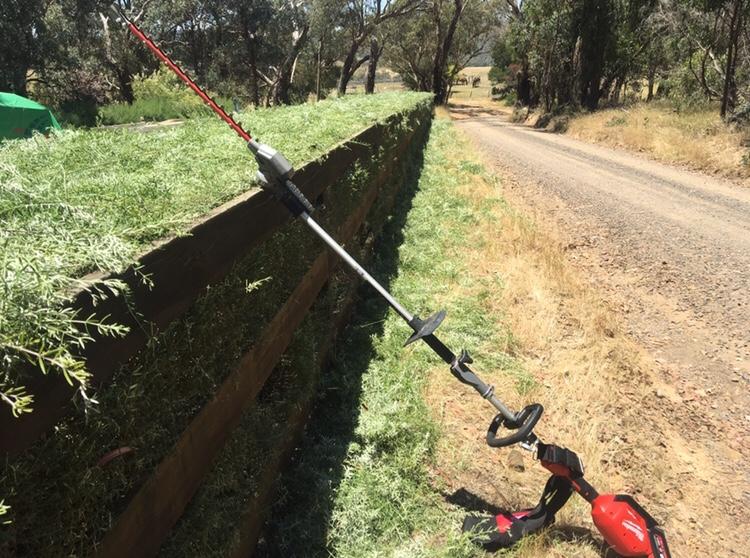

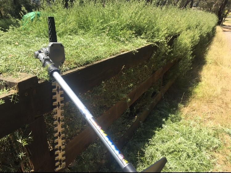

    Couldn’t help myself, had to borrow the girls 18v whipper snipper with the newly acquired add on hedge trimmer attachment, amazing contraption
    Smashed out the front hedge, all three sides approximately 30m long only using 25% of a 12.0AH battery
    So much faster than scissors

    I so need this at home. The neighbors hedge trees are towering over next to the pool and I can’t reach the upper sections. Wonder if I can get this attachment for my whipper snippet.

    You’re most welcome to come and take it for a try before you buy Mr Mark Mate! They also had a third extension shaft for sale too along with pole saws and edge cutter grass contraptions as well. I’d say this hedge trimmer attachment would max out at about 8-10mm thick woody “trees” though as it took a bit of encouragement on the ends where I hacked it right back a bit too deep.

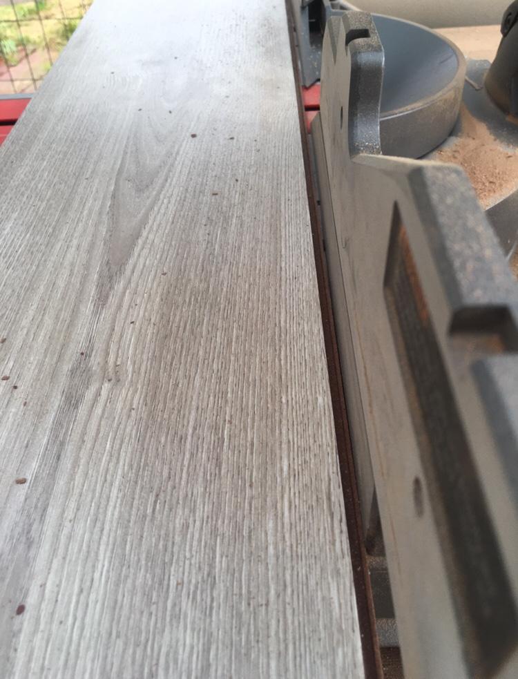

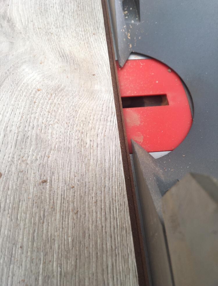

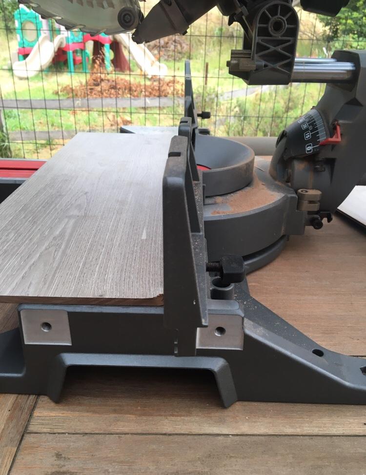

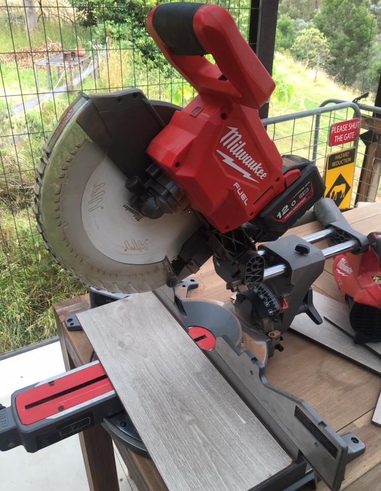

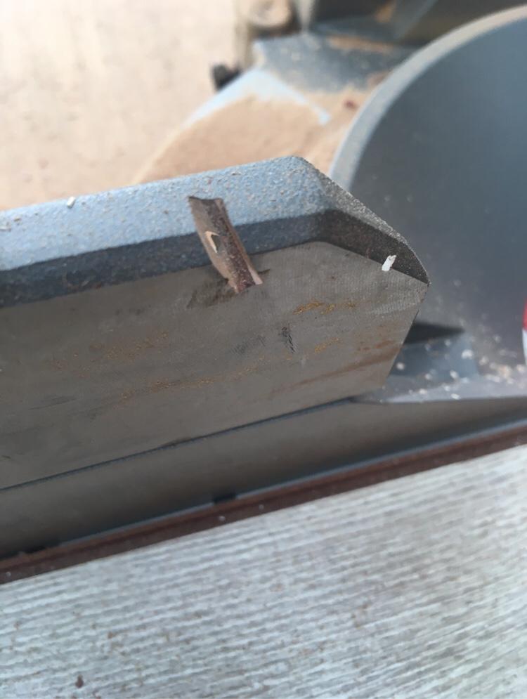

    Brought home the boys work saw beast for a quick renovation project in their absence:
    Why the fark is this beautiful spoilt tool giving me kickback I questioned instantly:
    Gates completely farked, heads need to roll I tells ya’ll
    Mitre boxes and blunt handsaws 🪚 welcome back boys 2021

    Well that is shit mate, s that fence 1 piece or Two? Surely it is 2 and it can me realigned? if it is 1 then how did this happen? If you need to use this and cant adjsut t to realign it then ut another fence on the front of it and pack it our mate. Re-fence it in a single piece with packers then cut the fence with the blade and you will get the job done no worries.

    Hahaha, i looked a these pics the other day on the phone and couldnt really make out the significance of it. on the big screen it is clearer though. That is sik mate. I bet it looks smashing now!!

    As ‘The Count’ would say #3 Pieces Mate!
    Looks like an older/weaker TD42 variant after 25psi has been shoved through it
  13. #658
    That's a bugger mate, it is a fantastic saw. Hopefully not too late to fix her up.
    Gotta agree... def don't want a great tool like that becoming an ... wait for it....waaaait for it... eye sore.
