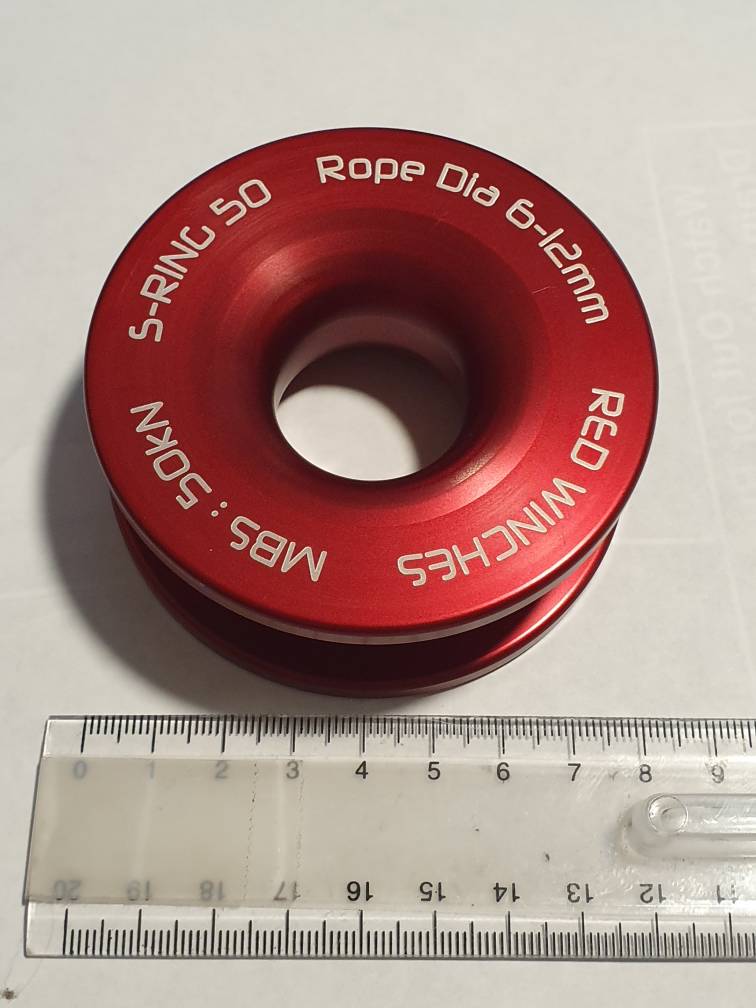

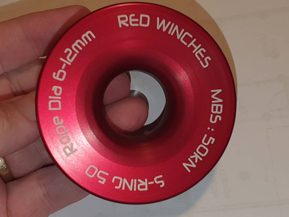

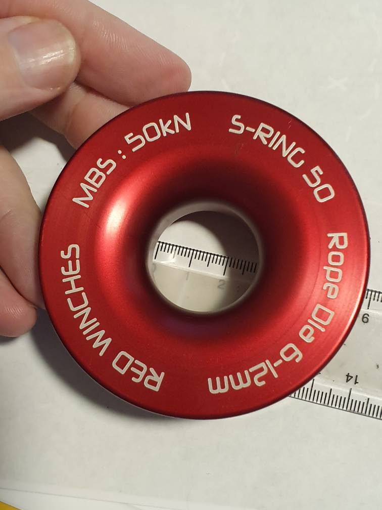

    So just received this on the mail today. Looks pretty sweet actually. It's smaller than the other pics. This is the 5 ton unit which is a higher rating than the ARB snatch block.
    Keen to see the bigger one but this is a rippa.
    The slot is rated for up to 12mm but is a 20mm groove.
    The centre is about 30mm. Will be interested to see how the 12mm soft shackle fits through the hole.???
    The outer diameter is 80mm and the inner rolling diameter for the outer rope is 40mm.
    Thanks a heap to @10G for sorting this. Can't wait to have a play.

    I'm keen to see how you get on with it Darren. Gee it does look small. One thing I'll be interested to hear about is if it's difficult to use coz of its size?
    Things like, is it too small to handle? Does it get lost in the recovery bag? do the ropes slip off it too easily and so on.
