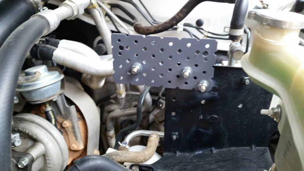

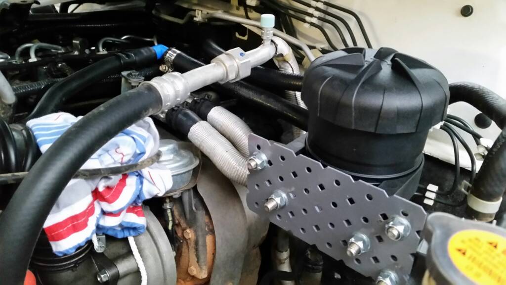

    Heres some pics of where i installed mine. was a tight fit due to the abs module and vacume pipes.
    I got my a bunch of "make your own bracket" sheets from bunnings. They come in a bunch of sizes. I worked out i needed 3 sheets to attach and offset on the black bracket holding the vacume pipes, which actually brought it closer to black bracket to clear the abs moudule piping. See photos for some ideas..
    Had to put a little twist to move vacume pipe to one side, but all fitted in nicely.
    Take some time dry fitting to make sure it clears everything and you will have no dramas...

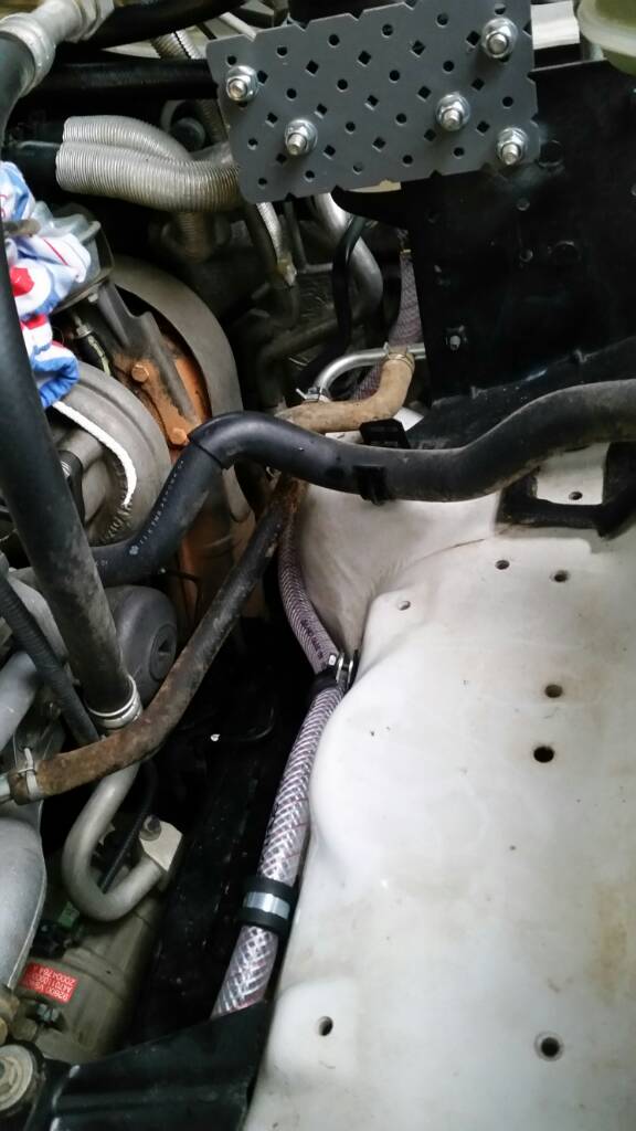

    Also fitted a bit of clear to drain with tap on end and routed using some cushioned clamps.
